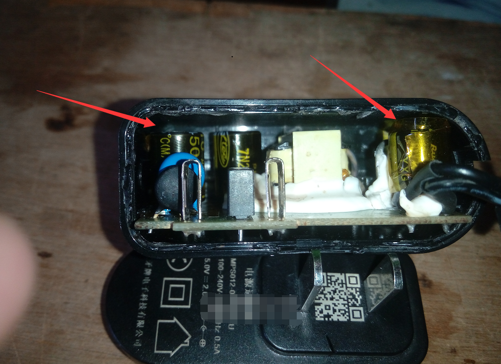

Hallo  everyone
I checked a 5V 2A power adapter and found that the 400V 10uf aluminum electrolytic capacitor was damaged.
I replaced it with a 450v 10uf electrolytic capacitor, and I used heat-resistant tape to isolate the high heat conduction. Can this operation extend the life of the electrolytic capacitor?
I plan to use this power adapter to power the fiber optic transceiver, which is powered on 24 hours a day.
I want to minimize the possibility of it failing. Are there any other improvements or enhancements that need to be made?
Because if the power supply of the fiber optic transceiver is interrupted, the network will be directly interrupted. I don’t want this to happen.

How about do nothing? It's a decent quality PSU, nothing wrong with its design. Why in hell did you replace polymer capacitor with electrolytic? It's a downgrade, not improvement.
:palm:, to say the least.

Agree that replacing the output capacitor is probably a bad idea. Even if you increased the voltage rating and capacitance, the ESR is probably much higher than the original cap. Was there any evidence of damage on that capacitor?
The kapton tape does nothing for you. A screen door on a submarine, as they say.
It's possible the input caps failed due to surges on the mains. Plugging the supply into a surge protector is probably worth a try.

Replace it with a 5V 4A PSU - under-running PSUs to keep them cool is the best way to improve reliability

It looks like the primary caps failed from a combination of heat and the input voltage possibly being near the upper limit.

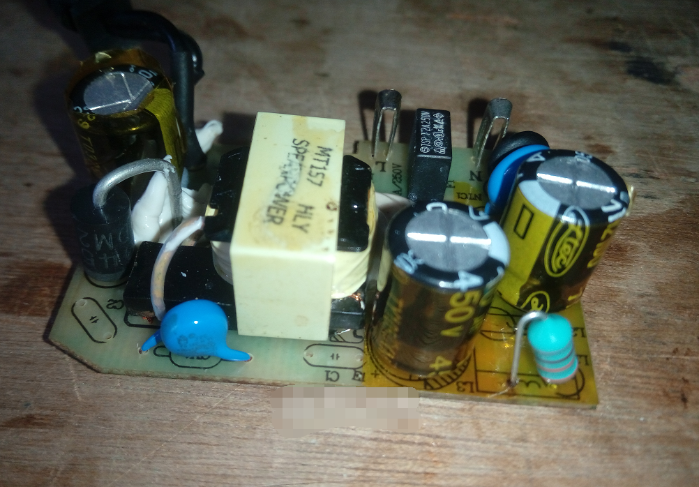

The original capacitors were 400v6.8uf and 400v10uf. I replaced them with 450v10uf capacitors. I don't know how long they can last.

What current does your transceiver draw? It seems likely either that you are chasing a non-problem or else add a small fan or simply uprate the power supply so it runs cooler, as already suggested.

This is the first time I have done this operation, and I am not sure whether this operation will really improve the durability of the capacitor.
This is my first attempt, and I have never seen others do such a modification, so I did it with a try mentality.
The actual current consumed by the transceiver is about 250ma.
This power supply is too small to add a fan inside. If a hole is opened, it can indeed improve the heat dissipation, but at the same time it is completely non-waterproof, so it is difficult for me to adopt such a solution.
The power supply shell is marked with 5V 2A, but as you know, this type of power supply is very common in China. Who knows if it can really reach 2A or if it is a trick? There is no model mark on the main control chip.

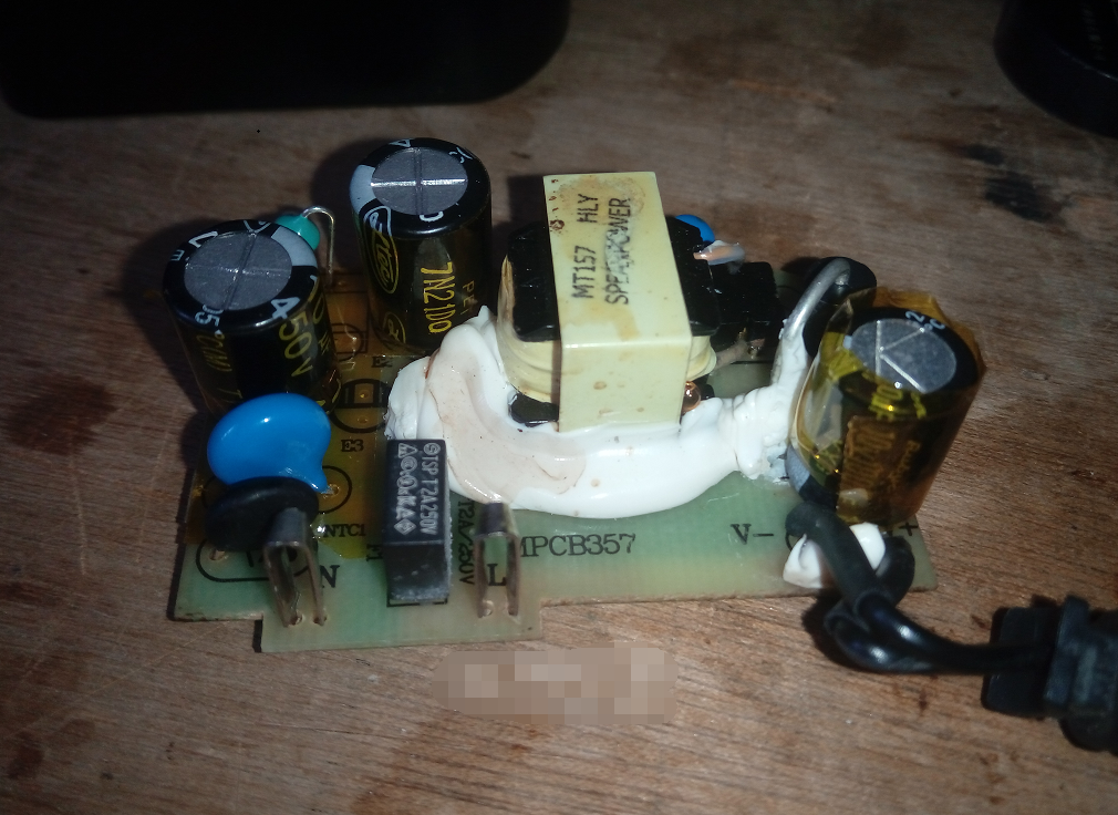

I sometimes do cap replacements on working things to improve reliability.
It's normally just because I want to know the cap is a known genuine brand and I have doubts about it. (Usually Aliexpress things that i want to run 24/7).
I also make sure it's using a cap with a nice high operating temp. Since heat is usually what kills them.
Obviously you have to match up ESR/voltage/capacitance.

You dont have any room in that case for any fan or extra heatsinking.
So do you have a thermal camera you can have a quick check to see what the temps are like while its out of the case and on 250ma load?
Not a great thermal test but better than nothing.
If all ok, then you also have no room to increase the mains transient transient withstand either.
So a jack way to do this is to connect some bigger offline power supply to the same mains lead nearby...you will then find that the bigger input cap bank of that PSU actually
will quench mains transients to a certain degree. Hopefully  it may also have a MOV inside it which will quench  any transients.
Of course, try and pick one without an inrush-relay/resistor because you really just want the cap bank to be right there and available to quench any mains transients.
Of course it may have a bigger mov than your little PSU, which will be handy.
Or buy a littelfuse TMOV module and put that on the mains.
