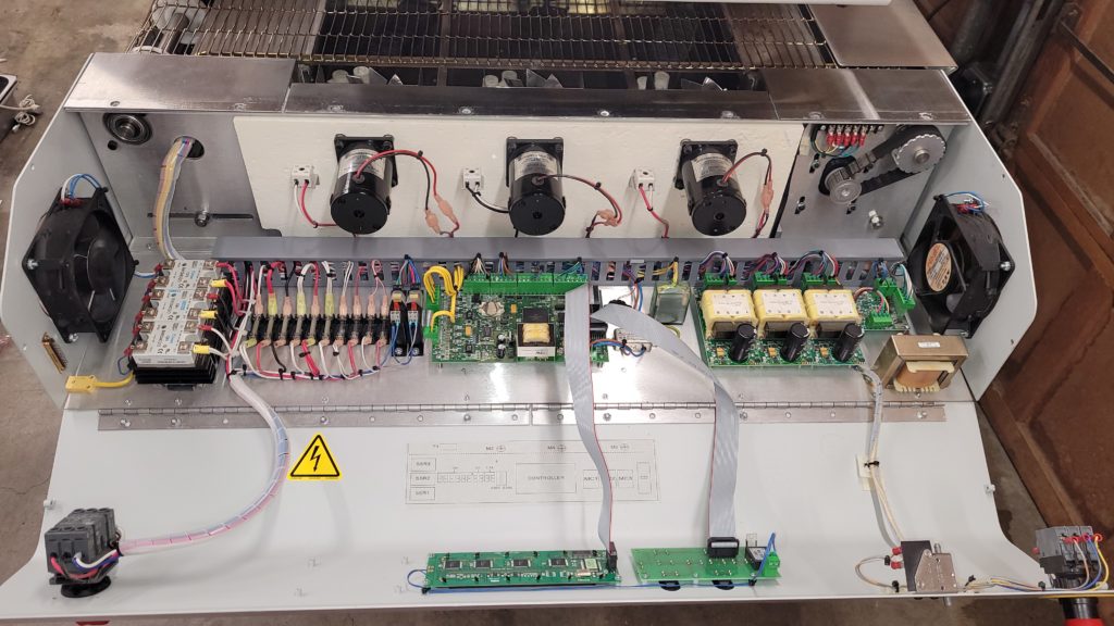

I got one of these GF-12's for the shop..
Detailed Photos of the Guts are On My Blog if anyone is Interested.
http://www.stevenrhine.com/?p=14183

Your machine, while externally similar to mine is significantly changed.
The controller is changed. It is based on a 6800 microprocessor where as in my machine it is based on a Zilog micro.
I also note the location of conveyor motor is from the front side of the machine whereas in my machine it is accessible from the rear side of the machine.
There are two cooling fans, I had to install the second fan after experiencing some overheating issues.
I also experienced problems with the thermocouples which enter the tunnel from the top side unlike Yours which has thermocouples on the side of the chamber.
When the thermocouples through use become contaminated with soot and garbage they become leaky which in my machine produces an interaction between thermocouple circuit and conveyor speed control circuit.
The other difference is the content of the display when operating under different options.
Come to think of it looks like the side entry wiring is power to the heaters not thermocouples. In my machine power to the heating elements is applied from the rear of the tunnel.
I have also had to take care of the two brass rails running the length of the tunnel providing support for the edges of the conveyor. They were a bit bumpy.. worn out.
Battery gets worn out... keep the machine plugged in every now and then so that the battery does not keel over.
As far as the key codes are concerned there is no universal set of codes that operate all machines.
Your machine may have  a subset of all possibilities and your codes may not work with other machines.
