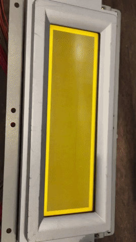

Okay, so I got a bench power supply to eliminate any possible issues from that board. Connected the rails as marked and now the screen turns on but it does not start up- all I get is a bar that moves across the screen once and then nothing.
Did I completely screw this one up? Is there any hope?
