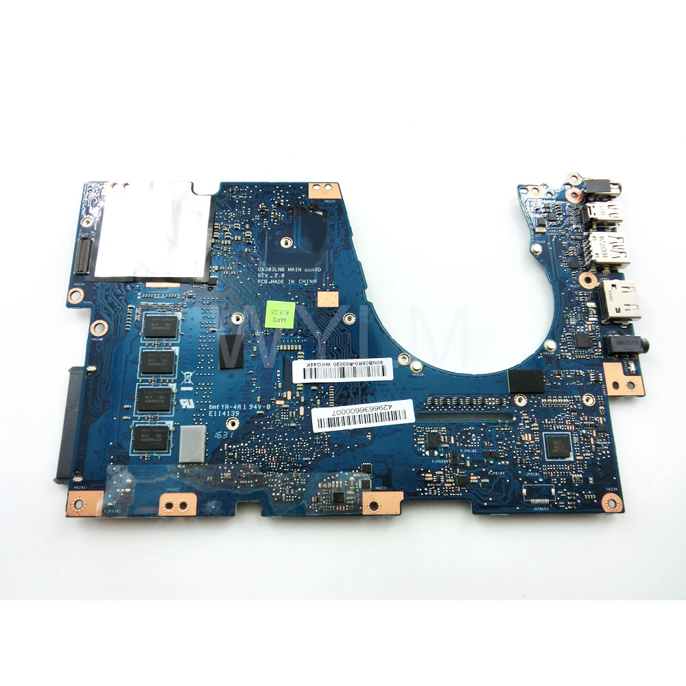

no such thing on this laptop, or any computer for over 10 years now
USB controller, and battery charger. And there is an unpopulated footprint of plausible size right next to the connector for the keyboard's flex cable -- but where is the keyboard controller?!
its the only chip with huge ITE on it, lower right corner when looking on the pcb from the top
https://ae01.alicdn.com/kf/HTB1F_NWG1SSBuNjy0Flq6zBpVXap/UX303LB-With-i5-5200-CPU-GT840M-2GB-VRAM-HD4400-4GB-RAM-mainboard-For-ASUS-UX303LB-UX303LN.jpg
boardview https://drive.google.com/file/d/1Ai9y0XaXoBqPOp0CchrBuKlR7h6pmiRI/view
https://drive.google.com/open?id=15I605RzlURiPgdNvJON5L2rycCKwesFz
https://drive.google.com/open?id=1JIq_oDYp_U22F0B8yaaK--knHih41aLD

I didnt see you trace or measure anything. reasons for fans to go crazy:
- computer loses ability to measure temperature, damaged thermal probe or its connection. For example long time ago Radeons had the tendency of blowing its thermal diodes resulting in working cards with no temp feedback and Fans blasting full speed.
- EC detects some other problem, hmmm maybe erroneous fan feedback?
- CPU asserts PROCHOT#? signaling its throttling, this signal goes to EC THRO_CPU# pin. There is also a connection to PWRLIMIT#_CPU and P_PL_IBAT_THROTTLE_10 suggesting it might be triggered when something is wrong with battery connection/charging?
- in the same vein NCT7717U https://www.nuvoton.com/resource-files/Nuvoton_NCT7717U_Datasheet_V111.pdf asserts ALERT# pin when it detects something weird, and afaik doesnt let go after things return to normal
- GPU has GPU_THERM#_L going to EC
- software problem
try if unplugging one of the fans triggers the problem
setup motherboard outside the case with external monitor and use hair dryer/hotair instead of cold spray. If you cant trigger crazy fans on demand then repair is impossible.
There is always the ghetto way of building ATtiny85 temperature controller driving fans PWM pins directly with two external temp sensors near CPU/GPU.

That's right, I have not really measured or traced anything. One reason being that I struggled to figure out where to start (thank you for the pointers!). But more importantly, I have not been able to "force" the problem in an opened system.
While I have not tried to plug things back together in a working configuration outside of the case (when I have everything apart this weekend), I have heated the PCB from below while the notebook's bottom lid was removed. I am sure that things got much warmer than in normal operation, with the case closed -- but never was able to trigger the issue.
I think a software (Windows) issue can be ruled out, since sometimes the fans run fast as soon as I switch on the notebook, i.e. under BIOS control. Bad sensor readings from the CPU or GPU can probably be excluded as well, since HWMonitor shows normal values. I can also rule out a charging-related cause, since the problem has occured with and without the power supply connected. I will try to follow your other hints - thank you!

I linked you boardfiles, trace fan connectors signals back to EC checking all the resistors in the way for damage/cracks/marginal solder. Same for the thermal readout lines between GPU/CPU/sensor chip and the EC. FAN_TACH_GPU/FAN0_TACH etc...
