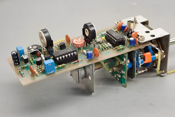

I recently managed to snag this analog gem at a flea market for a good price. ;)
2646649-0 (c) Gertjan  ;)
Unfortunately, the sensitivity of the Y amplifier is much lower than normal.
When I connect the 200 mVpp cal-square-signal  via a 10:1 probe, I only see a straight line on the screen (even with the switch in the 5 mV/div position).
Connected directly via a short piece of wire, I can at least see a peak-to-peak voltage of almost one Y grid unit on the screen, so slightly less than 5 mVpp.
I checked the cal signal with another oscilloscope and also checked the internal supply voltages - everything was fine.
When I switch to the component tester (CT), I see a horizontal line about 8 grid units long when the CT jacks are open.
When the CT jacks are shorted, I see a vertical line about 7 grid units long. So far, everything's fine.
So, the Y-final-stage from the CT switch onward is fine, and the problem must be in the Y-preamp or attenuator.
I've spent several hours trying to systematically measure and track the signal.
I also replaced the input JFET pair U440, the CA3046, and the uA733 with working parts (2x BF245 roughly selected, CA3086, LM733), unfortunately without success.
I then simulated the circuit in LT-Spice (using generic transistors) to determine the signal amplitudes at relevant points, and the simulation worked.
Compared to reality, however, the amplitudes from the last two attenuation stages onward are already significantly lower than simulated.
Therefore, I now need real-world comparison values ​​from a friendly HM103-1 or HM103-3 owner (the HM103-2 has a completely different circuit).

Please use my attached schematics, as the original had some incorrect pin numbering.
The red numbers I added to the PCB layout are the connection numbers of the attenuator section between the preamp and the intermediate amp.

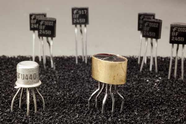

Do you know of a cheap replacement for the discontinued U440?
I don't want to spend more than the entire scope cost me at the flea market.
Perhaps there are suitable paired JFETs available as current SMDs or cheap leaded single JFETs that I can glue together?
Which parameters are important to match in this application?

They are reasonably wideband unity gain buffers, they need to be matched in a single package to maintain bias levels, whatever you choose you are going to have to adjust the current sources to get the bias level you require, even new U440 would need the currents adjusted because of the wide variation in Vgsoff from -1V to -6V.

Hi Greybeard,
I was a bit surprised to find one of my HM103 photos in your opening post :).
So I presume you saw my HM103 repair report on Circuits Online.
This topic is in unfortunately in Dutch, but with many photos.
Mine had multiple problems, mostly small ones, and mostly due to old age and a lot of usage. Good thing is that Hameg used standard components. So easy to replace.
I replaced the U440 with a pair of matched BF245B. One half of the U440 was still OK, and I looked for the best matching FET (in my stock) to this half U440.
Most important in matching the 2 replacement FETs is searching for the best match between both FETs (Id/Vds and Id/Vgs curves), for best DC stability. (more info in the Circuits Online topic)
With this matched BF245B pair I measured a pre-amp bandwidth of 60MHz, and DC stability was adequate. Should be fine for a 10MHz scope :).
However, the U440 is obsolete, but recently I found that it is for sale at the moment :).
I just bought 2 at Display Elektronica. Mine turned out to be real old stock Siliconics, from 1988 and 1991 :).
(Display is a shop that buys the stock of other shops that are closing down)
regards, Gertjan.

You caught me, I actually borrowed the photo from your website (please forgive me for that).
The photo was so good that I saved myself the trouble of photographing my device. The devices are otherwise identical.
Of course, I had already read your article "repair from hell" (Google translated, some parts are quite funny).
Your preamplifier also has this ominous 4.75kOhm resistor, which was subsequently mounted "in the air wiring."
At first, I assumed that a hobbyist had added it (my device still has some other tinkering traces from a previous owner), but since I've now seen the resistor in other pictures, it seems that Hameg shipped it that way after all.
Could you please do me a favor and measure the voltages at pins 1 and 14 of the uA733 (Y input = GND)?
I was curious and put my two U440s on the curve tracer, and surprisingly the "defective" one isn't defective at all - the curves are just quite shifted (aging, series variation...?).
(These are two different U440s. The individual pairs match perfectly)
If I compare my measurings to the Vishay datasheet...
... I come to the conclusion that both of my U440s are in spec!
I'm now wondering whether I can adapt the circuit to it.
I probably just need to replace a few resistors (but which ones?). R114/R115?

I do not quite understand your U440 measurement. The U440 is a matched pair of JFETs mounted in a single package.
So are the red and green measurements of one FET in two different U440's? Or are red and green the 2 FETs in one U440?
I found that a variation in gain / transconductance is not very critical. If you measured 2 U440's I would expect both of them to work. (presuming a good match between the FETs in the U440)
But the match between the 2 FET's in the U440 is important. So if red and green are the 2 FETs in one U440, then I would expect a big DC imbalance. (Maybe more than one can trim with VR101, Input Balance)
The pair in one U440 matches perfectly.
The pair in the other U440 also matches perfectly (but is shifted to the first U440).
Both U440s are in spec (see edit of my last post).
I tried to go your way and installed two (not particularly well-matched) BF245 (A instead of B) from my spare parts box into the device again.
The oscilloscope works, but correct symmetry adjustment is not possible, causing the line to move significantly vertically when changing the Y deflection factor.
I'll try to find better matching BF245s in my spare parts box.
Unfortunately the BF245 and its SMD successor, the BF545, have been discontinued, just like the U440.
Both U440s are in spec (see edit of my last post.

First thing I would check that nothing in the preamp has drifted out of spec. Also check for bad/loose solder joints. (my HM103 had many). One would assume that the circuit was designed to work with any U440, so maybe a resistor has drifted?
Then I would insert the U440 that works correct, and measure the voltage over R114 and R115. (Effectively measuring the current through the FET's). These should be equal.
Then insert the other U440, and measure U over R114 and 115 again. You should see the problem / difference... Adjust R114 and R115 for the same current as with the "good" U440.
From my notes: I measured -5,2V on top of both R114 and R115. (so 6,8V across = 2,48mA). Not sure though if this was already with the BF245B's...
Both pins are at -0,5VDC. No signal, and with any position of the input attenuator.
Thank you!
My values with the working U440:
+0.76V each.
Not very well-centered in the U440 specified input range of +/-1.0V, but I think the headroom of 0.24V / 5mV/div = 48 divs of possible deflection (while the screen is only 8 divs high) is enough.
So I will not try to correct.
I've still checked the attenuator and all connections of the Y-preamp, because of your excellent article "from hell".  ;)
Everything seems to be OK.

My solution:
I looked at the schematic of the donor device HM203-4:
The JFET input stage is build like a voltage devider with output at the center point, one JFET wired to +12V over two 332 Ohm resistors and the other JFET wired to -12V over the two other 332 Ohm resistors.
So, if one JFET drifts in one direction, the drift of the thermically coupled second JFET moves in the same direction, so the drift is compensated.
That compensation is also working for series production variation of the U440.
The pre-amp circuit is much simpler compared to the HM103 (no CA3046 needed at all) and works better!
I installed my "defective" U440 into the HM203, and after a small symmetry adjustment, the HM203 worked perfectly again.
I've measured the DC input voltages (pin 1+14) at the uA733: just a few millivolts for both channels.
So my solution is to simply swap the U440s of the HM103 and the HM203.
Nice and simple...  :-+
« Last Edit: September 11, 2025, 05:10:42 pm by Greybeard »
