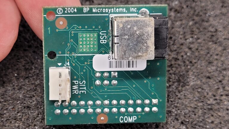

Difference between the 1600 and 1610 is memory is populated and has a USB to LPT Card. Based on a EZ-USB FX2LP Chip. I have a Backup of the eeprom I don't think it would be hard to reproduce a USB board.

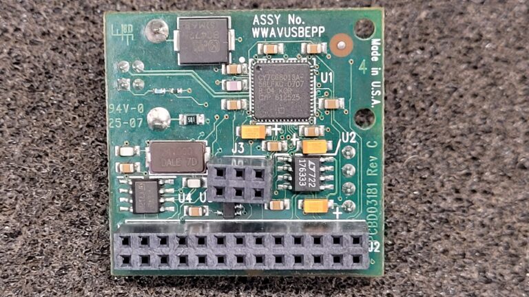

WWAVUSBEPP   eeprom file ... reconstructed from images, come from here :   https://www.stevenrhine.com/?p=133599
BPM  does not sell them anymore, or will supply them if they have some, putting  "obsolete" on many models having Lpt ports ....
the defunct archived usb2lpt project may / could  come to the rescue, version 1.7 is nearly identical,  compiled iic code and drivers still exists ...

what a nightmare to program thoses pesky fx2lp, you have to be careful on the mode you use to get the fw into the eeprom ...
so far   seems to work ... need time to finish ...
but interface does identify itself  once BPM  SW is installed  loll
without the drivers,  windows "tought"  of an Bk precision usb to ttl interface  loll

I might also try this project with your code to see if my BP1600 will become an 1610.
https://github.com/Blaster-HMX/WWAVUSBEPP

For the cypress tools you have to register for free at Infineon / Cypress   trying to get their tools,  unless you have them already
Cypress Suite USB 3.4.7 ----  the hard one to get loll
good luck   :-+
The only mod i would have done is:  to add pins headers or say 2 pins jumpers in serial for the SDA SCL control lines going to the eeprom
and a ground and the + voltage pins,  just open the data lines to be able to flash it with other cheap tools using Dupont  jumpers cables

Yes, it will work... Used the FX2 Dev Board on a few BPM programmer repairs already.
Please note my blog post https://www.stevenrhine.com/?p=133599
Original images that the info was reconstructed from. Sadly unable to release a complied binary but appears someone reconstructed it.

just to make 100% sure can you confirm that between 0x0EFF and 0x1EE0 there are only 0xFF characters ?  :)
All Area's with data are in the photos..

« Reply #11 on: February 20, 2026, 06:58:04 am »
the missing offsets ranges witch i post here
if not,  it does not get the right checksum, and an 8kb of file size,  it goes between  image 4 and 5  of Mr Rhines
witch sadly i had to argue about,   it is not complete,  for the non code guru like me, a matter of opinions, FF and 00  are data ....
FF FF  filled content  seems okay    HxD  and 010 editor    are okay with it ( the complete posted code  and checksum is ok )
up to the 1FC0 :    bytes 1FC6 1FC7   who has FF FF or 00 00   as explained  by Mr Rhines
Meanwhile,  I discovered  the FX3 sdk software for the FX3 Dev kit, they are way better to upload it into the fx2,   you already have the 64k aka "big memory"  option to send it to ...  no address changes,  the cycontrol does it all  for the 128k eeprom on the board ...
oh  by the way,    this board is called the geeetech variant with the reset near the usb plug, another variant exist, but pinout seems different and the reset button is at the opposite ?
More infos here : https://www.newioit.com.au/archives/159
you need the drivers  of BpWin    loll
re-upped the image  minus the mouse cursor  image  loll
