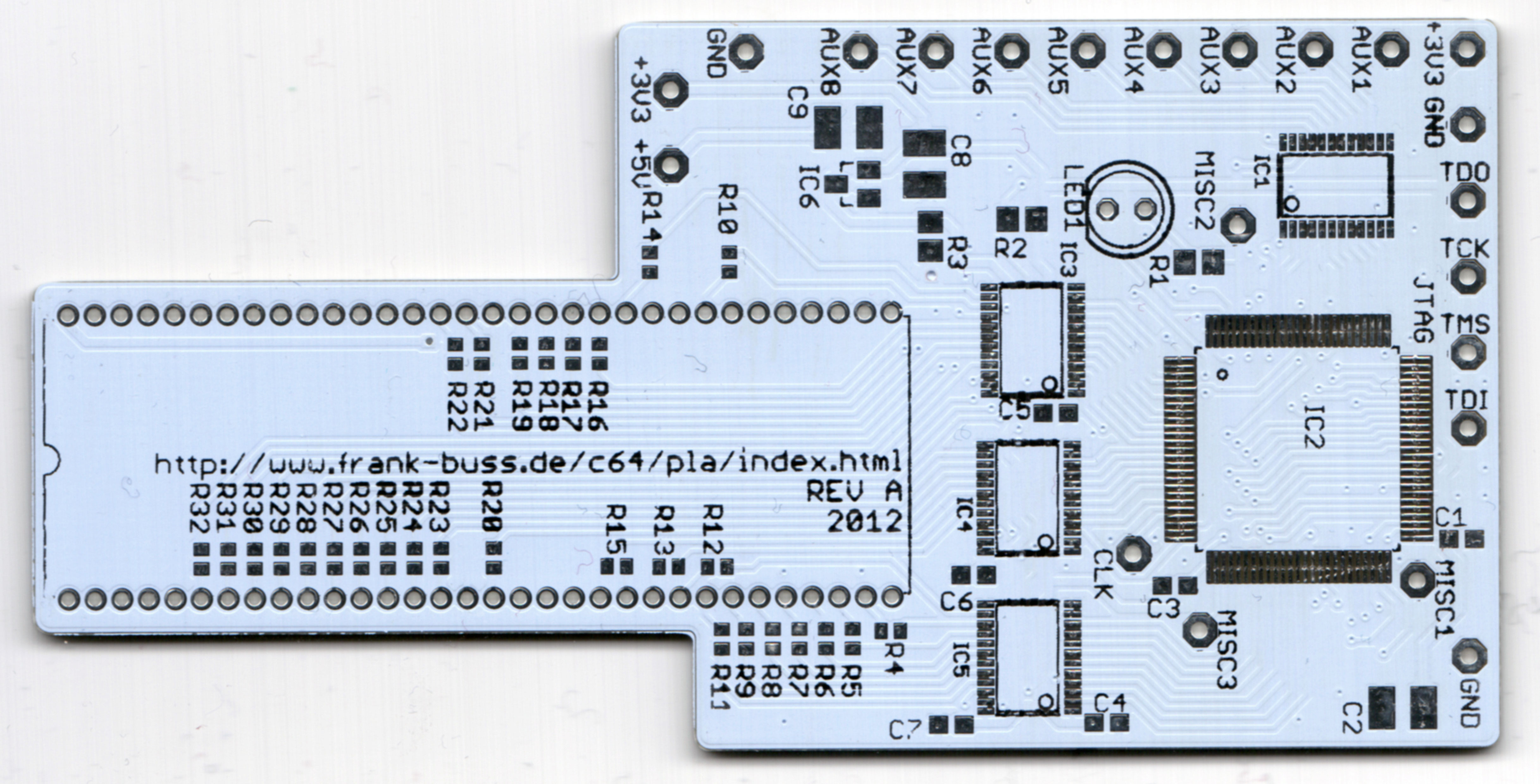

« Reply #12 on: June 23, 2013, 06:20:55 am »
I never had a problem with their service. This is one of my boards they made:
http://www.frank-buss.de/tmp/cartridge-pcb.jpg
Yes, the vias are a bit off center and there was a serial number, too, but I don't mind, the board worked.
Interestingly, there was no serial number on another board I ordered some months ago (I tried the fancy white silk screen). Here is a 1200 dpi scan:
http://www.frank-buss.de/tmp/pla-pcb-1200-dpi.jpg
The vias and holes were nearly perfect this time and the board worked without problems, too (at least without problems of the caused by the PCB process, I had to solder some really thin wires because of a design bug I made ::) ).
I guess I was expecting a nasty surprise anyway, since the specifications that they do publish are so poorly specified that I had already spent a good while trying to find things. Still don't know what their silkscreen resolution and registration are...
Besides the silkscreen specification, what do you miss? Looks good for me, they specify anything I want to know, like conductor width and space. They even have a Eagle "rules" file, which makes it very easy for me, because I'm using Eagle. BTW: at least they specify silkscreen line width (min 6 mil).
