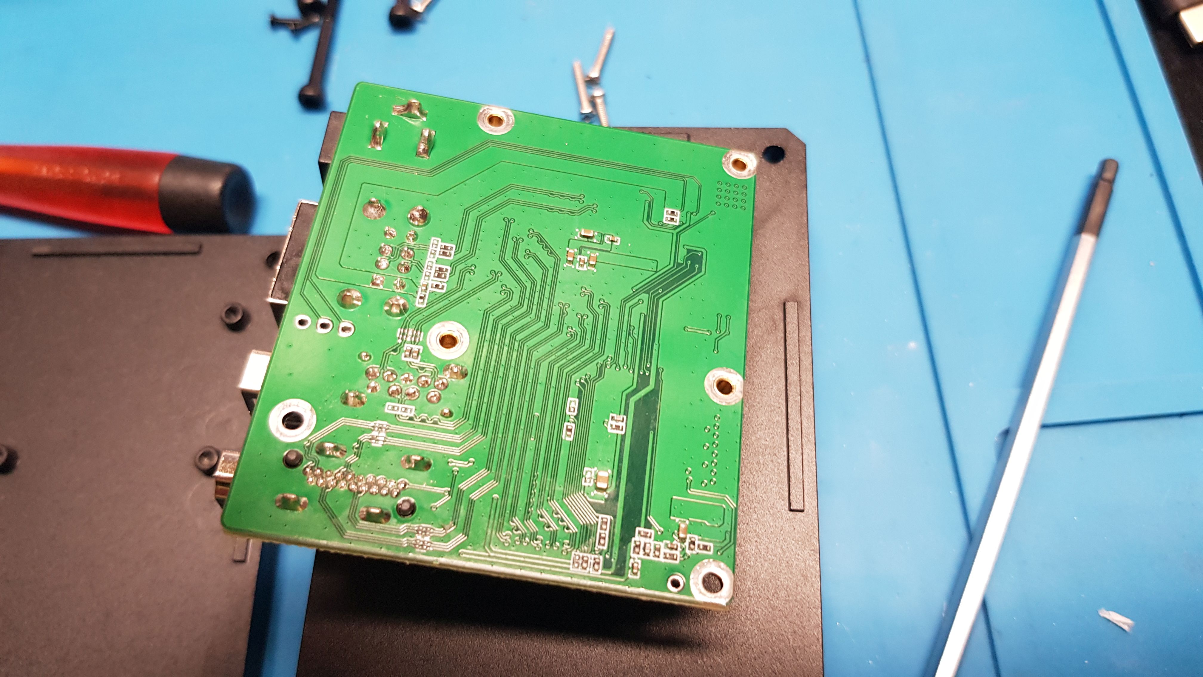

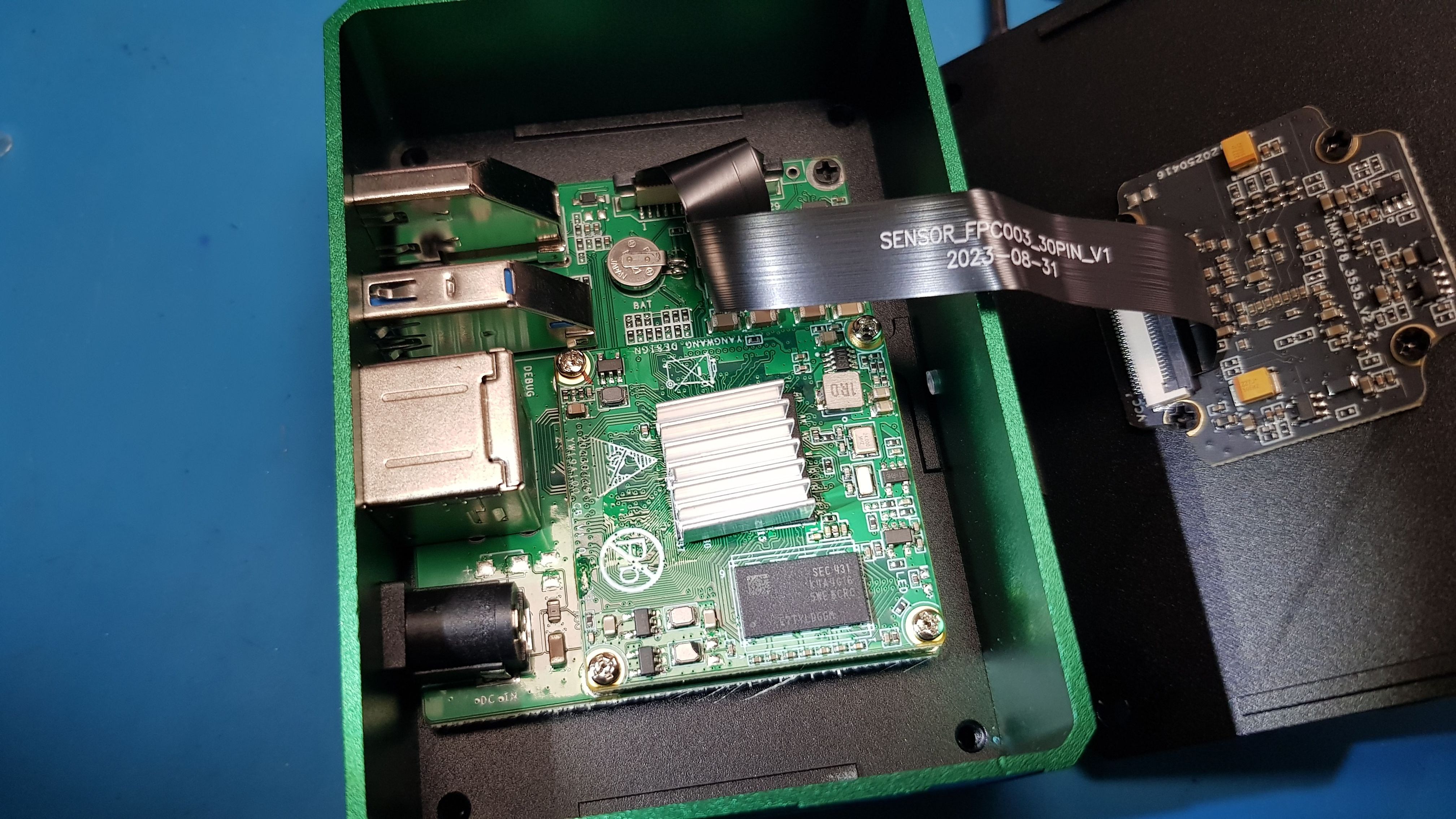

Interesting to see.
this is my Maant xj2 from the inside. Pretty much the same (it also runs the same software/menu structure&features)
I don't have the means (or knowledge) to dump the firmware
this underside had some horrible chinesium flux (white residue) that couldn't be removed with alcohol, but did remove with contact cleaner.
the thing I don't like about this camera is that it only has tripod mounts on the sides, and not one on the top. It makes it awkward to mount it on a little tripod (I use it for more than just pcb repair). but that Bresun is the same in that regard.
And the graphics on it are a bit...meh, but I'm sure a bit of acetone or something could probably (dis)solve that (not that it's that important though)
But the price was good  ;) ;D
