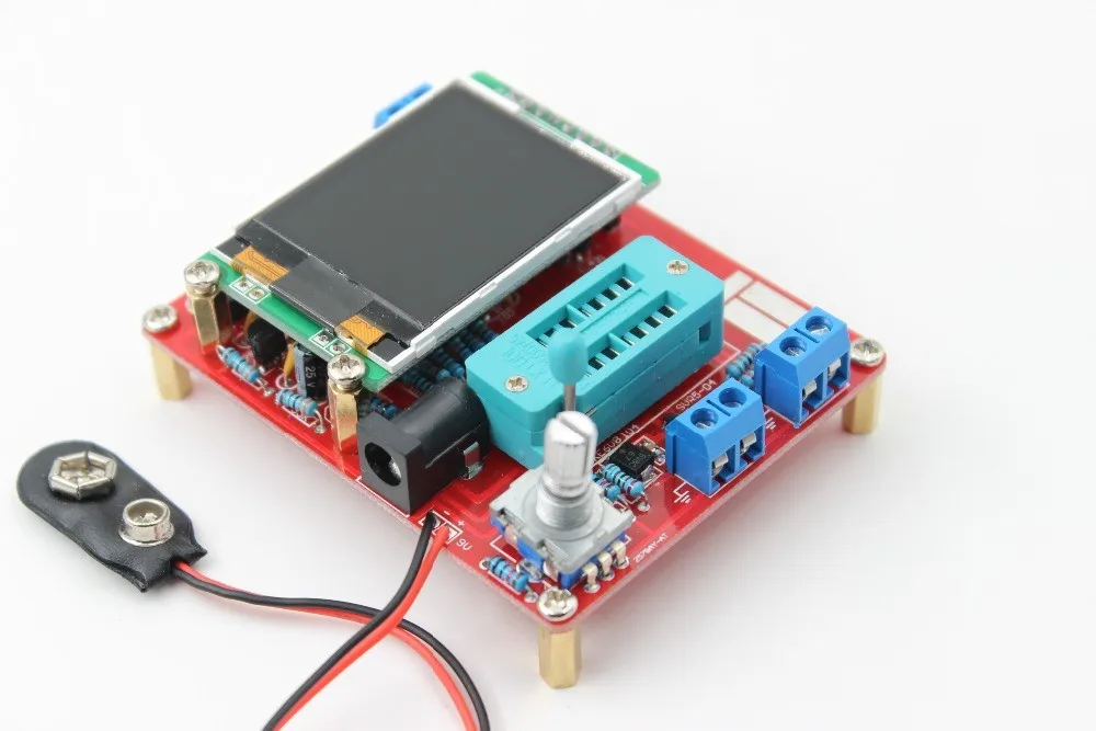

Offline Chriss
  • Posts: 534
Re: $20 LCR ESR Transistor checker project
« Reply #5641 on: May 09, 2019, 10:39:43 pm »
Hi!
I got yesterday my new, clone measuring tool from ebay, where I don't know which is my version of my FW.
I read lot posts here and sorry if I jump over the answer...
I have several questions because I'm really confused now:
I found this link with great resources about this tool ( probably most of you know this link ):
https://yadi.sk/d/yW8xa5NJgUo5z
There is two jpg, one is labeled with:
LCR-T4(T3)NoStripGreed ( actually this is my hardware )
And one is labeled with:
LCR-T4(T3)StripGreed
So, what this means "StripGreed" & "NoStripGreed" ?
Which version of firmware is maybe better? Or how to determine the right version?
1.13K or 1.13M ?
Or even can I mix up the versions?
Now I have an 8MHz oscillator on my pcb, is it prefferable to change it to 16MHz?
I can see there is the same unit with 8 and 16MHz osc...
Thank you for any suggestion.

« Reply #5642 on: May 10, 2019, 08:11:02 am »
Whether attentively you read the user guide from the author?
https://www.mikrocontroller.net/svnbrowser/transistortester/Doku/trunk/pdftex/
It is necessary to read STRIP GRID, but not STRIPGREED
On page 10 of a manual there is a description:
"The software can follow to another pin assignment of port D for a simpler connection of the LCD display. The following table 2.2 shows the modifies assignments for the strip grid layout and the alternativ connection of a graphical display for the micocontrollers ATmega328."Compare schematic circuits on these clones and you will see a difference in connection of the display to PD ports.
In a manual there are also answers to other your questions. :)
« Last Edit: May 10, 2019, 08:19:08 am by indman »

« Reply #5644 on: May 10, 2019, 10:49:41 am »
1.13K or 1.13M ?
The current m-firmware is 1.35m (soon 1.36m ;) ). The README file of the m-firmware explains the differences briefly. The main difference is that the k-firmware supports the SamplingADC for measuring low value caps and coils, and that the m-firmware offers several additional features like IR RC receiver/decoder, IR RC sender, servo tester and so on. I'd suggest to get another tester and run both firmwares.
Yes, it doubles the limit of anything frequency related and improves time related measurements, e.g. max. squarewave frequency, frequency counter and inductance measurement. It also speeds up the display output (matters for color displays).

Offline Andbro
  • Posts: 121
« Reply #5645 on: May 10, 2019, 01:31:56 pm »
I have a GM328A+TFT. I want to install the firmware 1.34mRus(8MHz).zip from CloneTtester. I have create a new folder and i've decrompressed the file from ComponentTester-1.35m. After i've decompressed the firmware 1.34mRus(8MHz).zip in this folder. I replaced the for english in my config.h.
I open with WinAVR Makefile and follow the WINAVR [Make All]. But i have these errors.
> "make.exe" all
      0 [main] sh 9940 sync_with_child: child 5456(0x1D8) died before initialization with status code 0xC0000142
  57296 [main] sh 9940 sync_with_child: *** child state waiting for longjmp
/usr/bin/sh: fork: Resource temporarily unavailable
avr-gcc -mmcu=atmega328 -Wall -mcall-prologues -I. -Ibitmaps -DF_CPU=8000000UL -DOSC_STARTUP=16384 -gdwarf-2 -std=gnu99 -Os -funsigned-char -funsigned-bitfields -fpack-struct -fshort-enums -MD -MP -MT main.o -MF dep/main.o.d -c main.c
main.c: In function 'main':
main.c:1239:3: error: 'POWER_DDR' undeclared (first use in this function)
   POWER_DDR = (1 << POWER_CTRL);        /* set pin as output */
main.c:1239:3: note: each undeclared identifier is reported only once for each function it appears in
main.c:1240:3: error: 'POWER_PORT' undeclared (first use in this function)
   POWER_PORT = (1 << POWER_CTRL);       /* set pin to drive power management transistor */
main.c:1331:9: error: 'BUTTON_PIN' undeclared (first use in this function)
   if (!(BUTTON_PIN & (1 << TEST_BUTTON)))    /* test button pressed */
make.exe: *** [main.o] Error 1
> Process Exit Code: 2
See lines:
 Line 1239 POWER_DDR = (1 << POWER_CTRL);        /* set pin as output */
 Line 1240 POWER_PORT = (1 << POWER_CTRL);       /* set pin to drive power management transistor */
 Line 1331   if (!(BUTTON_PIN & (1 << TEST_BUTTON)))    /* test button pressed */
