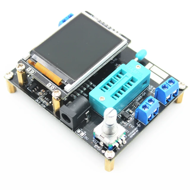

Hi all, stupid question incoming.
I bought a version of the tester a couple of years ago:
Really like the thing. I bought this one specifically because I thought it had the nicest looking UI. Very 'graphical', uses the full display instead of a bunch of text squished into the upper-left corner. I've seen there are more capable versions of this device with a signal generator, frequency counter, volt meter, IR decoder and perhaps other stuff (anything neat that's non-obvious?). Would this be a good upgraded version to buy:
https://www.aliexpress.com/item/LCD-GM328A-Transistor-Tester-Diode-Capacitance-ESR-Voltage-Frequency-Meter-PWM-Square-Wave-Signal-Generator-SMT/32812240696.html
? Would I need to update the firmware on it? Would I miss much if I didn't?

Yep. the AY-AT is a nice clone. You don't have to upgrade the firmware if you're happy with the features, but the open source firmwares (k and m) offer a lot more. The fancy graphics of the modified firmware consume a lot of the flash memory. The firmware of the AY-AT supports just two IR protocols, IIRC. The m-firmware offers about 15 (and four different modulation types).

Didn't even think about the graphics consuming flash, but of course, that makes a lot of sense. So is the AY-AT the unquestionably best ready to order cheap clone or do the other variants at least offer some sort of trade-off that might be better for some? It's really hard to an outsider to understand the differences between all the devices and firmware branches, is there a manual or even some kind of comparison to see what I'd be missing?

I do like the graphics - more internal info on device being tested , also the graphics may miss-label a defective component , so another indicator of failure .
I hand not thought about the " taking up memory " , just wondering how much performance / capabilities having the graphics takes away ?

There's no perfect clone. If you want all the hardware options you have to build a tester yourself. You'll find the documentation for the k-firmware at https://www.mikrocontroller.net/svnbrowser/transistortester/Doku/trunk/pdftex/english/ (download the archive and extract ttester.pdf). And the m-firmware includes a README file with all details.
