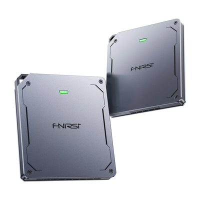

I am an FNIRSI DLA-16 Plus owner and would like to share some info about it.
Product page:https://www.fnirsi.com/products/dla-32
User manual:https://cdn.shopify.com/s/files/1/0694/8310/2426/files/DLA-16_Plus_DLA-32_Plus_Logic_Analyzer_User_Manual_EN-V1.2-2026.03.17.pdf?v=1786704068
Specs:
Feature \ ModelFNIRSI DLA-16 PlusFNIRSI DLA-32 Plus
Number of Channels16ch32ch
Max Sampling Rate (Buffer)1CH/1G, 8CH/1G, 16CH/500M1CH/1G, 8CH/1G, 16CH/500M, 32CH/250M
Max Sampling Rate (Stream)1CH/1G, 2CH/1G, 4CH/500M, 8CH/250M, 16CH/125M1CH/1G, 2CH/1G, 4CH/500M, 8CH/250M, 16CH/125M, 32CH/50M
Min Collectable Pulse Width2ns2ns
Max Collectable Frequency200MHz200MHz
Hardware Storage Depth4Gb4Gb
Max Sampling Rate (Buffer Stream)4Gbit At low sampling rates, depends on the computer's memory size4Gbit At low sampling rates, depends on the computer's memory size
Data Cache ModeBuffer / Stream / RollBuffer / Stream / Roll
Acquisition Accuracy±1 sampling cycle±1 sampling cycle
Trigger TypeRising Edge / High Level / Falling Edge / Low Level / Any EdgeRising Edge / High Level / Falling Edge / Low Level / Any Edge
Protocol Support170+ (open protocol decoding library, customizable for any protocol)170+ (open protocol decoding library, customizable for any protocol)
Input Withstand Voltage-40V~+40V-40V~+40V
Input Impedance250K/15pF250K/15pF
Threshold Range-5V ~ +5V (0.1V step)-5V ~ +5V (0.1V step)
Waveform Output3.3V, 1Hz~20MHz, 4-channel PWM3.3V, 1Hz~20MHz, 4-channel PWM
Channel Interface1.27mm shielded cable interface1.27mm shielded cable interface
Power Supply Voltage5V±0.2V5V±0.2V
Power Supply Current460mA (@5V max)460mA (@5V max)
Dimensions≈90*81*11.5mm≈90*81*11.5mm
Operating Temperature0~70°C0~70°C
PS: Teardown photos coming soon.
