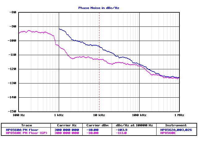

The 8563E had 1 Hz resolution bandwidth standard, the 8563A 10 Hz.  I could be mistaken but I don't believe there was a 1 Hz option for the 856xA portables.
The -E series analyzers also have noticeably lower noise.
Not sure which subassemblies can be swapped.  The HP part #s on the PC boards are the best guide to that.
