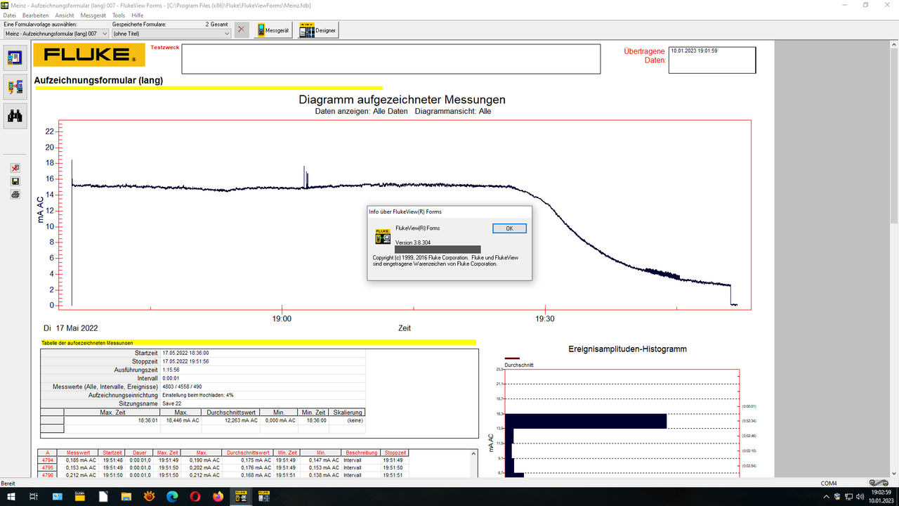

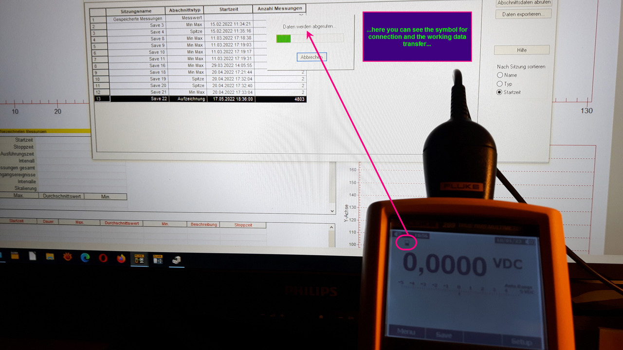

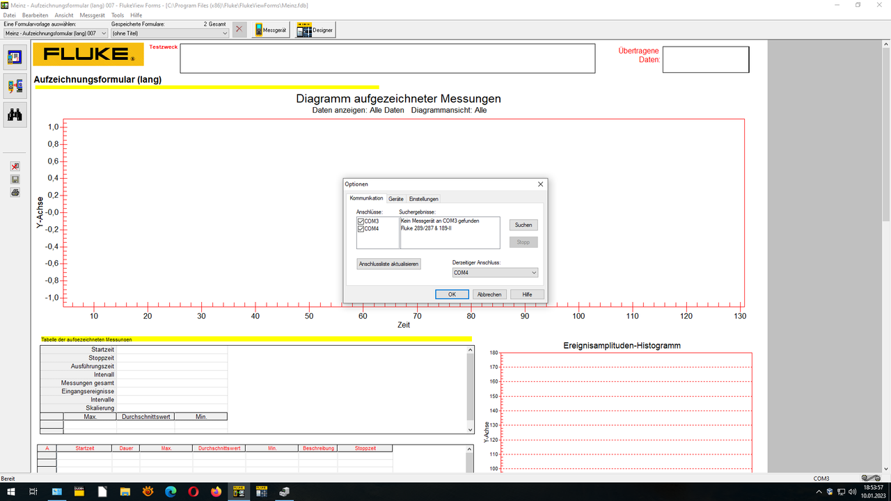

I am on Linux, but for testing purposes I did a fresh installation of my "FlukeViewForms 3.8.304" in one of my virtual boxes of Win10. You have to go online to use the FTDI Drivers, but other than that, there was no problem at all. Well, in general I use FlukeViewForms only with my "Windows 7 Offline computers" respectively within my "Windows 7 Offline virtual boxes", so that I also used the compatibility mode "Win7" before installing this software as an admin - but that's it. I guess it is the same with Windows 11...
Here is the process of searching for com port 4:
...and here the process of data transfer:
...and here the result:
Cheers!  ;)
