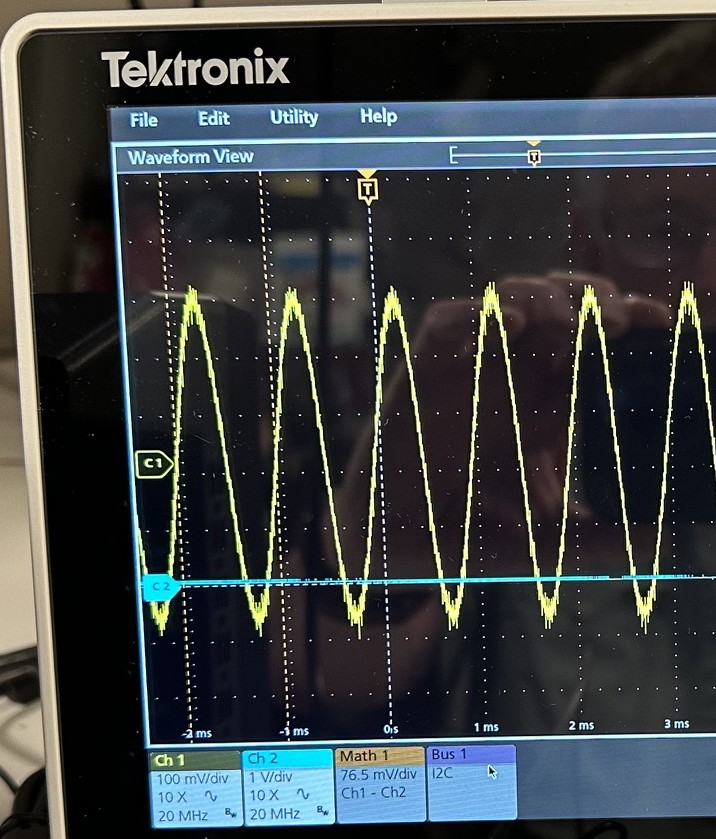

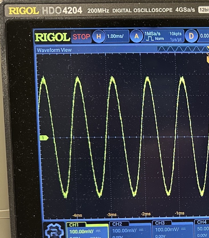

I just acquired a Tek MSO22 and did a comparison of screen trace quality with my two other main scopes: Keysight MSO3012T and a Rigol HDO4204  (yes, I'm a scope addict).  Clear traces are important to my audio work.  The scopes were set to equivalent conditions (BW limit=20MHz, same vertical and horizontal scales, 10:1 probes, no averaging, etc) and simultaneously fed the same sine and square wave signals on channels 1 and 2.  The photos below show the screens after running a single shot trace.  (Photos intentionally large to show detail.)
[ Attachment Invalid Or Does Not Exist ]
No question that I prefer the Tek trace as super clean and stable.  Keysight is close behind while the Rigol is almost unusable because the noise on the trace causes erratic triggering.  The Tek is 70MHz, Keysight 100MHz, and the Rigol 200MHz, but I thought BW limiting would "equalize" that aspect of it.  Also note that the Tek and Keysight are inherently 8-bit machines while the Rigol is 12 bit.  Could be a factor.  What other settings could explain the significant difference with the Rigol?

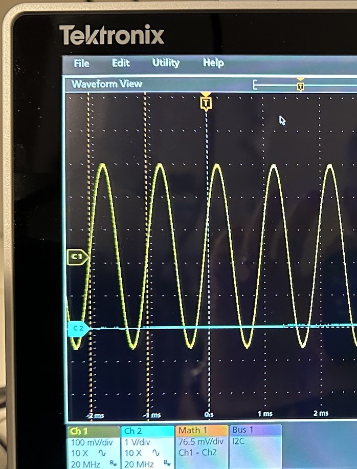

For comparison here is Siglent SDS2504xHD  with full 500MHz BW.
And SDS2504xHD  is also acoustically so silent people think it does not have fan.
Since you already own a Siglent AWG, SDS2000xHD should have been your choice, not that Rigol.
Anyway, beside that, what you show is very bad. I would still check probes and grounding. It should not be that bad...

And with 20MHz BW limit. Trace is pretty much a single pixel wide, visibly better than all your scopes..
Is that 600 mVpp at 1 kHz?
I only have a really cheap scope, but it doesn't look that bad on mine.
I have to turn off BW, turn on Peak Detect, and scale the signal down to about 100 mVpp (50 mV/div / x10) just to see that much noise.
Something's wrong with your setup.

« Reply #6 on: May 15, 2026, 06:16:02 pm »
Noise from the ADC and input circuitry is likely the culprit on the Rigol. In my experience digital Tektronix scopes are quite good where it comes to having low noise and thus clean & crisp traces.
To be able to compare anything, the conditions must be as similar as possible.
That means the same sample rate, memory, and above all:
The same probes.
I wouldn't connect all the scopes to a single signal source at the same time, and certainly not the way they're set up in the picture.
To rule out the possibility that there's something wrong with the Rigol, I would feed the signal from the generator directly using a good BNC cable.
What you're seeing right now is far too noisy, even by Rigol standards. ;)

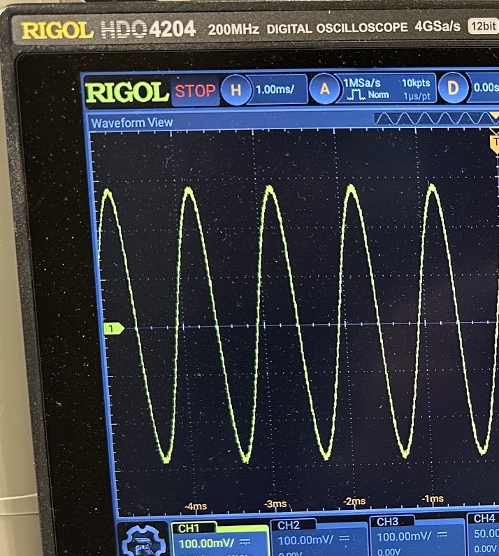

OK, so I did more testing on the Rigol.  Hooked up only one connection from signal generator to the scope to avoid ground interaction.  First three images were done with the same signal level as previously (200mv rms):
(1) Rigol switchable probe set for x10  (this image compares as the same with the previously posted image for the same condition - reference check)
(2) Tek probe (x10 fixed)
(3) "Junkbox" switchable probe set for x10
Following five images were done at 20mv rms to allow for x1 attenuation:
(4) Direct cable from the signal generator to the Rigol input
(5) Signal through Rigol probe set for x1
(6) signal through "junkbox" probe set for x1
(7) signal through Rigol probe set for x1 shown on Tek scope
(8) Direct cable from the signal generator on Tek scope
My impressions from images (1) - (3) (x10 measurements):
Rigol probe is inferior to even the junkbox probe.  Both are inferior to Tek.
From images (4) - (6) (x1 measurements on the Rigol scope):
The Rigol scope itself can produce a very good trace with the direct input (signal generator at 600 ohm output setting).  So ADC's must be OK?
Things deteriorate fast with the Rigol probe set for x1.  Lots of noise.
Even the Junkbox probe is better at x1 but still not great noise pickup.
From images (7) - (8) (x1 measurement on the Tek scope):
For comparison to the Tek scope,  with the Rigol probe set for x1, compare (7) with (5) above. Did not have a x1 Tek probe to compare with, unfortunately, but
definitely a deteriorated signal compared to straight wire which looks absolutely beautiful on the Tek (8) and about the same on the Rigol (4), too!
So it seems Rigol probes are definitely inferior.  But I'm surprised at the noise picked up by the probes in the x1 setting.  Could be my LED lights.  I know my lab also suffers from power line hum pickup.  Just the limitations of my space.
