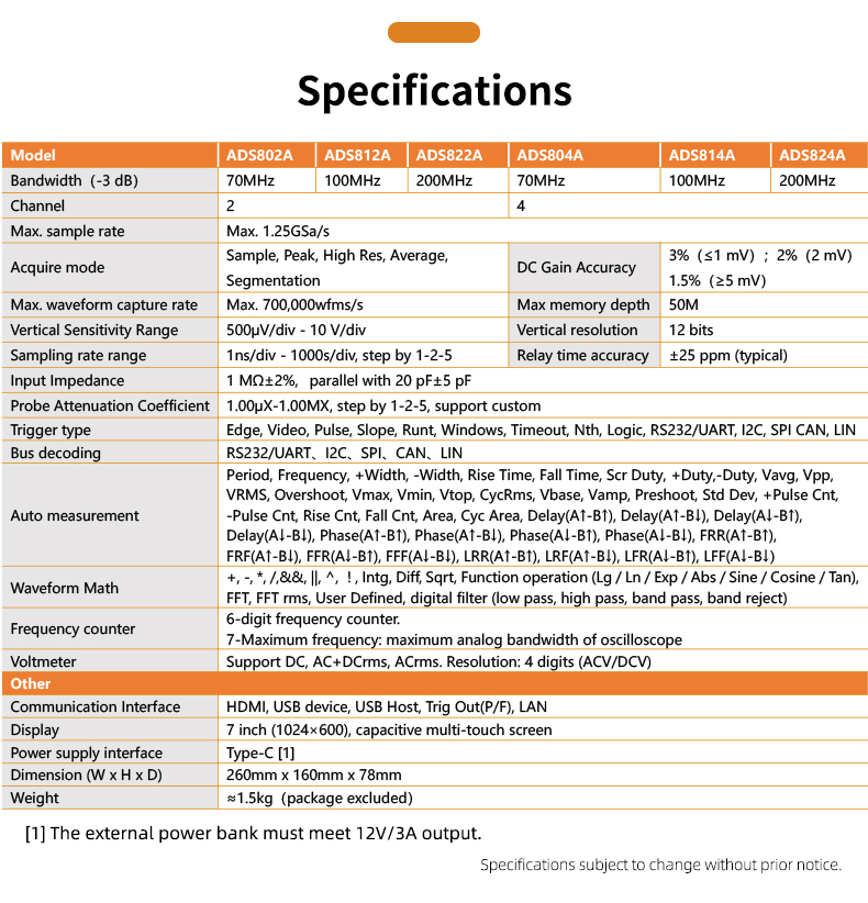

a little short on the sampling ...
It's 1.25 GSa/s in dual channel mode. 625 MSa/s with 4 channels.
Eleshop: https://eleshop.eu/test-measure/oscilloscopes/all-oscilloscopes/owon-ads804a-oscilloscope.html
A question of hackability. ;)
« Last Edit: April 16, 2025, 07:16:42 am by Aldo22 »
I bet it's a rigol inside with owon design software
Also they talk about bode plot on user manual but i didn't understand where is the output of the internal awg
« Last Edit: April 16, 2025, 10:41:34 am by ptluis »
Not sure. Sampling rate is better than the Rigol (DHO800/900).
Rigol has:
625 MSa/s (dual-channel)
312.5 MSa/s (full-channel)
Owon has:
1.25 GSa/s (dual-channel)
625 MSa/s (full-channel)
I was wondering the same thing.

Owon has:
I don't think we can trust the user manual. On owon website they write 625MSa/s (dual-channel), and full channel is 6250MSa/s(full-channel)!!!  :palm:
Companies don't worry much about this kind of error these days. Is it too expensive to pay someone competent to write the correct information? Anyway, I sent them an email. Let's see if I ever get a response.
check here and check for yourself
https://www.owon.com.hk/products_ads800a_series_12bits_digital_oscilloscope
Online Aldo22
  • Posts: 2692
Re: Owon ADS814A 12 bits oscilloscope, Rigol dho800 competition
« Reply #11 on: April 16, 2025, 01:00:45 pm »
Yes, strange.
I trust the manual more than the advertising.
It's described quite precisely there.

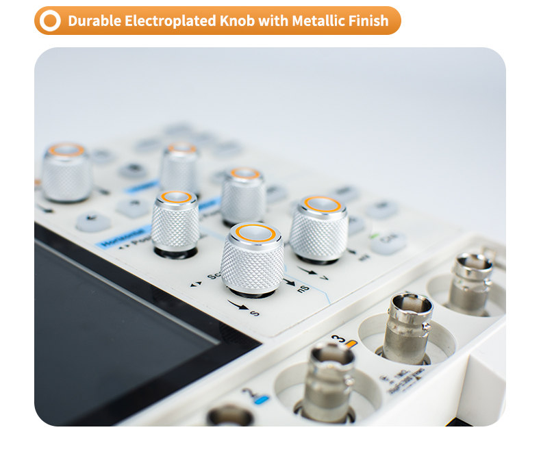

Has that stupid single multipurpose knob!
W3OHM
Offline tautech
  • Posts: 31896
« Reply #23 on: March 20, 2026, 02:15:58 am »
There is zero need for a 2nd if you know how to drive them.  ;)
When in the field to be adjusted a press should pop up a virtual keypad to precisely set a value rather that have to twist the encoder to that value.
Even experienced users seem to completely overlook such a feature.
Avid Rabid Hobbyist

« Reply #24 on: March 21, 2026, 04:47:07 am »
Well for us that prefer to drive with knobs when we can, instead of touch screens, a knob for each cursor is easier than having to push and click the knob to navigate through the cursor modes.
I got spoiled with the dual cursor and zoom knobs when I got my first LeCroy 9354AL. I like the resurrection of that feature on the Rigol 800/900 series. If Rigol can do that on such a small platform why can't all of the other scope manufacturers do the same? Encoders are cheap!
I think the "multipurpose single knob" started when Tek introduced that on their early TDS scopes including the popular TDS220 and some prior CRT scopes and when other DSO companies started their venture they just copied Tek. At least the dual knobs returned on the DPO/MSO4000 series and may have been present on other Tek scopes that I might have missed.
I'm not a big fan of touch but I am fully aware of the keypad entry and have used that extensively in combination with the cursor knobs my LeCroy WaveRunner 6100A (built by Iwatsu for LeCroy) which I really like as it has knobs for all major functions including all zoom functions as well as touch screen to boot. I wish I could find a 12 bit scope that has the ergonomics of the WR 6100A.
I also have always liked the way LeCroy implemented the cursors with non screen cluttering simple up and down arrows that will allow indicate the maximum and minimum data point on the screen display instead of the line type cursors of today, which is a fall back to the Tek analog scope method. The cursor arrows go back to the late 80's when they introduced the 9400 series which performance wise was probably 5 maybe 10 years ahead of everyone else, not ro mention deep memory!
