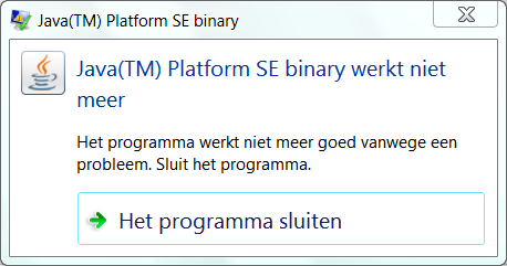

Testcontroller crashes when I select "reconnect" in the "load devices" page.
earlier versions didn't have this problem.
Offline KungFuJosh
  • Posts: 8424
  • TEAS is real.
Re: Program that can log/control many multimeters and other devices.
« Reply #4585 on: September 15, 2025, 02:59:12 pm »
Reconnect works fine for me.
Try debug mode and see if you notice anything.
Best Continuity Tester Ever
Best Continuity Tester Ever...Got Betterer!
Online Gertjan
  • Posts: 368
« Reply #4586 on: September 15, 2025, 05:20:13 pm »
Bug?
I experience the same problem. After clicking "Reconnect" I get a Java popup:
Roughly translated: Java (TM) Platform SE binary does not work anymore.The program is not working anymore because of a problem. Close your Program.
A really helpfull message... :)
This is on a Windows 7 - 32bit machine. (clean OS with just a few measurement programs)

Basicly, everything is normal, disconnecting after the "Reconnect" is OK. But after re-start TC crashes immediately....
On another Windows 10-64bit machine I do not get the Java error, but not all devices are reloaded after "Reconnect". (they were loaded correct the first time)
For the moment my workaround is to close and re-start TC instead of using "Reconnect"...
Regards, Gertjan.

Using Windows 11 and latest TC (2.68)
Java 8.0 Update 411  (build 1.8.0_411-b09)
TC Version 2.31 has not this problem.
Remarkeble: With no devices connected, ofcourse TC won't find anything,
but then no crash. With devices connected it crashes.
Restart is working fine.

Bug?
It is a very log time since I have seen a crash on TC? Is it related to a specific device?
It is a very long time since I have done anything around reconnecting.
Online HKJTopic starter
  • Posts: 4954
    • Tests
« Reply #4592 on: September 16, 2025, 10:38:16 am »
Is there any version other than the latest version? :)
There is, v2.35 is on my server:
http//lygte-info.dk/pic/Projects/TestController/TestController2.35.zip
But yes, I should give a bit more info.
- I am not sure when this started, but at least it happens with the last two TC versions, v2.61 and v2.64.
- I am using the latest Oracle Java, version 8, update 461. The last Java update did not help.
- Windows 7 has all available updates (and worked flawless before). Windows 10 gets all latest updates  & patches.
I am very surprised about these crashes.
Is it related to a specific device, driver or interface?
I generally run on Win10 64bit and also has a Win11 machine, but has not moved TC development or usage to that machine yet.
Offline KungFuJosh
  • Posts: 8424
  • TEAS is real.
« Reply #4593 on: September 16, 2025, 12:55:46 pm »
regards, Gertjan.
I'm using v2.70, which I assume is a beta or prerelease version. You could try downloading that from HKJ's previous post with the link.

Online Gertjan
  • Posts: 368
« Reply #4596 on: September 16, 2025, 03:28:08 pm »
Hi HKJ,
I am saving the older versions too :)
- Using v2.64, I tried different drivers and interfaces. It makes no difference. TC (or Java) crashes after "Reconnect", even when there is not any device enabled on the "Load devices" tab.
- More interesting: version  2.53 works without any issues. With version 2.58 I get the crashes on "Reconnect". (Your v2.35 was fine too)
  I tested wit a mix of devices: SCPI and ASCII, connected with USB, RS-232 and ethernet.
So something changed between v2.53 and v2.58....
Best regards & thanks for looking into this, Gertjan.
« Last Edit: September 16, 2025, 04:49:05 pm by Gertjan »
  • Posts: 4954
    • Tests
« Reply #4598 on: September 16, 2025, 04:36:30 pm »
So something changed between v2.53 and v.58....
The main difference between these two version is the serial library.
