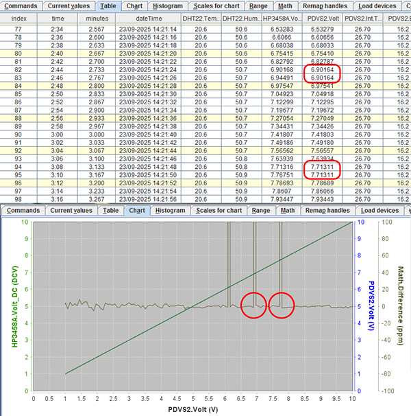

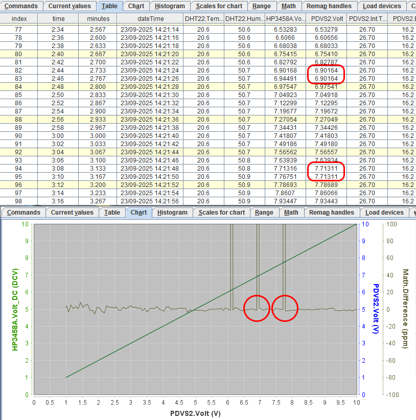

So, YES, please synchronise the param sweeper with the logging! The delay setting for the measurement would be the icing on the cake :)
regards, Gertjan.
What kind of logging are you referring to?
When using the param sweeper, the resulting measurements are logged. But sometimes, there is twice the same measurement in the table (belonging to a previous or next step). For a lot of measurements, like temperature or frequency response, this is not a problem, as the previous and next measured value will be very close.
But when sweeping a device from "min output" to "max output", and measuring the result, a wrong measurement will be very noticeable. Especially when you calculate the difference between input and output, to see the linearity. See an example below:
Full size image: param-sweeper-log-error-1000pix.png
I've only done basic sweeps with the parameter sweeper, but it always saved its own CSV log, and there are delay settings on the sweeper setup as well. Attached is recent parameter sweeper results before self cal on an AWG.
Thanks,
Josh
I am very interested where you found these delay settings in the param sweeper.....
regards, Gertjan.
Online HKJTopic starter
  • Posts: 4974
    • Tests
Re: Program that can log/control many multimeters and other devices.
« Reply #4676 on: September 23, 2025, 03:26:50 pm »
I have implemented a option to synchronize the log to the param sweeper. It switches the log to advance logging SingleOnCommand mode. This means that TC will read data as fast as it can from the device and only log sample when requested (From param sweeper).
I have not added any option to adjust the offset, but place the trig command midways in the time.
Due to the increased communication I will generally recommend to run the param sweeper slower when using this option.
The test version is at the usually location: http://lygte-info.dk/pic/Projects/TestController/TestController.jar
Hi HKJ,
I tested your test version.
It works when using fast measurements, like 1NPLC. The previous problem of sometimes twice the same value  in the table is gone. (as expected with a delay after the param sweeper step)
But when higher accuracy is needed, this is not going to work... Metrology grade measurements are invariably slow. A measurement with 100NPLC will take 2...3 seconds (double with Auto Zero). Measuring OCXO drift with mHz resolution will need 10 seconds gate time with most (better) counters.
Sometimes you need the delay to let the measurement settle. Think of dielectric absorption in cables, or just the settling time of the output of the controlled device.
So I would propose this solution:
The param sweeper triggers the next step for the controlled device -> param sweeper waits for the set delay time -> Param sweeper triggers the log system for ONE measurement.
This way the measurements are always synchronous. The step time can be set to just the time needed for the delay + measurement. And with delay set to zero, the param sweeper will be as fast as it is now.
Thank you for looking into this & regards, Gertjan.
