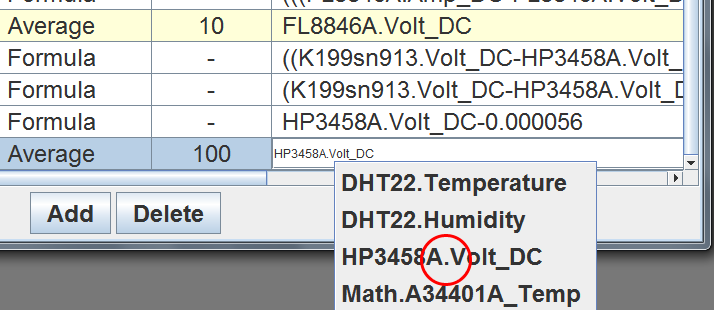

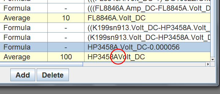

Offline Gertjan
  • Posts: 339
Re: Program that can log/control many multimeters and other devices.
« Reply #4928 on: October 17, 2025, 05:25:50 pm »
Hi HKJ,
Sorry, it seems to be bug reporting time....
There is a small, but irritating bug in the formula editor on the Math tab.
When editing a formula, it is very handy that one can right-click to choose from the meter output names available:
Almost all meter output names are having a point (dot) in the name.
After selecting a meter output name, the meter name is copied into the formula, but without the point:
And off course, without the point, the formula does not work....
The first time I encountered this, it took me a while to find out why my formula did not work. :)
But now I know, and just edit the point back.
This happens for quite a while, at least the last few TC versions. Also, I think there has been a Java update without any change.
The thing is, it always happens when I set up a measurement, and then I just want to start measuring, instead taking screenshots for bug report. :)
I tested on Windows 7 and 10, latest Java and TC. All with the same result.
Regards, Gertjan.

Hi HKJ,
I have a good idea what the issue is, I fixed one problem, but added another  :-[
I filter/process the name to make a legal variable name, a point is removed as part of that process (Because when creating vars TC is only using the filter on the last part of the full name, the first part is supposed to be valid), but here I filter the full name and looses the point.

#cmdSetup advCombobox select
Will there (hopefully) also be an advComboboxHot?
I'm testing it now. There's no highlight for selecting items. I assume you can fix that, but if it's a choice between setting a background color, or highlight selection working, then highlight would be a higher priority IMO.
ETA: You can also see it isn't removing the underscore for the space in the screenshot.
Thanks,
Josh
« Last Edit: October 17, 2025, 09:15:51 pm by KungFuJosh »
Best Continuity Tester Ever
That is fairly trivial to add, because it reuses this class, I had planned on it.
I do not have full control of the colors yet, I would also like to maintain the colors in the displayed value, not only when selecting.
Ops, I have the code, but did not call it, it is fixed.
