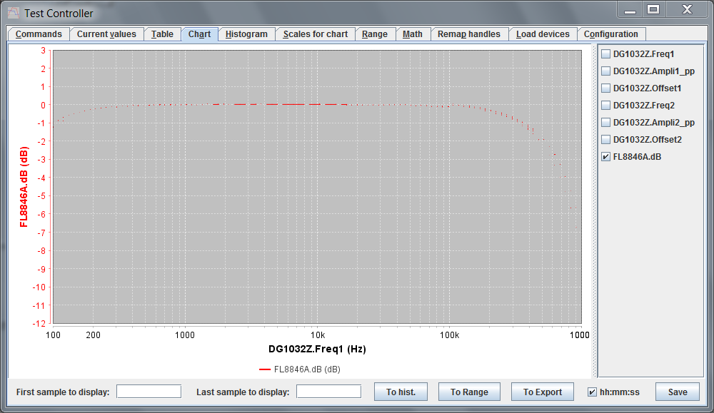

Offline Gertjan
  • Posts: 340
Re: Program that can log/control many multimeters and other devices.
« Reply #6318 on: April 30, 2026, 09:44:44 am »

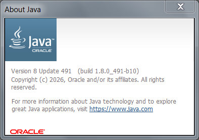

The latest Java update broke my Chart:
Now there are only some semi-random dots instead of a curve....
The offending Java update:
This is on Windows 7 32bit.
I suspected a Windows problem. So I restored to a fresh Windows install. Re-installed TC v3.00, and an older Java Runtime.
And all was good again. Until next day Java updated, and the same problem returned.
Unfortunately, I can't find a way to roll-back a Java update. So I uninstalled Java, and re-installed the older (2025) version. And switched off the automatic Java updates.
I did not test if the same problem occurs on my Win 10 and 11 machines. I just switched off the Java updates for now. :)
regards, Gertjan.
Offline HKJTopic starter
  • Posts: 4795
    • Tests
« Reply #6319 on: April 30, 2026, 09:54:07 am »
I just did a update of Java to see it:
C:\Users\hkj>java -version
java version "1.8.0_491"
Java(TM) SE Runtime Environment (build 1.8.0_491-b10)
Java HotSpot(TM) 64-Bit Server VM (build 25.491-b10, mixed mode)
My chart works fine, both with release and test version of TC

I also updated Java on my other computer and it also works fine, i.e. I have tested on both Win10 and Win11.
This means its is some obscure problem.
Do it only happen with a logarithmic scale?
Do it match the sample points or is it random?
One possible issue may be that Java uses the graphic windows driver different and that is causing the problem, but then I would expect it to show up in more places.
Thanks. Good to know there is no issue in Windows 10 and 11.
So it is probably an issue with Win 7 or 32bits. I did not test with other scales.
I do not want to waste more time with further testing. I will just try another Java update  after a few months, or when the need arises.
On this PC I need 32bits to run ancient measurement software and tools, originally written for DOS, Win3 or Win98. Furthermore, Windows 7 is convenient because it is very stable, and no updates to mess with my drivers :).
Regards, Gertjan.
