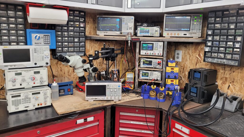

« Reply #132109 on: November 22, 2022, 07:43:52 am »
Pulled the SDS1104 off the Shelf Replaced it with a SDS2104X Plus and it Almost did not fit.. Not sure of I am going to off it or put it up for a 2nd unit.
Hope to have other bench finished by the first of the year.
« Last Edit: November 22, 2022, 08:44:23 am by KG7AMV »
Hope you have other bench finished by the first of the year.
LOL, wondered if you were able to shoehorn it into where the X-E was.  :phew:
Have you installed a wireless mouse into the SA and DSO ? Recommend you do at least in the scope.
Do you have a workstation close so to be able to use their webservers for remote control and direct capture of screenshots ?

« Reply #132111 on: November 22, 2022, 08:44:09 am »
I have a not hooked a wireless mouse up yet. I have a PC Available nearby. I Just unboxed the scope and put it in place and took a photo! I am Uploading the Unboxing to youtube as I am typing this YT UL is slow.
Did you previously remote control the X-E ?
These X Plus have a few more features including a File Manager tucked away in the Save/Recall menu.
Is getting a LAN cable to them possible ?
Avid Rabid Hobbyist
Offline Rhine_Labs
  • Posts: 442
  • Rhine_Labs
    • My Personal Blog
« Reply #132113 on: November 22, 2022, 09:49:55 am »
Yea, Its on the network will try and play with it some in the afternoon tomorrow.
