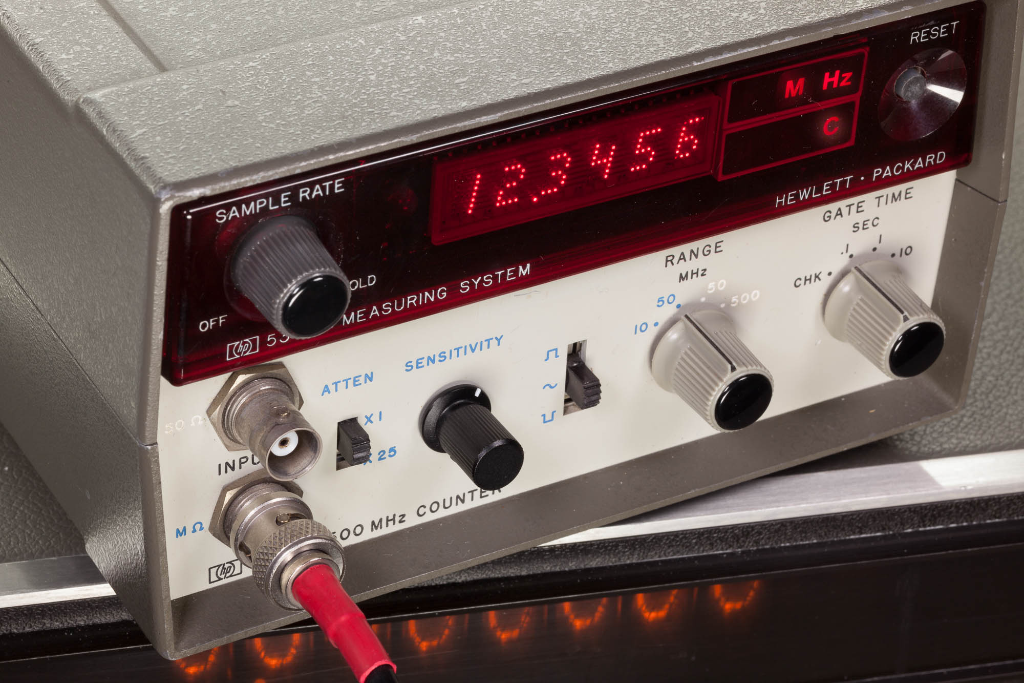

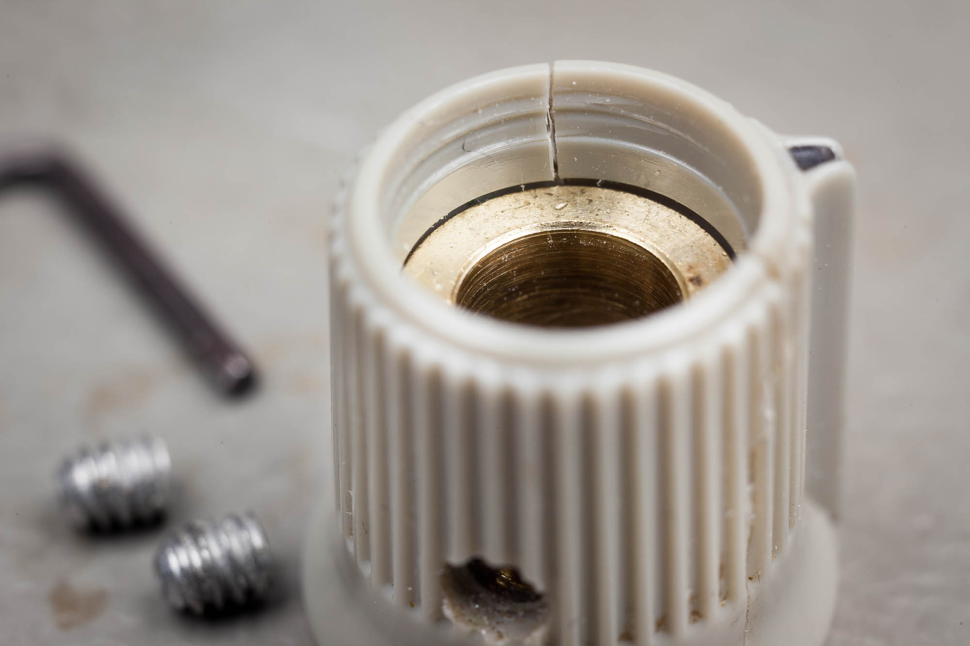

What is the best way to repair a HP knob like this?
https://www.miedema.dyndns.org/co/2025/IMG_4757_Broken_HP_knob-2000pix.jpg
I tried before using epoxy glue (Bison Combi snel/rapide). But that did not work too well. So I am curious what you are using...
This particular knob belongs to a HP 5300A + 5303A counter, made in 1971.
The counter came in my possession with an IC missing. At that time there was no service manual available.
https://www.miedema.dyndns.org/fmpics/Circuits_online/HP5303A/IMG_3565__HP_5303A_missing_IC-2000pix.jpg
This resulted in a nice topic: HP 5303A counter is missing unknown IC... with a lot of (tear down) photos. With some detective work the correct part number was found. A bit later, Dave of Artec found a 5303A manual, and scanned it for me. It confirmed that the found part number was correct.
But now I have to glue the knobs again....
regards, Gertjan.

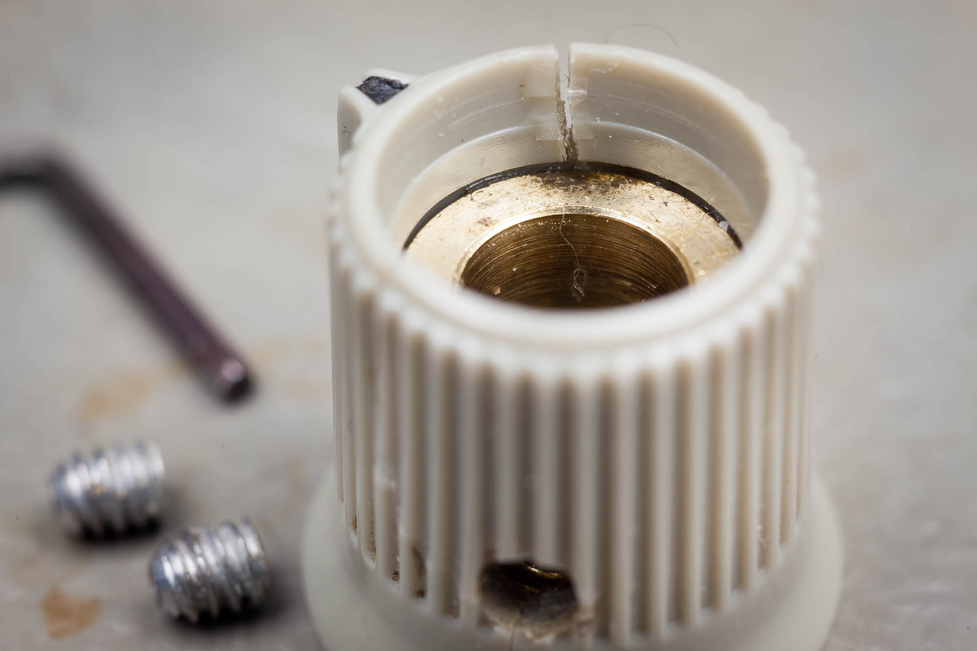

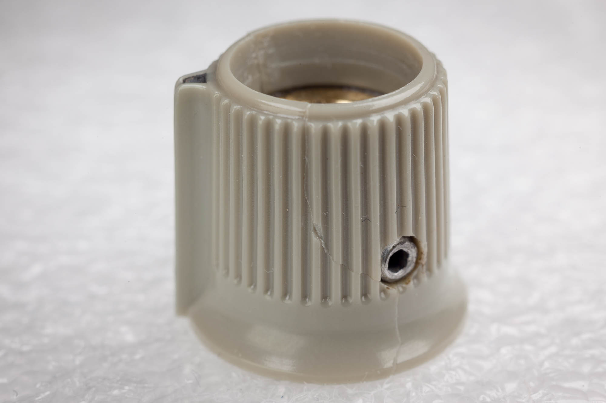

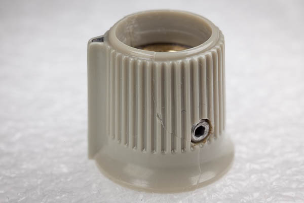

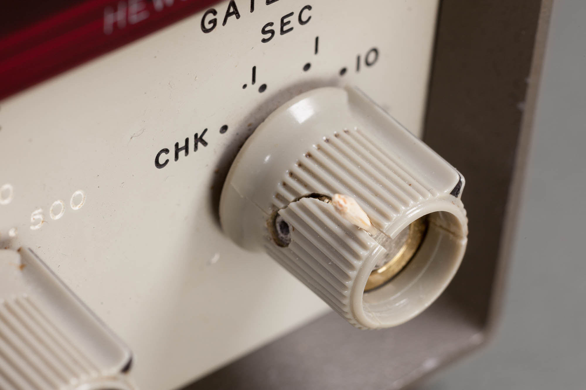

Thank you all for sharing your experiences!
The Dichloromethane gets the most votes. I ordered a bottle EMA plastic weld.
It seems the best solution to weld the plastic together. But it needs good fitting surfaces, and will not attach to the brass core (for extra strength).
In the past I had bad experiences with super-glue. But maybe I didn't use it right, and it seems that there has been a lot of development in super-glues.
Advantage is that it will also work if the crack is not super clean, and it also glues the plastic to the brass core. I also ordered the Loctite 401 superglue.
I removed the knob from the counter, to have a good look with my stereo microscope. (For a change, it was easy to loosen the grub screws with a good fitting Allan key :))
This is the crack I originally glued with epoxy glue (maybe 10 years ago) :
The epoxy just did not attach very well to the plastic. This make me think that this plastic is ABS, as it is known that epoxy does not work very well with ABS.
But I also noticed e few new cracks. The largest can be seen in the background
The same old crack from the inside:
When I originally tried to glue with epoxy, I also tried to glue the plastic to the brass core. But this also came loose...
The biggest of the new cracks:
The new cracks are very clean. so I think these are good candidates to glue with the Dichloromethane.
But I doubt if I can get the old crack cleaned op enough, with both surfaces fitting perfectly for using the Dichloromethane.
So I will try to glue that with the super glue.
Sounds like a complicated approach, but I hope to improve my skills a bit in this department :)
regards & thanks, Gertjan.

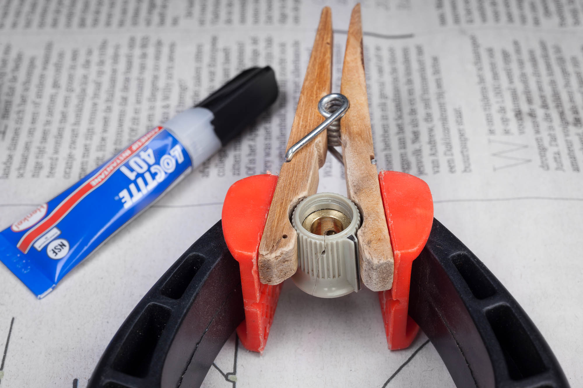

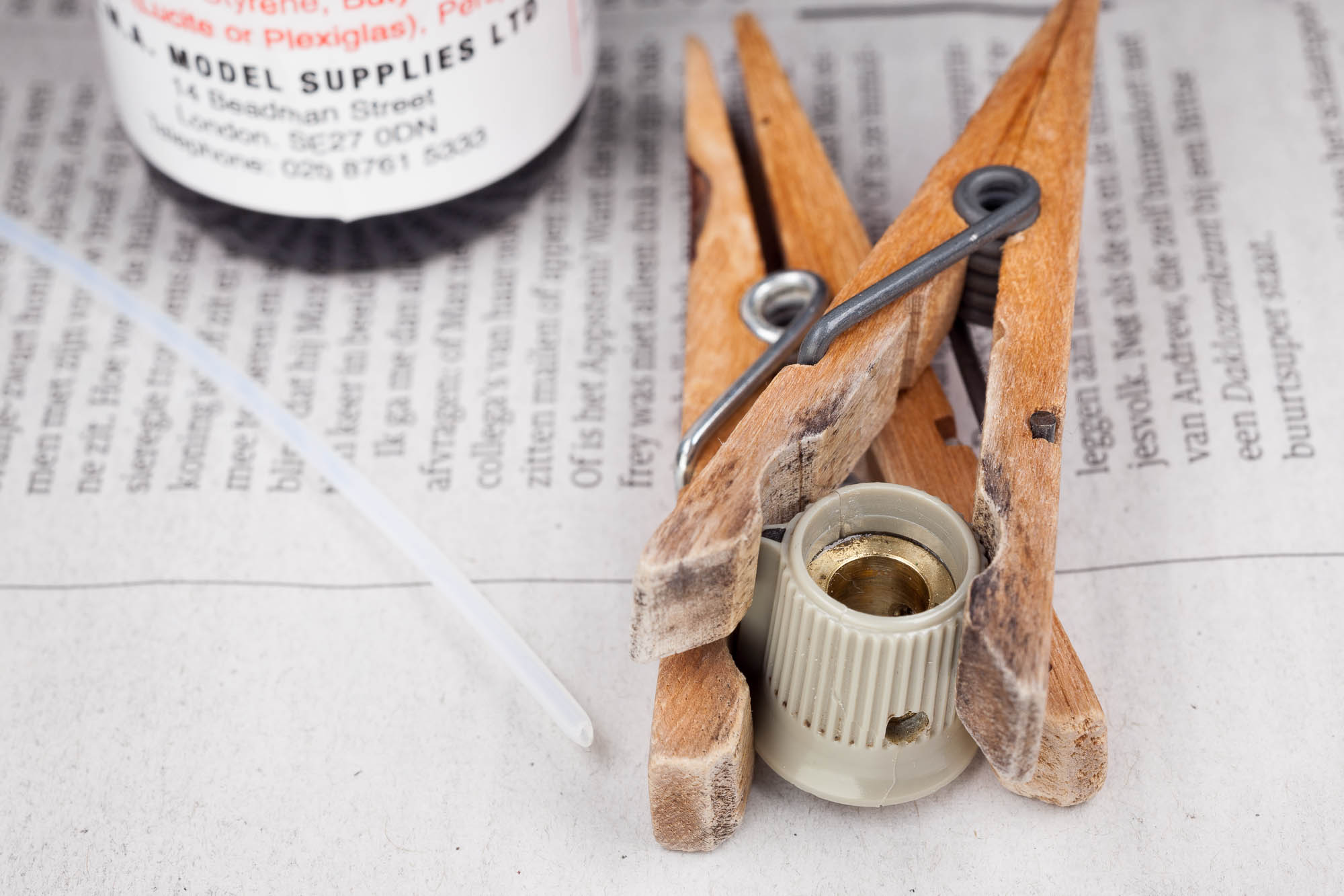

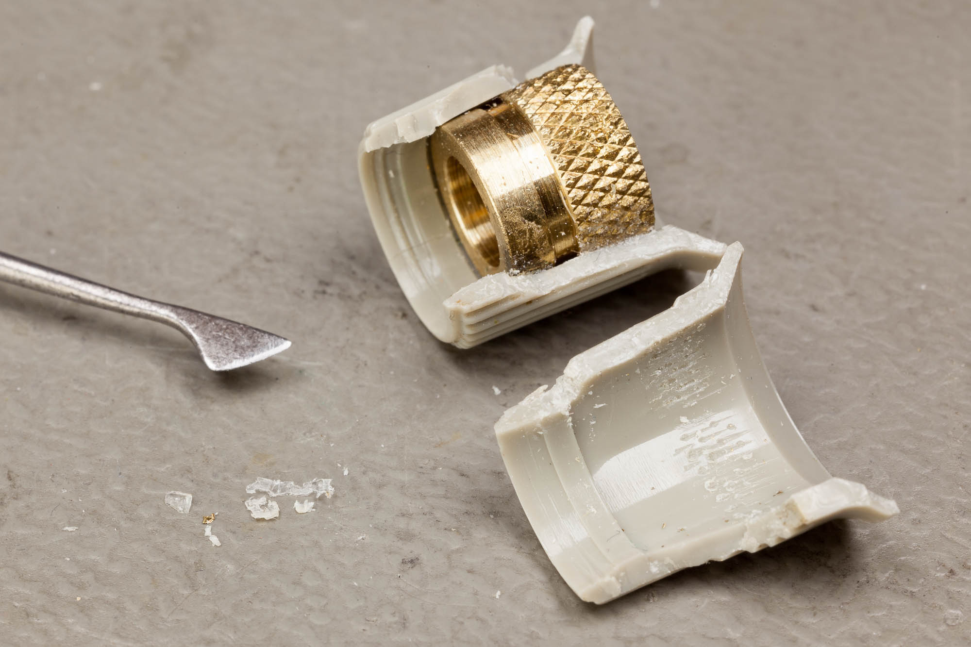

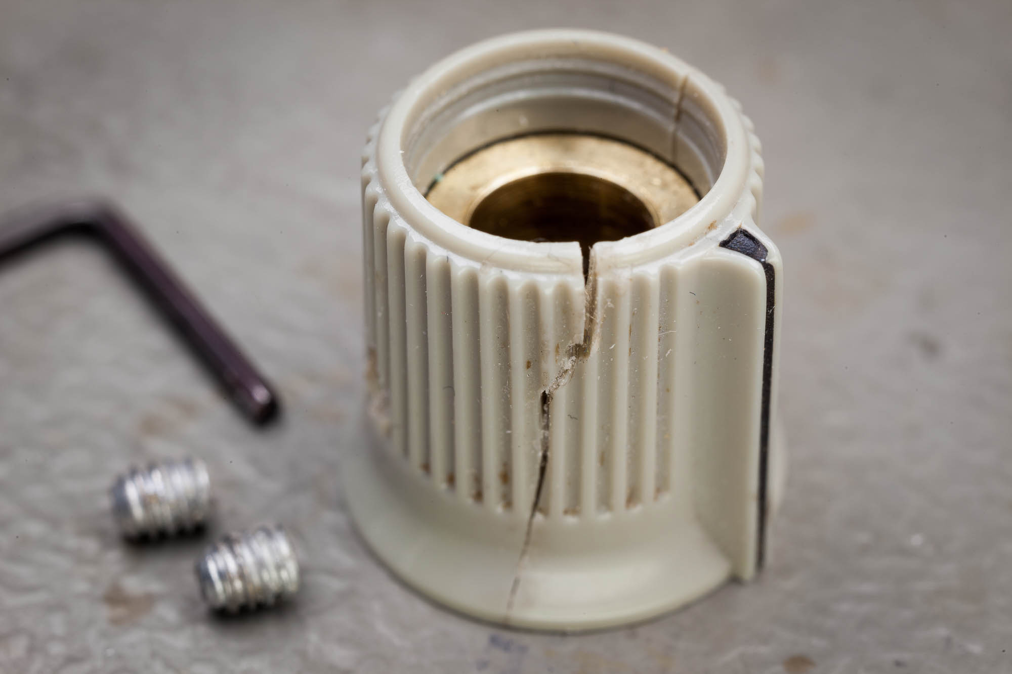

Today I glued this knob.
It had an old crack that I had previously tried to glue with epoxy, and a fresh crack.
When I tried to remove the old epoxy, the knob broke into two halves:
This was actually a good thing, because it was now much easier to scrape the old epoxy glue off.
I was surprised how bad the bonding of the epoxy with the plastic of the knob was. Epoxy and ABS is certainly not a good combination. (Or maybe I did not clean the surfaces well enough before glueing?)
After scraping away as much epoxy as I could, the surfaces of this old crack were still not perfectly matching. so I decided to glue this crack wit the Loctite 401 superglue:
I used just a tiny bit of glue to avoid spilling it over the outside of the knob, and that worked out very well.  Also, I was afraid that the superglue would harden before I got the parts in position, but this was no problem at all.  I let the glue dry for 2 minutes while I pressed the two halves together with my fingers, and then clamped the knob as in the photo.
The other (new) crack had very clean, well fitting surfaces. So I decided to try the EMA plastic weld (Dichloromethane).
I did not have a glass syringe, and was afraid a plastic one would be dissolved by the glue. So I followed the tips of Robert763, and used a a short length of tiny PTFE tube.
I think the idea is  to fill the tube with Dichloromethane, put your finger on top of the tube, and let it go when in position near the crack.
This worked, but the tube also functioned as just a stick, when dipped into a liquid, some drops will stick to it.
What ever, it worked fabulously:
With the knob clamped as in the photo, I applied a few drops on the inside of the crack. The water-thin fluid wicked between the plastic and the brass, and into the crack. Like magic, and very easy to do.
For good measure, I turned the knob over, and also applied a few drops into the other side of the crack.
This EMA plastic weld is really nice stuff!
It is not as highly volatile squadchannel warned me for. I had the time to carefully put the drops in the right place, without evaporating in front of my eyes. But then this is not pure Dichloromethane, it is plastic weld containing Dichloromethane. So I suppose the stuff is optimised for the job in hand.
The result, the cleaned and glued knob:
This is the crack, glued with the Dichloromethane. With the naked eye it is nearly invisible.
The crack glued with the Locktite 401 it a bit more visible, because the less good matching surfaces. Still, with the naked eye hardly visible.
I am happy :). And I learned a bit more about gluing plastic. I will use both glues more often. So thank you all!!
regards, Gertjan.

Pull out the brass core inside, fill the syringe fully with dichloromethane, inject it, then secure the knob with masking tape. That should do the trick.
One drop is enough to penetrate. the key is to fill the syringe completely because it's highly volatile. Otherwise, the heat from your hand will cause the liquid to evaporate and ruin everything.
problem is whether you can put the pulled-out brass core back in. it might be break.
(Attachment Link)
I just bought some of this today, the exact same bottle from my local home center.
It worked brilliantly to repair the broken screw standoffs in a HP 3468A.
I officially really like this stuff and I think I'll use it much more often for repairing cracked plastics instead of superglue from now on. :)
Offline Gertjan
  • Posts: 339
« Reply #138520 on: February 20, 2026, 02:41:20 pm »
Gertjan, PB to you failed. I might have a knib for you here, depends on the diameter it needs to fit on.
Thank you for the offer Wilco!  But I am good:
I found some more opportunities to practice gluing with the EMA plastic weld. :)
When looking at the other knobs with my stereo microscope, I noticed more cracks around the top of the knobs.
Now I used a bit wider piece of PTFE tube. And indeed is was very easy to dip this in the bottle, close the top of the tube with a finger, and thus pickup a bit of fluid in the tube. Release the finger when the tube is in right position for the glue, et voila... :)
Also, now I glued in 2 stages. First drip a little bit of glue on the crack. It will seep into the crack. When dry, apply a bigger drop of glue over the crack. The top surface will melt, and after drying the crack will be invisible.
So, as usual, practice makes perfect. :)
In retro-respect, I think that the new caps on the knobs were the cause of the cracks. Although they were the right size (for 10mm inner diameter), they pushed a bit to much the old plastic apart. I cut a bit from the edges of the caps, and now all is fine.
(When I got this counter, not only an IC was missing, but also a knob and all knob caps. I decided not to try to make the counter original, but went for for a new look, using parts that were obtainable. Knobs for 1/4" and 1/8" shafts are not easy to find in The Netherlands...)
regards, Gertjan.

I like those dot matrix displays.
