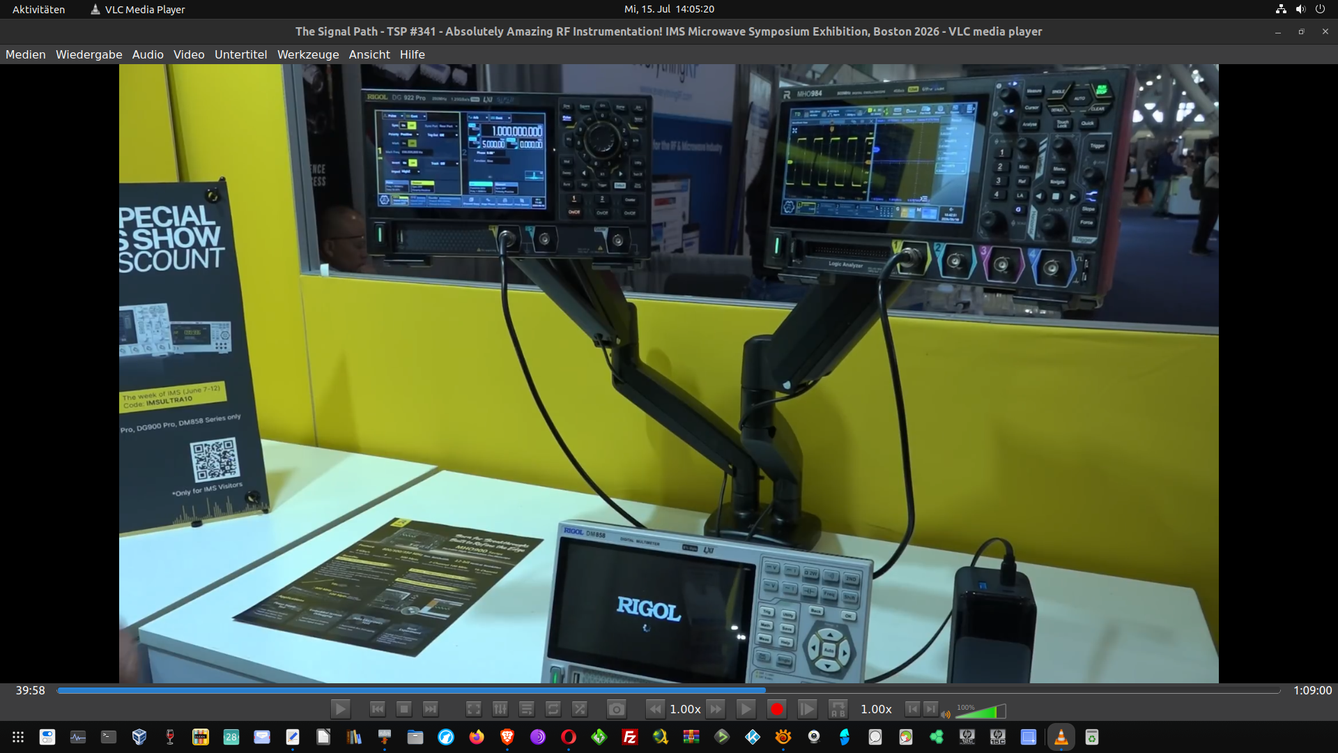

This is from "TheSignalPath" latest youtube video:
"TSP #341 - Absolutely Amazing RF Instrumentation! IMS Microwave Symposium Exhibition, Boston 2026"
...reporting from the exhibition with its high end equipment, but also showing entry level devices for the beginners:
However, it was funny to watch, that the DM858 was off and was only turned on during the video session at 39min. 58s so that you can still see the boot session, which probably reveals, that even from Rigol there was not that interest in showing this product live and from the beginning...  :)

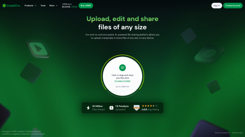

But if some can offer an upload space I can send it. It is 75MByte.
You may use something like limewire, which gives "freeusers", who don't have an account, an acceptable download speed. The uploader also does not need an account and the file will be deleted automatically in a week or so, so that in the meantime other users could download and share the file on further or their own platform or private upload space...
With an account you have some more features like "send file per E-Mail" or so and if you pay for it, which I wouldn't do for this purpose only, you even have more options...
https://limewire.com/
