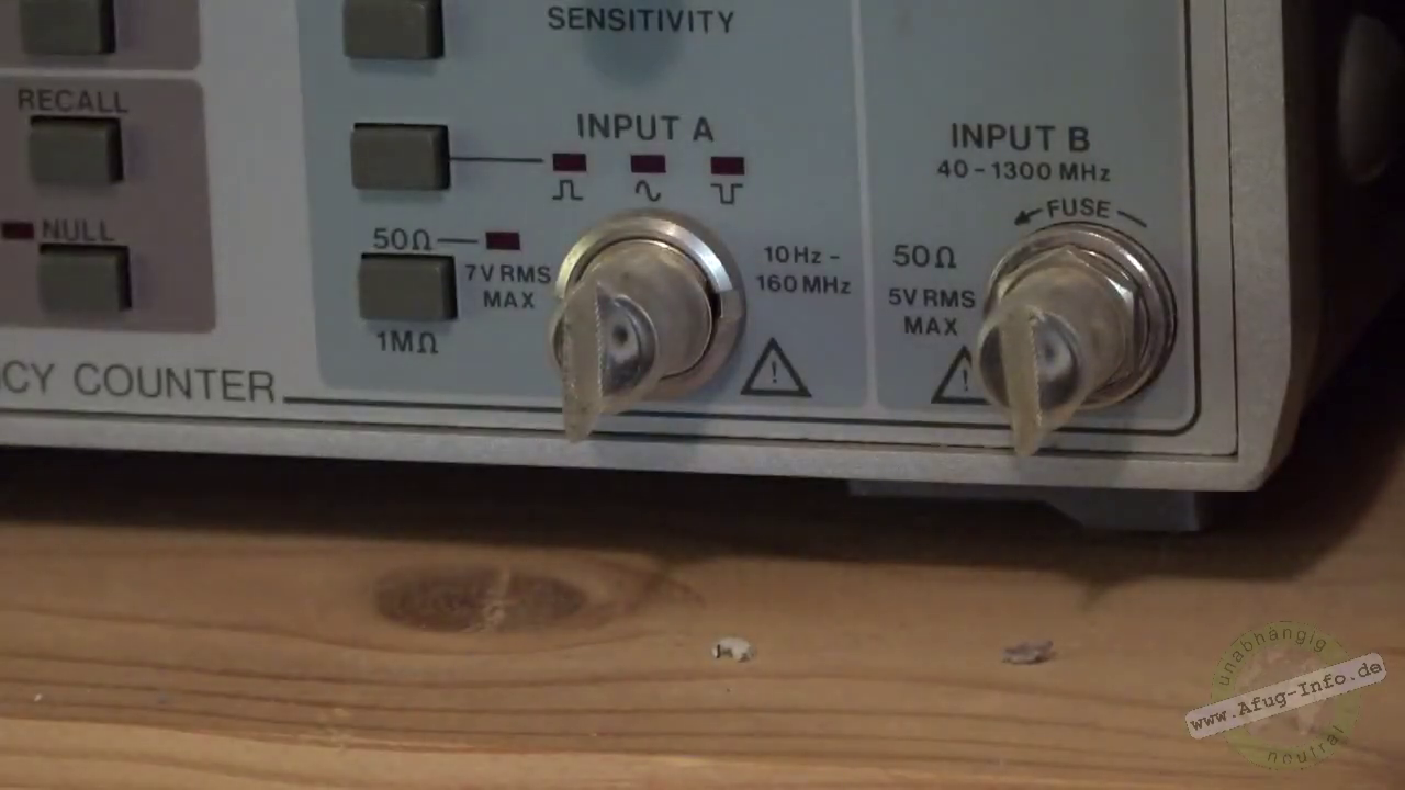

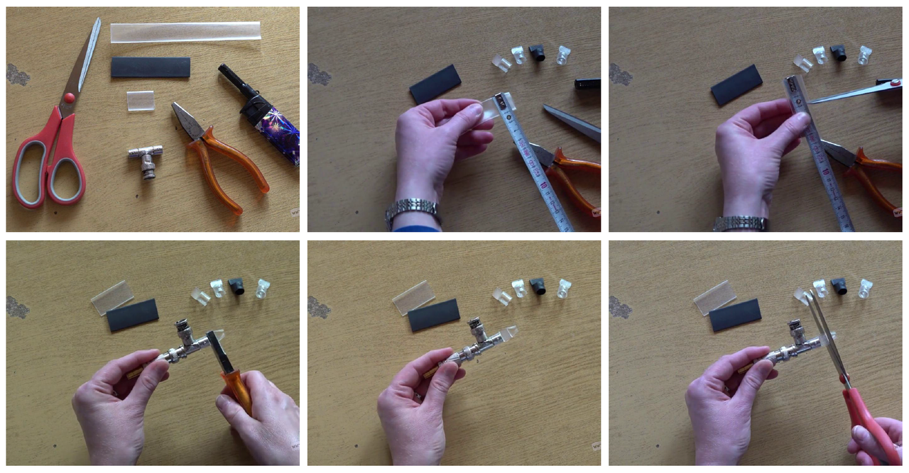

I haven't done it yet, but I like this easy fix shown by afug-info.de:
...the nice touch with the pliers is down to the last detail! Clean, cheap and simply perfect:
Source:
http://afug-info.de/Tipps-Tricks/BNC-Buchsenschutz/
ht*****tps://www.youtube.com/watch?v=PnUV6e7bVcQ
Cheers!  :)

That's very neat! Anyone knows what's the correct English name for that transparent plastic tube?

durchsichtiger Schrumpfschlauch = transparent heat shrinkable tubing

   It's usually just called "heat shrink tubing" in the US but the clear stuff isn't common.  Black is the most common color, followed by red, white, etc.

Polyolefin heatshrink tuning. It's available in a multitude of colours and sizes on ebay for pennies, unless you want the less common stuff like 3:1 or greater shrink ratio (2:1 is "standard"), glue coated internal diameter etc.
