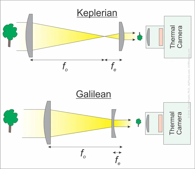

The problem we face with thermal cameras that often have a wide field of view lens is that we either cannot get close enough to the animal for a decent image without disturbing it or we have to image from a distance and you basically waste most of the cameras available pixels as the animal is so small in the scene. Your Tooltop T7 uses a standard Tiny1 core with 3.2mm lens. That provides a 50 degree HFOV that is fine for many tasks. Sadly, unless the wildlife is a large animal, you tend to get a low detail hot spot image when trying to view an animal at a distance.
This is why I was keen to test the Thermal Master T2 Max. The T2 Max is equipped with the sort of large lens normally found on thermal spotting scopes and it makes distance observation of wildlife possible whilst also obtaining more detailed images of wildlife at closer range. I have been able to image wildlife that would have been scared away if I had moved closer to it. The T2 Max lens is 15mm F0.8 and produces impressive distance imagery  :-+ The lens is almost 5 times more powerful than that fitted to the T7 and many other Tiny1 core based cameras. Instead of going cheap and using a higher F number lens, Thermal Master elected to use a large lens with an F number lower than the nominal F1.0 found on many cameras. A good decision. The 15mm F0.8 lens physical size remains manageable and it has a very comfortable feel in the fingers whilst focussing.
I am very impressed with the performance of the T2 Max and testing is ongoing. I am using it on my Motorola G62 Android phone and Apple iPad and it works well on both. I like the large size screen when using the iPad but you need a case with a hand strap on the rear for comfortable use.
Regarding telephoto supplemental lenses for thermal cameras, sadly these are not common or cheap. The construction of a supplemental telephoto lens is much like a refractor telescope and more complex than the simple single element close-up lens setup. In my collection ai have x2 and x3 supplemental telephoto lenses from FLIR, FLUKE, Inframetrics and Torry Pines. They are all expensive and even older lenses are now rare or expensive due to their Germanium scrap value. All of my supplemental telephoto lenses would dwarf your T7 as they are designed for much larger cameras. It is possible to build your own supplemental telephoto lens but it requires experimentation and sourcing some suitable ZnSe lenses (more common than Germanium) Sadly with the available FL lenses, the assembly becomes quite long and unwieldy. Most supplemental telephoto adapters are limited to just X2 or X3 magnification. This is why buying a thermal camera with a powerful long range lens remains the better option for those wishing to observe wildlife at a distance or with more detail at closer ranges.
Fraser

For anyone wishing to make their own supplemental telephoto lens adapter for their camera, there is a very good article on the topic to be found here…..
https://www.instructables.com/Diy-Thermal-Camera-Telephoto-Converter/
