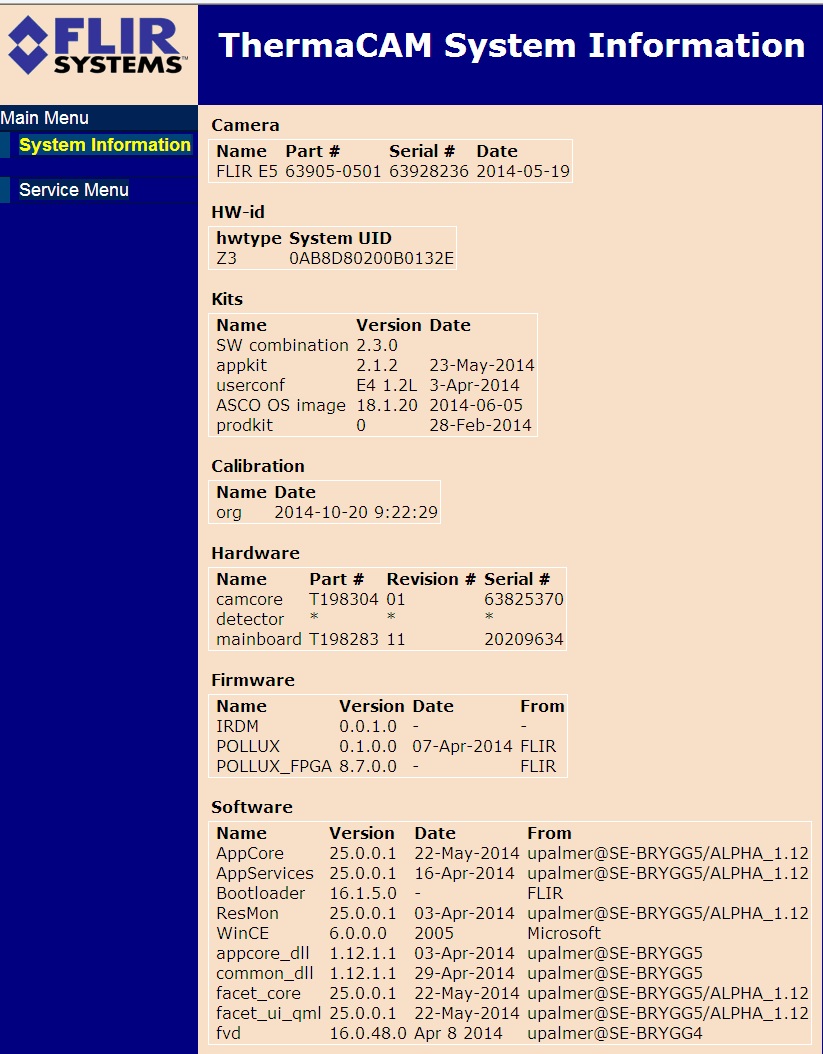

So i bought a broken flir "e5-xt" on ebay.  It turned out to be an older camera in a new flir e5-xt box.  It had the serial number removed from the battery compartment.  I assume it was an amazon return scam.  I am not even sure its a flir e5, maybe the faceplates were swapped as well.
It was broken in a way that it would freeze during startup on the flir logo.  I was still able to get into the file system and it looks like someone tried to install the 3.16 firmware from the newer cameras.  I also discovered a common_dll_org.dll file so it looked like someone tired to upgrade the camera in the past.
I was able to load the 2.3 firmware and the camera started a little more but the screen was all pixelated even the menus.  So i copied over a bunch of files from an older e4 i had, and the camera started up all the way.
Now the camera starts but none of the measurement crosshairs work and there is no thermal MSX option.  The camera also says its a flir e4 but i think its an e5.  This is probably from me copying a bunch of file from my old e4.
I don't know what to do to fix the MSX and the measurment crosshairs.  If someone has some suggestions let me know.

The loss of crosshairs and MSX indicates an invalid configuration so the camera uses a default factory configuration in order to operate for diagnostics. You need to look at the configuration files to see if the serial number matches your camera and the CRC has been correctly calculated. The identity of the Ex series cameras resides in the password protected eeprom so it is unlikely to be anything you have loaded that would change that. Saved images will contain your cameras true identity and you could look in the service menu as well.
Fraser
Thank you, the only configuration file i know is the \FlashFS\system\appcore.d\config.d\conf.cfc is there more then one?
