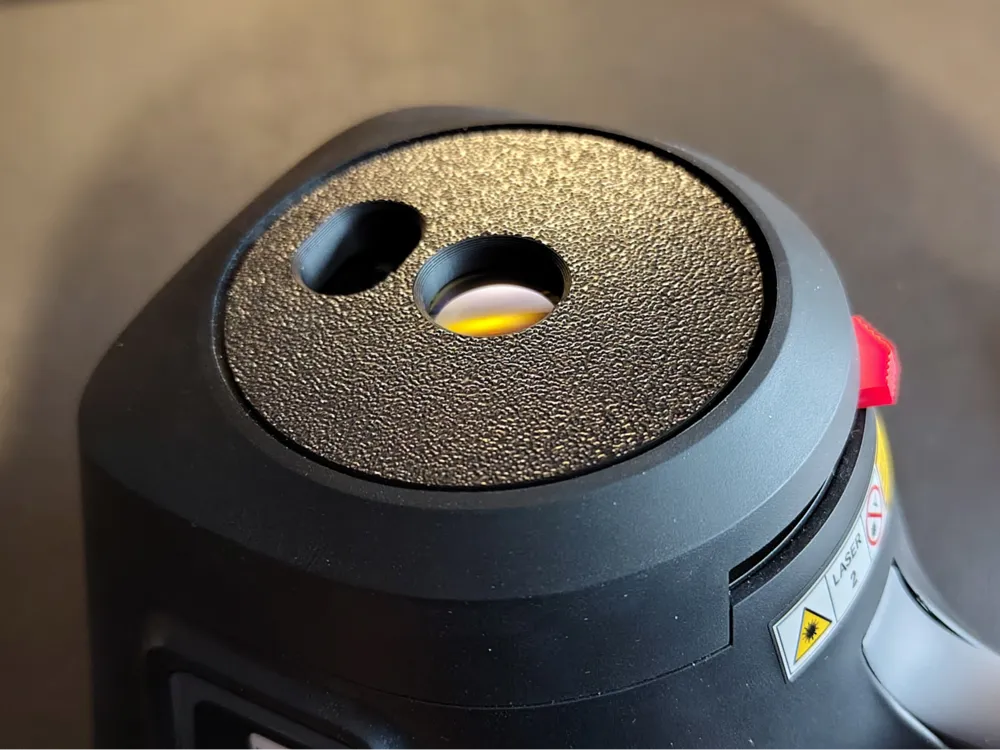

I wanted to share my take on a macro lens holder. I bought a THOR002 back in July mainly because of the initial impressions post by Fraser. It's unfortunate Firmware version 1.2.0 was pulled, I was to late to download it. When I bought the THOR002 I also ordered a ZnSe lens like Fraser in the initial impressions post. Last week I finally took the time to CAD the holder design I had in my head. It simply clamps into the recess of the THOR002. You can find it here. STEP file is included there. I designed it in OnShape. If anyone is interested I'll look into sharing the OnShape file (that would be new to me).

Offline GreyWolfe111
  • Posts: 14
This was my revisit and adjustment of the first simpler design I did.
Cleaned a few things up and took the lens retainer ring from the adjustable barrel model I did.
Yours' win for being simple and sweet. But curious at how well it stays in the face during any rugged handling.
You can see the whole lineup of both the Barrel and Fixed pics here.
https://www.eevblog.com/forum/thermal-imaging/thermal-master-macro-len-3d-printed/
But I doubt the adjustable barrel with the spin ring will be more then a novelty.
It does help extend focusing distance a bit while maintaining the same area viewed (the 63mm test was by about 10%).  It's not a multi element lens zoom macro.
But I don't think that really justifies the added cost and complexity of it.
