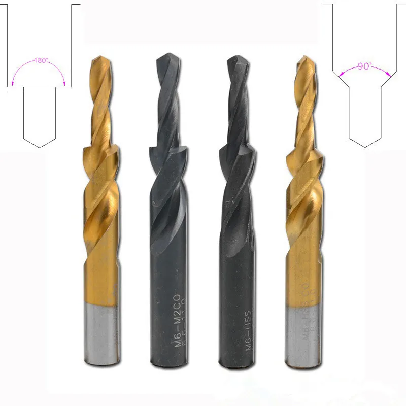

Ok used the Acrylic ones today. Drill vice and everything locked down. After the first one (slight removal of acrylic on the bore) the Guide was then removed and drilled for an easy accurate setup. Much as it is only a cosmetic thing adding another pair for the 8.5mm opening for the bolt heads might be nice too.

Yeah; that's how they get you, the bastards.  >:D The jig kit from the 8020 suppliers has a special drill bit with 180° face and a pilot dowel so it's just a quick zip after drilling the main hole.
Don't get me wrong; it looks good. That's aboot as good as you can possibly get short of doing a plunge-cut on a Bridgeport with an appropriate-diameter end-mill.  :-+

Bit of AliExpress poking around yielded a good result for the counterbore drill M5 (5.5/9.5) TiN coated 180 degree Instead of what I drilled to clear the larger diameter will give a neat clearance for Button Heads due to the 9.5mm major diameter. The 5.5mm minor bore is a touch loose but the 8020 standard one is 5.2mm so not to worried.
Ordered the counterbore drill as it will get a lot of use when I get to my large Laser build. And I will re upload a tweaked set of templates in this post with a 4mm hole as I did a little more thinking (it hurt a lot ;) ) and given it is aluminium skipping the pilot hole and straight to a 5mm hole isn't a real stretch. Turns out the generic automatic punch runs a 4mm pin so easy sorted or grind a point on a 3 or 4mm parallel pin punch :-+
edit zip file below. Anyone Laser cutting it already allows for a 0.17mm Kerf in the files. Also maybe try a triple stack for a flip over single template.
