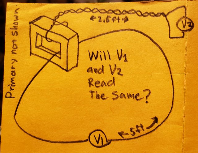

And by the way, I asked you several times and you never answered, but I'd still like to know if you think the following transformer core design sends out an E-Field into space, and if so, what if we wrapped it in a superconductor enclosure:
But anyway, Snedri already admitted that V2 in the below diagram would be suitable for a KVL loop, and he also admitted that V1 and V2 will have the exact same voltage:

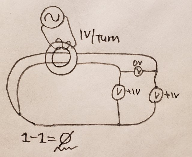

Your probing method inherently subtracts induced voltage from your reading, leaving you with only the ohmic losses.
For example in the below diagram, stretch out the wires so the 3 volt meters are a million miles from the toroid. Two of the meters read 1v and the third still reads zero. It's not because there are zero volts induced, it's because there is one volt induced on each secondary and the difference between 1 and 1 is zero.
You are, buy definition, only measuring ohmic losses, because you are using a method of measuring which specifically subtracts all induced voltage differences.
And besides, KVL specifically requires that all elements have EXACTLY 2 terminals -- so of course when you try to throw in an element with multiple terminals (which is what you have done by running a volt meter lead through the transformer) of course KVL appears to fail because you're using it how it's not meant to work.

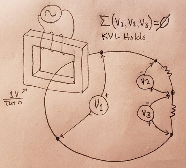

I think we can agree now though that simple 2-terminal closed-magnetic-circuit-core transformer secondary windings work fine as an element in a KVL loop with other components? Or do you still disagree with that?
Are you saying that the electric field produced by a toroidal transformer can induce voltages in other elements in the KVL loop, thus causing KVL to fail?

So at this point can we agree that KVL works fine with a toroidal transformer secondary winding as a two-terminal element in a loop of that plus resistors, like this:
Because all of your "KVL FAILS Proofs" seem to be based on using a two partial turns on an infinite core, can we agree that whole turns on an infinite core work fine with KVL?
