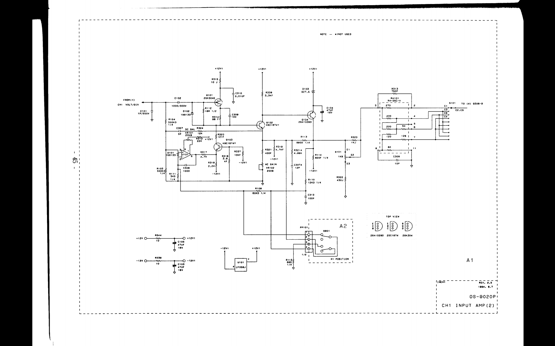

Offline jimmc
  • Posts: 309
Re: Rigol DS1052E Ep#37
« Reply #22 on: October 16, 2009, 10:28:23 pm »
I suspect that there is a discrete component amplifier for the main (HF) signal path and that these amplifiers are used to servo its operating point to ensure DC accuracy.
For an example see the extract from an LG 'scope circuit attached
Jim

« Reply #23 on: October 17, 2009, 01:00:53 am »
That shows up as scrambled lines in my Foxit reader
dave.
Offline charliex
  • Posts: 346
  • Car Hacker
« Reply #24 on: October 17, 2009, 02:10:14 am »
converted it to a rather large png for you. http://www.goth.am/lgcircuit.png
