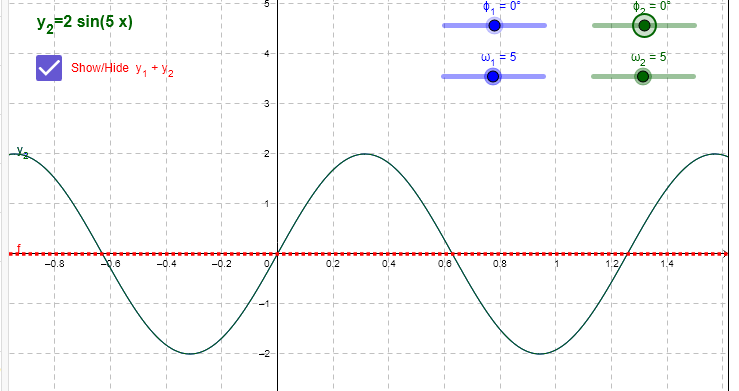

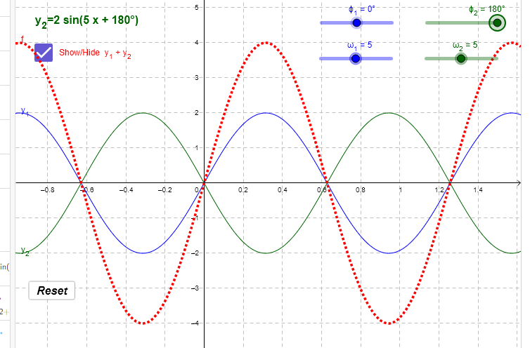

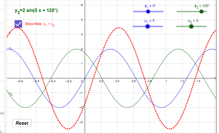

No, two wires does not mean split phase.
The utility company must have two completely separate power-distribution networks, one split-phase, the other 3-phase.
No, it's all three phase.
I don't see how you could derive 2 180°-apart phases from a 3-phase line (0°-120°-240°), which I think is what you were getting at.
Take any two wires from a three phase supply and you get a single phase. You could take a pair of phase wires and get 12.47 kV phase to phase, or you could take one phase wire to ground and get 7.2 kV phase to ground.
The most common arrangement is that each pole pig takes one distribution phase to ground.

So just for my own benefit, is it safe to say that this is how split phase is derived from 2 phases of 3-phase power?
(I only drew 3 lines for the 3-phase part. There's no ground conductor there, is there?)

« Reply #95 on: September 29, 2026, 01:36:44 am »
