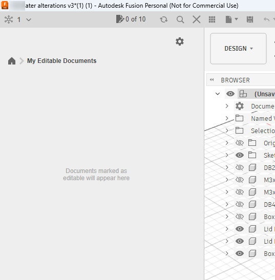

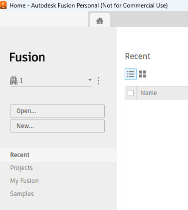

After following ebastler's URL etc I no longer get the R/O problem.
This is what I see before opening any file
and this is what I see after loading one f3d file from the computer and clicking on the 3x3 icon
It all looks as I would expect.
