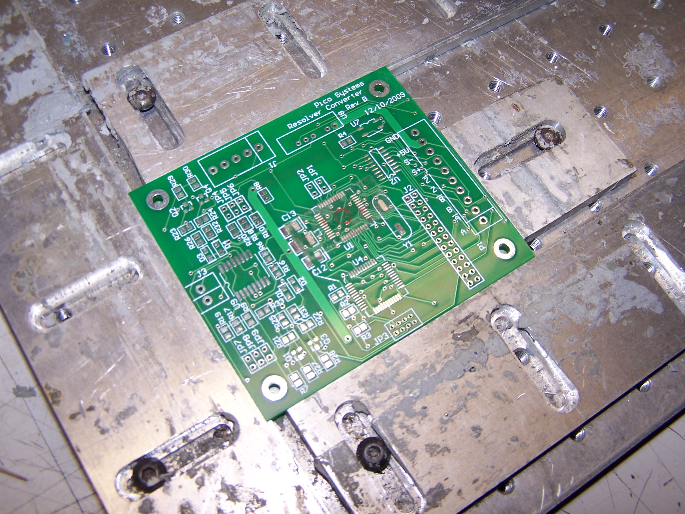

I made my own stencil frame, see :  http://pico-systems.com/images/StencilFrame.JPG
and http://pico-systems.com/images/Stencil.JPG  I now have added a hinge to the back to use framed stencils.
Jon

My fixture (link to pictures in reply # 14) holds the board from the edges, as I often do dual-sided assembly.  For larger boards I put a small stack of washers under the middle of the board to prevent it from deflecting.  That has always worked well.
Jon
