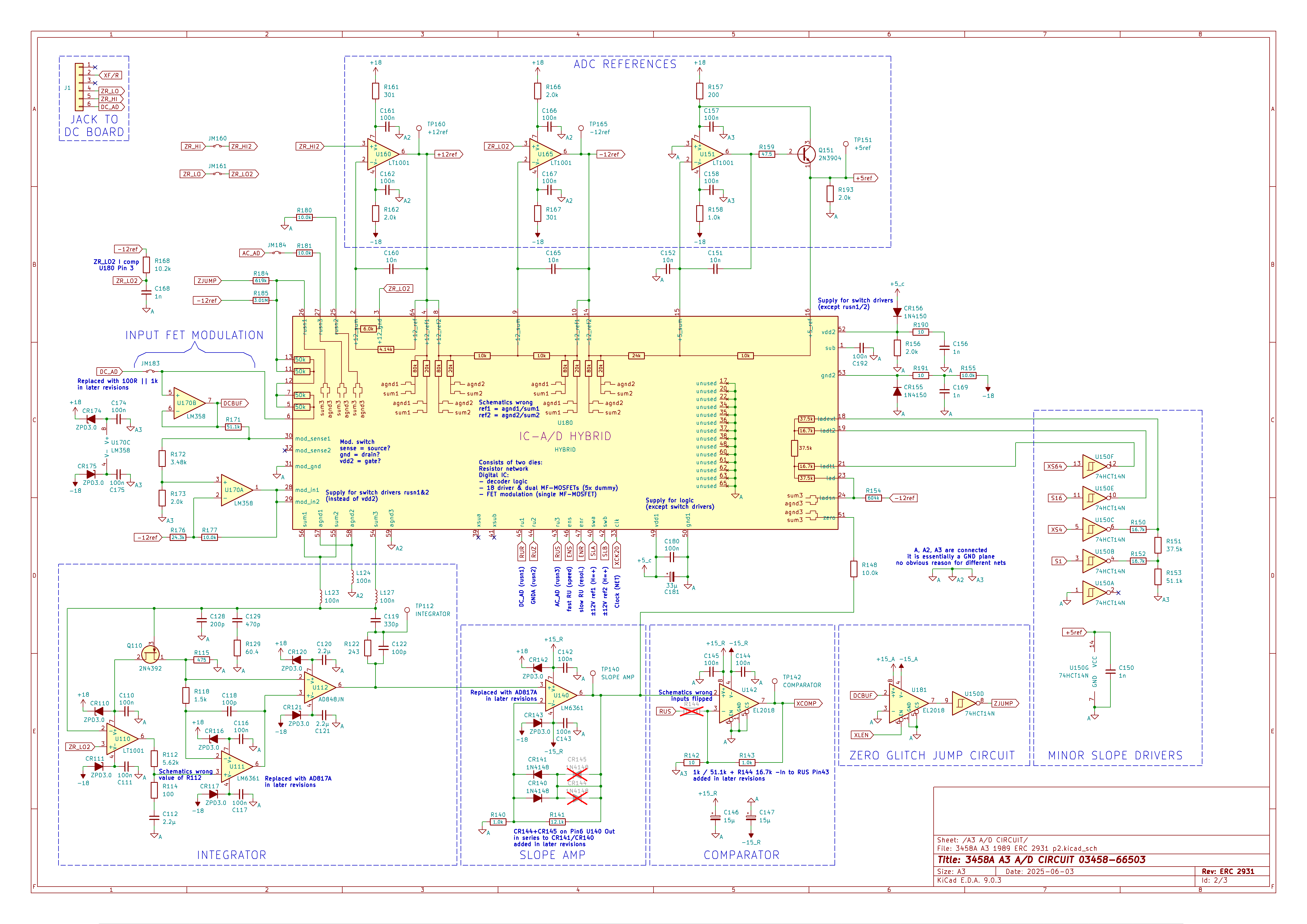

Follow-up on adventure for improving noise.
Replacing +12Vref amp U160 with ADA4522 was disappointing, no significant change.
There is little chance that replacing -12Vref amp U165 with ADA4522 will change something, let alone 5Vref amp U151.
Keep in mind that there is a scaling factor of 1.06 from ADR1000 to LTZ1000.
In comparison to earlier plots, all measurements are linear drift corrected to accomodate for self-discharge in the LiIon cells for 10.6V, that gives the characteristic down slope at the end of the ADEV plots.
« Last Edit: April 06, 2025, 06:39:56 pm by MiDi »

« Reply #56 on: April 07, 2025, 05:20:46 am »
Thank you for the great documentation of your investigations.
You should have seen a 2-3x reduction in noise in the 100-1000 second range with the ADA4522 chopper opamp.
I use one of my Z10 prototype Voltage Standards when I do the 10V stability test. It has shown 3nV stability over a day when Air pressure and Linear drift affects are removed.
I could only get good Zero stability results by using a simple copper wire short or a gold-plated PCB shorting the input terminals. One shorting plug with gold plated banana jacks had noticeably higher thermal emf and Zero instability.
I have modified 3 units now with good results. There are a few other subtle things I do when modifying the units. I have not quantified these improvements. We are dealing with nanovolt stability over hours.
To minimize noise from thermal EMF, I minimize the A1 shielded enclosure airflow. I close off any openings at the aft end, near the fan, with tape. There are a few holes back there and there are gaps where wiring leaves the plastic shield around the power supply area. I have not noticed a change in compartment temperature by doing this.
On the A3 module I use small cotton balls around the +-12v Opamp and the first comparator. This minimizes any random airflow in this area especially with the DIP to SOIC adapters needed for the newer opamp. On one unit I put cotton balls on the back side of the pcb to also cover the pcb pins and the U180 pins. I pull the cotton balls apart to fluff them up a little.
Do not block the cooling of the EL2018 comparators. They already run hot as it is.
All the pcb mounting screws on A1 and A3 modules need to be tight. Do not break anything but they need to be snug with no missing screws. I expect HP to have a torque spec for these screws somewhere. These screws supply critical grounding for the HP3458A pcbs. Screws made from different metal are not allowed.
With chopper Opamps I add a C0G capacitor between the non-inverting input to chip power ground. I do this on the SOIC adapter pcb. This will minimize current spikes getting into the circuitry.
The parts list for the A3 module specifies 10nF AVX X7R capacitors (AVX PN SA101C…) for the opamp feedback. An X7R capacitor can have 10x the current noise of a good C0G cap. These are C160, C165, C151 and C152. I have removed some of these capacitors by clipping them off the pcb and testing them. Based on leakage current noise they appear to be C0G caps. HP made several different A3 versions over the years. I cannot guarantee what type of capacitor is on your PCB. I replaced the critical 10nf feedback caps with TDK 10nf 100V C0G parts so I know I have the best.
NOTE: If you want to test an X7R capacitor do not unsolder it from the pcb, clip it out. The Heat from unsoldering may change the X7R capacitor characteristics like aging and leakage current.
As I am sure you know, there are several better chopper Opamp than the ADA4522. Below 0.1 Hz the ADA4522 voltage noise density starts to rise like a normal opamp. It still should have 10x less noise than a Bipolar LT1001 opamp at the longer time scales (100-1000 seconds).
The ADA4523, OPA182 and the OPA189 have flat noise spectrums out to 1000 seconds.
On the A3 module I have successfully tested the -
OPA210 Super Beta 2nV Bipolar Opamp, 5x less noise than the LT1001 and lower bias current.
OPA182 5nV chopper (low power OPA189), OPA189 5nV chopper, ADA4523 4nV chopper.
I not have noticed any strange operation over the last year from chopper clock noise interacting with the A3 sampling frequency.
I have also tested the choppers and the Super Beta Opamp in the U110 First comparator location with no noticeable issues.
I changed the U170 opamp (DCBUF) from an LM358 to a OPA2140 for much better bias current stability (1000x), faster operation (faster settling, lower output Z), and better DC specifications.
Good luck!

The possibly changes to the 3458 ADC are somewhat limited, as the core U180 and logic is fixed.
So the possible improvements are really limited. I did some math on the noise source for the 1 PLC AZ case. There are a few parts with estimated paramters, but the rough size should be about right, maybe a bit more jitter.
Form this the largest noise source with there contribution (need to add up as squares - so the large ine really matter and the small one less)
1) the 50K+40 K resistors at the integrator:    306 nV
2) 150 kHz band ref. noise                           ~190 nV ,  unclear how noisy the ref. actually is at that high frequncy, The ADR1000 can already help here
3) U110 (integrator)                                      184 nV
4) jitter in U180 and U131                           ~ 150 nV    assumes 1 ps RMS jitter
5) U165 and the 10 K resistors there               144 nV
6) reset noise from switch capacitance          ~ 120 nV  assume 10 pF
7) front end protection                                    90 nV
8 ) quantization noise                                       59 nV
Even when measuring -11 V and thus mainly using the positive reference the zero reading in the AZ cycle still has both signs about half the time.
When changing U110 one may also have to adjust R112/ R114 for a likely higher BW of the replacement.
To a large part I would consider the ADC noise to be at it's limits.
The following users thanked this post: branadic, chuckb, MiDi, Okertime

Attached are some photos from my mods. I got a little carried away with the cotton in the one picture. I usually have about half of that.
My 1st gen A9 QVR has a combination of 3D printer cover, cotton and Kapton to minimize air drafts. The 4 ADR1000s have 50 ohm current setting resistors and a 12.5k temperature setting resistor (66 deg C).
This one has stopped drifting after 18 months. The other two QVRs are still drifting several ppm / year. I recalibrate them to my Wavetek 4911s or Z10s when needed.
My machines run 24/7 doing various testing so I have not seen a voltage shift with extended power off. I may be able to test that this month.
The new Opamps for the A3 mod are on SMT adapter pcbs plugged into gold plated machined pin sockets.
I'm building a dual ADR1000 A9 board now from TiN. This design does not require any modifications to the A1 PCB.
With a high current QVR and choppers in A3 I may have reached a flicker noise floor for the A3 ADC.
     Better 20MHz oscillators did not help.
     The performance limit may be Excess Noise in the U180 resistors. Some of the main resistors have 7V across them. An excess noise index of -50dB (very very good) would yield the 40nV noise floor that I am seeing.
Next areas -
1. Reduce the noise of the Internal +-10V reference with a better Opamp (U400). I believe these voltages are used as internal transfer standards during ACAL and for resistance measurements.  Replacing the LT1013 with an OPA2182 chopper will reduce the internal reference voltage noise 4-5x.
2. A small heater to hold U180 at a constant temperature. U180 should be able to be controller to 0.01 deg C. See photo. A small heater pcb is attached to a chunk of aluminum. U180 temperature sensing is from a thermistor in the hole in the middle of the aluminum heat spreader.
   Concept -
A very small processor would control the heater. The heater is sized to provide a maximum of 10 deg C temperature rise. At startup the heater goes to 50% power for a 5 deg C temp rise of U180. After 2-3 hours the processor notes the temperature and starts controlling to that. Then the temperature of U180 will be held steady as ambient changes +-5 deg C. If the heater control reaches an edge, change the setpoint 2C up or down as needed and keep controlling.
3. Take a very low noise 7.14V from the Z10 Voltage standard (2-3nV noise level) and use that in place of the A9 module. Find the ultimate limits of the A3 ADC in the HP3458A.
The white noise limit of the A3 is pretty much fixed by design but I think there may be room to improve the flicker noise floor and the temperature stability.
Should be fun.

Some updates on modding my A3 for lower noise.
The next mod was replacing +5ref amp U151 with ADA4522 and fet modulation U170 with OPA2206.
Unfortunately this did not work, the noise went up dramatically.
Simulation showed that with ADA4522 and the additional BJT Q151 at the output it is at the edge of stability - even with original LT1001 not that good.
As C151 & C152 had to be changed anyway, it was a good opportunity to test if it makes any difference with more filtering on all ref amps.
C160, C165, C152 were replaced with 10µF film and an additional capacitor between +5ref and +5sum added, C151 replaced with 150nF.
The last mod was replacing the first integrator stage U110 with OPA205.
4W Short:
FS (10.6V 3xLiIon):
For the last mod there is currently no data available.
Overall the improvements are only for short time intervals for this rather noisy A3, but the TC did improve - more on that in a later post.
The improvements are likely from more filtering of noisy -12ref 2x10k divider.
The comparison of positive and negative FS showed a significant difference in noise between 0.1 to 20Hz, which was confirmed by quick bodge with external 2x10k divider.
Noise bump from -12ref divider comparison to other units:
« Last Edit: December 21, 2025, 03:34:40 pm by MiDi »
The following users thanked this post: Dr. Frank, Okertime
Offline Kleinstein
  • Posts: 16342
Re: 3458A Worklog
« Reply #71 on: December 21, 2025, 05:12:58 pm »
U170 (input buffer and driver for input switch supply) may see capacitive loading. If stability there is an issue, the OPA2202 could be an option: it is more tolerant to capacitive load (could even add some 5 or 10 nF) for the switch supply.
The OPA202 would also be a candidate for U151. The effect from U151 is still expected to be small as this part should only be active during run_down. C152 is slowing down U151 and it should not be a good idea to increase this capacitor.
When changing U110 to a faster amplifier one may have to increase R112 to get the same response. Othewise one may get some extra INL from additional response to some lower frequency parts (~ 2 kHz) close to some critical voltages (e.g. 7.5 V).
The change in the OP-amp would definitely be a point that could give a little improvement. The improvement could be more significant at 10 PLC than 1 PLC as the new OP-amp may well have less 1/f noise.
C160 / C165 are not just filtering the little noise from the 10 K resistors. They also filter the noise from the LTZ1000 to some degree. The ADC does react to some of the higher frequence reference noise. Here the original 10 nF capacitors should alread supress most, but maybe not all. A possible point worth testing could be filtering of the reference before U160, at least for the rather fast part.
At least in my unit U170 has a problem that the OPA2206 should solve:
The input exceeds the supply rails by up to 3V during input switching in A1 and LM358 responds with a long recovery time - see: https://www.eevblog.com/forum/metrology/3458a-worklog/msg5870289/#msg5870289 & https://www.eevblog.com/forum/metrology/3458a-worklog/msg5871583/#msg5871583
Have not recognized any problems with OPA2206 so far.
Increasing C152 of +5ref amp is counterintuitive for me too, but simulation shows good response and stability for the values used and it works good in circuit.
If there is a problem with OPA205 for U110 w/o increasing R112, why would that only effect INL (at critical voltage) and not noise?
In my very limited understanding, R112 & R114 reduces the AC gain to maintain stability of the integrator.
FYI: the CLIP has wrong value for R112 in schematic, it is 5.62k (not 33.2k, CLIP BOM is correct and verified against all known A3 revisions), R114 is 100R.
