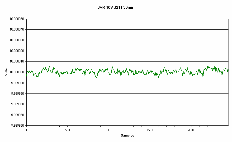

« Reply #50 on: October 15, 2015, 09:22:04 pm »
Well, my two prototypes (5V with U440 and 10V with J211) are running nicely and manage to stay inside +/-10ppm range at a somewhat varying room temperature, without any obvious drift. I am waiting for some high stability wire-wound and bulk foil resistors to be delivered so I can start building a "superstable" version, where all influences except that only of a JFET itself would be below 1ppm/C. The aim is to get a stability better than +/-10ppm in 20-30C temperature range (or better than 2ppm/C) without temperature stabilisation and then check the long-term drift for 1000h with a temperature log.
Cheers
Alex
P.S. - here is a 30min run on the bench of a somewhat "fine tuned" version on J211 device. Vertical scale 1ppm/div, Keithley 2015 works with a 10x averaging filter at NPLC10 to reduce the noise.

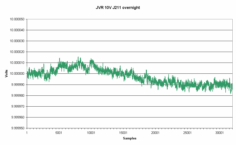

Re: Building your own voltage reference - the JVR
« Reply #52 on: October 16, 2015, 06:47:49 am »
Overnight (from 12am till 6am, in open air), 1ppm/div:
Cheers
Alex

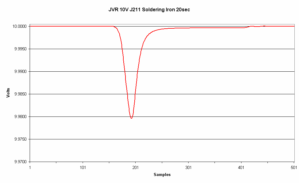

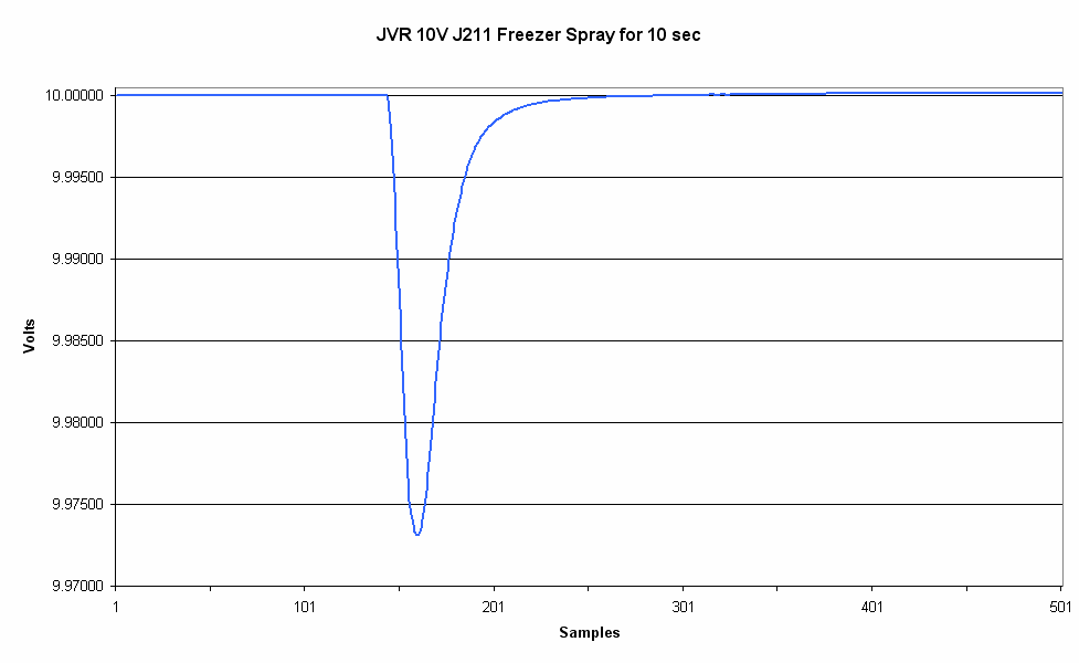

« Reply #58 on: October 16, 2015, 07:22:06 pm »
OK, Friday night - a torture night  >:D . As the J211 version runs rather well and I am still waiting for the bits to build a controlled temperature chamber, I've decided to torture the JVR on record, first with a freezer spray for 10sec (about -50C or 70 degrees drop), then with a soldering iron for 20 seconds flat on the plastic case of JFET (I would estimate it as at least 70 degrees rise). Unlike the U440 in a metal case, some hysteresis is clearly visible, about +20ppm after the cold session and about -30ppm after the hot one. Here I have to note that the freezer session was not the first and on the first session I didn't freeze the FET so deeply, however the hysteresis was more - about 50ppm. Clearly for a stable reference a metal case is much better. (A note - the "wave" on the second graph after 400 samples is just me adjusting the voltage back to 10.00000 Volts).
Otherwise it is clear from the graphs that in both cases the voltage drops about 0.2-0.25% or 2000-2500ppm for 70-75 degrees change, so at 23C the reference sits nicely on the very top of the curve and has the lowest possible tempco. With a metal case and the temperature stabilised around, say, 45-50C (and the tempco adjusted for zero at that temperature), the stability should be very good.
Cheers
Alex
Each record is about 6min long:
« Last Edit: October 16, 2015, 07:51:57 pm by Alex Nikitin »

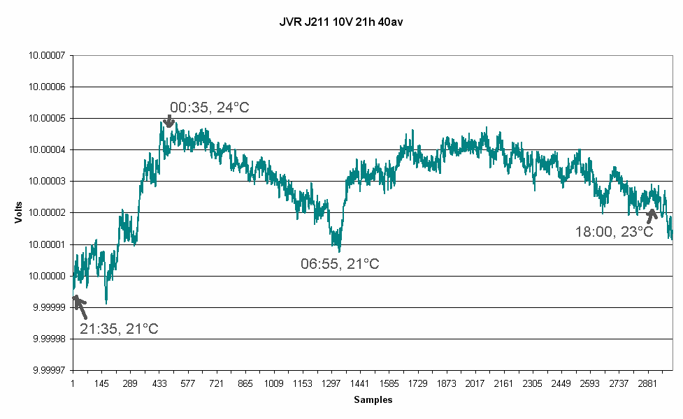

« Reply #63 on: October 21, 2015, 06:20:29 pm »
While I am waiting for the Fluke and resistors, here is a 21 hours run of the same 10V version using J211. The Keithley 2015 runs with 40 averaging, vertical scale is 1ppm/div. I've noted the room temperature at some time points. It looks like the TC around 23C is ~2ppm/C  8) .
Cheers
Alex
« Reply #64 on: October 22, 2015, 04:42:05 am »
The TC of the Keithley (according to datasheet) or of the JVR?
With best regards
Andreas
Offline Alex NikitinTopic starter
  • Posts: 1568
  • Femtoampnut and Tapehead.
    • A.N.T. Audio
« Reply #65 on: October 22, 2015, 07:31:13 am »
With best regards
Andreas
Hi Andreas,
Your guess is as good as mine - the Keithley TC, noise and drift all included! The only possible clue is that the "fast" changes are more likely to be that of the JVR itself due to the air movements. As you may see there are variations in the evening when I was moving around the lab and in the morning hour when I was preparing to go to work, while at night and during the day there was very little air movement and the changes are more gradual and uniform. I hope that the Fluke 731B will provide me with a more stable reference than the 2015s (I'm running two in parallel though recording only one - and the difference between two 2015 varies from 4 to 6ppm). I plan to record the Fluke against 2015s after a good warm-up and then record the difference between the Fluke and the JVR. I also plan to build the "ultimate" 10V JVR using U440 and a Vishay Foil resistor divider for the 5 to 10V step up.
Cheers
Alex
« Last Edit: October 22, 2015, 07:41:16 am by Alex Nikitin »

« Reply #74 on: October 28, 2015, 11:25:31 pm »
Two more graphs, taken at NPLC1, no filtering, for 30 minutes. The room temperature was about 24.5C, the JVR is still in open air on the bench. I was hoping to compare the noise, however the noise in the graphs is completely dominated by the noise of Keithley 2015  :( .
Cheers
Alex
