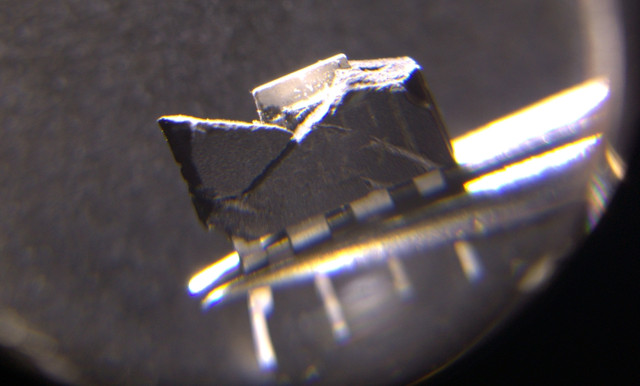

a a while ago analog did plastic package with cavity over crystal as soic8 package,  comparing to regular soic8 they was a thicker
for plastic DIP8  i don't remember such thing. so the problem of plastic it transfer any forces to crystal , and that caused voltage shift...
so i try to mitigate , hook chip on flex wire, dry chip for 30 hours ( 120C) use a glass bottle with oil submerge it,  use a thermal chamber for constant temp.
combine all 3 options after 1 year of settling, let say, i got around 6 PPM for 6 month period voltage shift.  I cant say it may shift more, as my measurement was periodic. as well i have no idea what possible affect this shift as much as i can to try eliminate mechanical,  humidity and temperature shift.  Much possible i think, it a chip itself , non select ,reclaimed , made 1987
