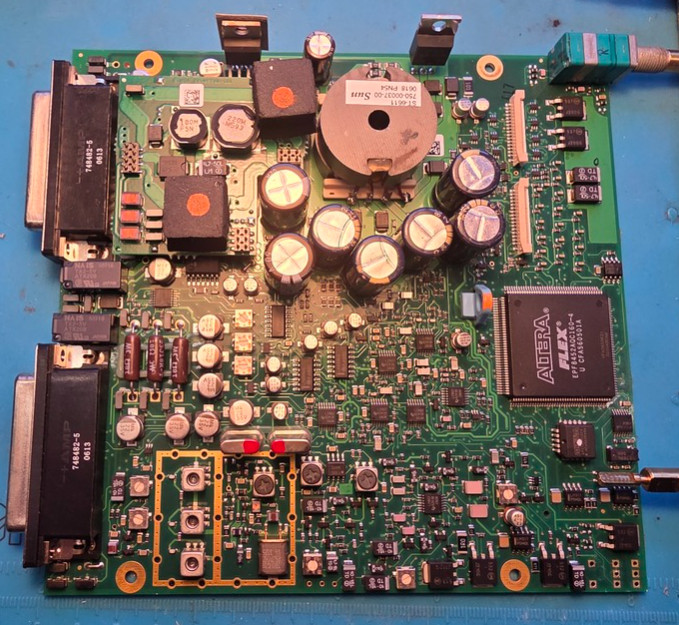

« on: August 15, 2026, 08:00:34 am »
Does anyone here work in this field?
When I look at some internals, I see some bizzarre stuff e.g. an FPGA being used to implement a really trivial function which would normally be done by a tiny CPU.
I've also heard that the certification authority has been known to require a file for each function, otherwise recertifying changes is much harder.
This is from a 2004 aircraft intercom where an FPGA is completely ridiculous and always was
Admittedly in those days FPGAs were high fashion :) I did a lot of FPGA work back then so know how it works.
One thing I've heard is that just different standards are applicable. It may be easier to prove deterministicity and isochronicity on an FPGA.
For sure getting something big built around an RTOS is going to be much much harder.

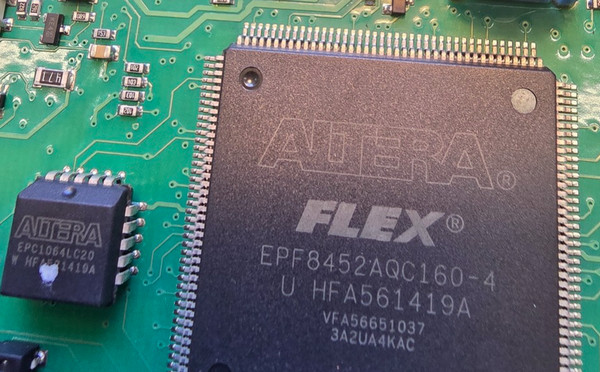

It is most likely that the intercom was originally an existing design with all TTL logic and the goal was just to perfectly replicate and shrink the existing approved design to a single IC with an additional degree of room for correction logic if needed.
The Altera Flex is a small FPGA and that early Quartus compiler had a GUI IDE with all the 74LSxxx components built into its layout library.  All the engineer had to do was copy the schematic exactly and the compiler would spit out a FPGA matching the schematic function perfectly.

It won't be radiation. This is a GMA340 GA (general aviation) product, probably max certification altitude 20,000ft.
The function is an audio panel (an intercom in unfashionable terminology) which has a load of inputs e.g. mikes, line level inputs, loads of outputs e.g. headset speakers, a few-watts ceiling speaker, an RF section for ILS marker beacon receiving, and a front panel with a load of buttons and switches. Then it has some relays for signal switching.
I would expect the logic to be static (not clocked) and implement a combinatorial circuit, switching outputs based on front panel selections, with some priorities implemented. Probably 100 lines in an AVR.
This one is by Garmin. PS Engineering make a lot of very similar ones. These products are all a tour de force in how many discrete components can be thrown on a PCB :) An interesting angle is that Garmin bought a competitor called UPS Aviation Tech which had managed to get FAA to let them do certification internally (subject to some auditing) and Garmin bought UPSAT to get this concession (and basically shut UPSAT down almost right away :) ). So Garmin don't need to demonstrate compliance to an outside body - within certain limits.
4000 series CMOS will go on forever.
Big FPGAs are a different thing I am sure. This is a very simple case. I just don't "get" an FPGA here, especially given their relatively limited production life and with the little EPC1064 configuration memory chip having to be - like the Xilinx ones from that era - programmed in a programmer (not on-PCB in those days) and then issued to the assembly line. Conceivably it could be in-circuit programmed via JTAG...
