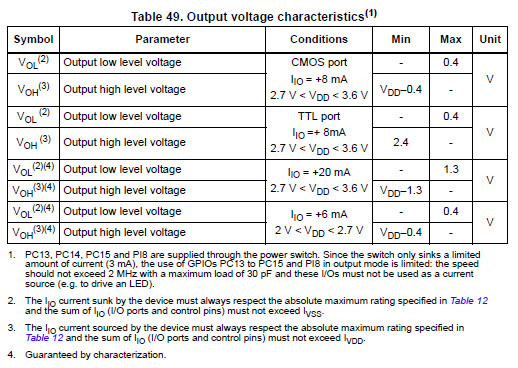

What I've done is make an estimation of the output impedance of the driver pin. I do this by looking up the datasheet drive strength at a given voltage drop. R=U/I even at exotic frequencies, so say a pin drops 0.6V at 12mA, then its output impedance is 50Ohms.
For STM32F407; it actually specifies them as VSS+0.4V / VDD-0.4V  @ 8mA, and VSS+1.3V / VDD-1.3V @ 20mA
So thats 50-65Ohm's (some non-linear behaviour as its a FET).
Then I calculate the characteristic impedance of the PCB traces (often microstrip). This indeed needs the trace width, copper thickness, layer prepreg thickness and permittivity of the core/prepreg material. Lets say a 0.2mm trace gives you a characteristic (single ended) impedance of 70 Ohms.
Then you want the source (the 50Ohm GPIO) to match the PCB transmission line of 70Ohms. With source matching, you add a 20R resistor to match it to the 70Ohm transmission line. At DC it should not matter because its still an "open circuit".. (unless you terminate at the destination but that burns a lot of power)
I think you refer to this table
It is interesting that they do not spec different values for different pin "speeds" which suggests that the "speed" does not really change Rds(on). Or maybe it does and they just picked the highest "speed" setting.
75 ohm works out at roughly 0.005" track. For 50 ohms it would be around 0.010". But another variable is that I am using a 2mm FR4 material, not 1.6mm, and 6 layer, so I need to work this out properly, because some of the layer thicknesses vary greatly. The likely stack-up will be the 2 planes in the middle and the 4 signal layers on the outside, but I can choose the SPI signals between the two layers, to minimise radiation. I have the Saturn PCB toolkit.

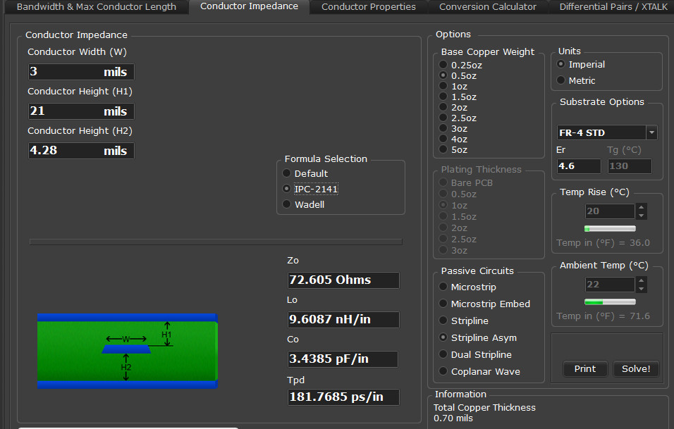

Taking that table in the 32F4xx DS, one gets about 50 ohms, so adding my 22R resistor gives 72 ohms for Zout, and that is achievable on the very assymetric JLC stackup where you have 0.55mm one side and 0.1mm the other side (putting the SPI tracks as the only signal layer between the two planes).
If one were looking at say 80 ohms then the track width becomes too thin (for FR4).
This is probably overkill for what I am doing :) but I want to do it as best as I can given that I have a choice.
Using the Saturn software, 0.003" gives 72 ohms but that is very thin for manufacture.
0.004" gives 64 ohms.
But also the typical Rds(on) is going to be lower than the worst case DS spec, so this difference is in the right direction.

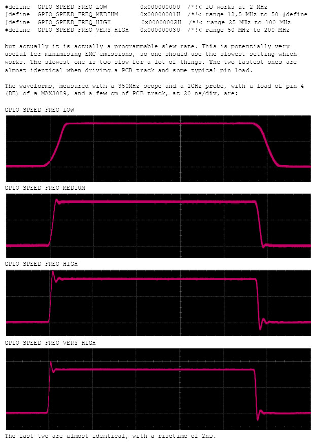

I did a test a while ago and got this data:

Offline Siwastaja
  • Posts: 11230
Re: Best way to run and terminate SPI (32F4xx)
« Reply #16 on: August 30, 2026, 06:50:18 am »
One thing you could add to the test is to keep VERY_HIGH or HIGH, and add a series resistor of 33R close to the driving source. Adjust the R until the ringing is just barely gone.
And take the measurement always from the receiving pin!
My hypothesis is that by adjusting R optimally, you almost get the benefits of both: lack of ringing combined with nearly the edge rate of the VERY_HIGH/HIGH. IO pin slew control isn't a replacement for termination.
And series (source) termination is the right shape for unidirectional, single driver, single receiver configuration. The caveat is that the signal is well-defined only at exactly the receiving pin (so you need to probe there).
Biggest challenge in probing is the ground clip. You need to use the springy little thing and even that won't be 100% perfect.
GPIO_SPEED_FREQ_LOW looks OK to me for 20 MHz clock. It has less than 10 ns rise/fall times. The slow edges may introduce a small skew between CLK and MOSI because the receiving pins may have different thresholds, but this is a few ns at most, which should be fine unless the slave requires large setup/hold. This will also increases MISO delays by a few ns because the slave will receive the clock later. If slave delays are too long, it will not work. It would be easy to fix if your SPI module had a late sample feature, but I don't think it does. For that reason the slowest speed might be unacceptable.
GPIO_SPEED_FREQ_MEDIUM produces a very small overshoot and practically no riging. Since it has faster edges, it will reduce MISO delays (compared to low speed). It might be the best in this situation.
GPIO_SPEED_FREQ_HIGH and GPIO_SPEED_FREQ_VERY_HIGH produce somewhat larger overshoot and no measurable benefits compared to medium.
But the results would depend on many factors, such as receiver capacitance, not to mention the capacitance of your probe.

I don't think you need resistors on the output lines. The STM32 pins have 4 settings with different driver impedance. The slowest one will probably be too much impedance already, so you will be able to over-dump the line without external resistors.
The variable IO settings are definitely worth using, and might eliminate any need for series termination at all. Depends on a variety of things like the bus length, clock period, setup and hold times, etc. Personally I'm always in the habit of putting an 0402 series termination resistor at every clock output (SPI, I2C, oscillators, etc). Sometimes they're not necessary, but when they are I'm glad I put it there.
