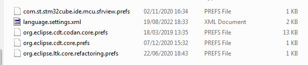

I tend to end up with this "split" affair.
I tested and it seems the cube projects are pretty clean, I left the .settings/ folder behind everything else was needed.   As a top tip, create your own code style file and add it to the repo, then nobody has an excuse for horror merges.

My .settings directory contains
which suggests all but one are fossils, and the one contains
<?xml version="1.0" encoding="UTF-8" standalone="no"?>
<project>
<configuration id="com.st.stm32cube.ide.mcu.gnu.managedbuild.config.exe.debug.346995266" name="Debug">
<extension point="org.eclipse.cdt.core.LanguageSettingsProvider">
<provider copy-of="extension" id="org.eclipse.cdt.ui.UserLanguageSettingsProvider"/>
<provider-reference id="org.eclipse.cdt.core.ReferencedProjectsLanguageSettingsProvider" ref="shared-provider"/>
<provider-reference id="org.eclipse.cdt.managedbuilder.core.MBSLanguageSettingsProvider" ref="shared-provider"/>
<provider class="com.st.stm32cube.ide.mcu.toolchain.armnone.setup.CrossBuiltinSpecsDetector" console="false" env-hash="-1504631925663965107" id="com.st.stm32cube.ide.mcu.toolchain.armnone.setup.CrossBuiltinSpecsDetector" keep-relative-paths="false" name="MCU ARM GCC Built-in Compiler Settings" parameter="${COMMAND} ${FLAGS} -E -P -v -dD &quot;${INPUTS}&quot;" prefer-non-shared="true">
<language-scope id="org.eclipse.cdt.core.gcc"/>
<language-scope id="org.eclipse.cdt.core.g++"/>
</provider>
</extension>
</configuration>
</project>
and I have no idea what that is about :)
I looks like it's configuring an STM32 extension relating to C/C++.
The important part is it doesn't contain any absolute paths.  As I left it behind, I expect it will recreate it or I'll find an extension failed somewhere.  It's usually the .settings/ folders which trigger extensions and plugins and cause issues importing between IDEs.
It's usually only the first few weeks in a project there are issues sorting out the git repo and every ones different choice of IDE.  Usually various version/variants of eclipse and InteliJ, although I tend to edit some files outside eclipse in vim as I'm usually making immediately and small changes to a DB script I immediately have to commit, push, login, build and deploy to run.  Remembering to keep the three or four repos in sync is just a penalty of working in a high secure environment where your only point of contact outside your dev machine is through BitBucket and some heavily restricted web front ends.
Anyway.  It looks like Cube's projects are fairly clean.  You might have teething troubles between different versions of Cube IDE, but it should be fine.
Leave the workspace folder to eclipse.  Consider it almost ephemeral.  If/when it gets corrupted or Eclipse needs upgraded, it's often better to just fresh install it in a fresh empty workspace and import your projects.  Protect that hierarchy, forget the workspace.

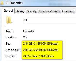

Unfortunately, that approach is ridiculous in the requirement for a whole new level of PC software architecture knowledge.
Cube is an application (a "program") which should start up and run as one expects. Even just the need for this
24 thousand files!
shows how far the "art of programming" has come. Who can ship an install package which dumps 24000 files to your PC?
Admittedly this includes the ST libraries but still... ???

24 thousand files!
It is most likely the source code for the libraries, including all the comments, the headers, the documentation, the firmware (debug archives of with symbols etc.).  (As an aside I remember making my first Linux boot disc from source code.  I laughed when I seen the "mini" GLibc came out at 87Mb.  A quick google and "lightbulb".  "strip" to remove unnecessary text symbol and all the locale stubs etc. etc. and one 400k so.
I'm not justifying the bloat, but it's real.  Disk space is cheap.  Engineers are expensive.  It is probably, for example, far, far easier to manage sending you a complete, full set of everything, for every board you open a project for, when they only differ by 2% of files, than to manage sending you ways to layer/overlay etc.  Trust me.  I've been there using sparse hierarchical build repos.  You don't want to go there.  It's better to duplicate and buy a bigger disc.
It's funny how code reuse has multiplied the amount of code we write by a factor of over 1000.  (I can find a source for that, but it's a bit hyperb-ollox ;)).
Also, if your install is older than about a year.  I would make a fresh install of the IDE.  A clean workspace and only import the projects you are working on.
All of the above "blobs" of files for each board class, will also be "per version" and I doubt they delete the old ones.

24 thousand files!
I was going to say that was the cause, but decided to check.
Now, not so sure about it.
My STM32CubeF7* directory contains by itself:
31 805 Files, 7 477 Folders
I don't have the STM32CubeIDE installed, but taking my MCUxpresso (NXP equivalent, just as hideous🤮) install:
19 652 Files, 2 067 Folders
So, not far from peter-h result with STM32CubeIDE.
Note that this install includes zipped SDKs for some MCUs, but they are one zip file per MCU, so just a drop in the ocean.
Actual SDKs are elsewhere.
As a point of comparison, my VS Code, excluding extensions:
1 175 Files, 474 Folders
Pretty lean, one would think, until they look at the extensions directory (I may have far too many...):
39 077 Files, 6 422 Folders(might include some caching and DBs)
Full Visual Studio 2022 (CE):
33 409 Files, 4 465 FoldersThis might include some Windows SDK, though.

Unfortunately parts of CubeMX IDE get really upset about network paths.  Unzipping firmware for example causes it issues.  Building projects from the already unzipped firmware on network drives produces partially built projects.
This is not uncommon in windows apps, "network drives" are not as transparent as they should be at times.  It's not just build timestamps which can be taken care of, it's something odd about how some applications/APIs handle file transactions which causes them to get corrupted on a network drive.
It's odd as it's fine with the workspace on a network drive, but not it's firmware folder.
The reason this is important to me is that SSD space is expensive.  Things like multi-giga byte firmware template archives have no place on local or virtual SSDs.  They go on cheap bulk spinning metal.  Seems I might not have a choice.  I'm going to try and hide the network-ness of the drive by mapping it through a Windows library folder like C:\Documents but I expect that will probably fail and write straight through the library reference to the C:\Documents physical folder anyway.
The other option of course, as network bandwidth is cheap, is to just delete the contents of the repo and re-download it all when I run MX.  Sounds tedious.
I suppose I could use a new SSD anyway.
EDIT:  On corruption while unzipping and file transactions.  A likely culprit is case sensitivity or lack of it.  I have seen cases where applications, from windows writes two different files,  say, "File1" and also "file1", the underlying linux filesystem is like "Okay.", but when Windows asks for "File1" expecting "file1" things go very wrong.
