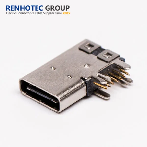

Do you have an recommondation for a USB 2.0 type C connector?
Is there any defacto standard on a footprint, that is used by multiple manufacturers?
So far I only found connectors with different footprints and that sucks, if that specific part is out of stock.
The following users thanked this post: Tagli
IMHO, the most common footprint (not the exact part, but the footprint) is this:
https://www.digikey.com/en/products/detail/gct/USB4105-GF-A/11198441

« Reply #15 on: March 16, 2021, 02:18:03 am »
Can confirm with Northguy.
That is the most common one to find.
Can be had with reasonable quality in china for around $0.1 (USD) or less each.

I used a vertical, 90° angle, tru-hole connector in a personal project 2 years ago. Not a big deal, but 0.3mm vías and 6mil traces were needed.
The space was a problem, that connector solved it very nicely.
