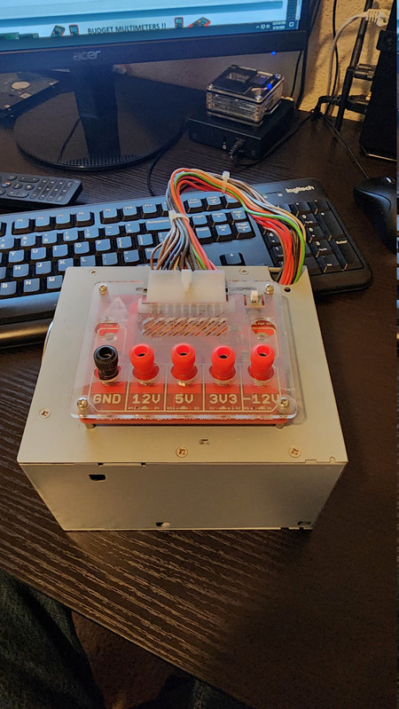

Latest project completed here at Analog Kid Laboratories, GmbH:
A replacement bench power supply from a salvaged ATX unit:
I made one from an older, larger unit (mid-1990s) but it recently up and died. Far too complex for me to diagnose and repair.
But I had this li'l PS someone had tossed out. Nice small form factor.
Unfortunately there wasn't enough room behind the "front panel" for binding posts. Sat and scratched my head, then figured I could just put on an extend-o-matic front panel for them.
The metal for the panel came from a cut-up Macbook, nice thin but strong aluminum. Mounted it on 4 long screws and nuts.
Had to cut away a bit of the sheet metal to clear the top 2 screws.
The last snag was that I hadn't figured on the fan sitting where the power switch on the left was. But that was easily solved by carving away one corner of the fan housing.
So now have a nice, powerful, stable (but fixed) bench power supply to play with.
One question, though:
Do these supplies not like being run without a load? Should I put in some small load resistors?

Depends on the circuit topology.
If it's a flyback, no load needed.
If it's a forward converter or half-bridge, yes, need a load.
"Older design" doesn't really tell us anything.
Did you take any pictures when you opened it up?  Should be able to guess the topology by the inductors (or lack thereof).

« Reply #13 on: September 28, 2026, 05:49:47 am »
@Andy Chee, I think AK was asking whether operating with no load is actually harmful to the PSU.
Yes, that's eggs-ackly what I'm asking.
I'm really not too worried about it: as I wrote, my previous ATX PS worked just fine for years running without a load (on most of the outputs).
If anyone knows differently, then hopefully they'll speak up here.
Yes.
For the aforementioned forward and half-bridge topologies, running without sufficient load may cause the output voltage to rise well above the nominal nameplate rating.
Whilst the obvious concern is with damaging the load, the high output voltage may also overstress the PSU's output capacitors (particularly cheap PSU's designed with little margin), perhaps causing them to explode.

« Reply #15 on: September 28, 2026, 08:10:40 am »
I also sometimes use such power supplies when I need high power. However, I do not recommend such a power supply for daily use with low-power loads; its high current output and lack of adjustable current limiting will only increase the risk of fires and cause more damage.
For example, if you connect a device to a 3.3V output using a 5m long AWG24 wire, during a short circuit the current will be limited to 8A by the wire itself. The power supply won't shut down, but the current will be a high enough that the wire will catch fire.
The use of fuses is not an ideal solution because fuses need to be matched to the powered device.
If it came out of a PC that's Haswell or newer, there would basically be no minimum load requirement. That became part of "Haswell ready" after the exceedingly low idle current caused some PSUs to go unstable.
