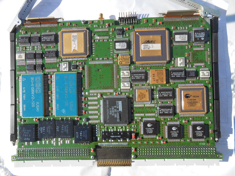

(Apologies up front: since this is a highly-integrated all-digital board, this is more of a "photo tour with part numbers" than a detailed schematic-level reverse-engineering)
Here's a nice-looking board that I've seen appear many times in different places on eBay, and finally found a good deal to buy one.  (I actually got 2 to split with a friend, so you'll see some minor inconsistencies between the photos below, depending on which of the 2 it came from.)

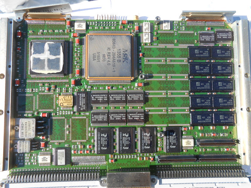

When that upside-down daughterboard in the 2nd photo is removed, we can see underneath it:
...and can take a look at the daughterboard too:
The "03640" that appears repeatedly is the CAGE code for IBM Federal Systems Division (now Lockheed-Martin), the makers of a much older series of aerospace computers used in the space shuttle and elsewhere.  This board is much newer, though: the date codes are all around 1997, which makes it roughly 30 years old.  As for the particular model, I came across a post where a particularly-knowledgeable Claude Methot tracked it down to the SP-103 single-board computer, and provided a link to an example of a later model, the SP-103B.  (The text "SP-103" also appears on the levers used to remove it from a card cage, which confirms this.)
This would be one of many boards in a "VME crate", controlling others via VMEbus.  Other VME boards in the "crate" might be specialized I/O (such as waveform digitizers or generators), or other computers.

The large chip here, with metal plates glued to it for heatsinking, turns out to be the CPU:
Removing the metal & glue (not shown here) reveals it as the Thomson-CSF TSPC603E, a 32-bit PowerPC part.  Judging by the manufacturer, a big player in military avionics, this is presumably a fairly rugged part made to work across a wider temperature range than a "commercial-grade" PowerPC CPU.

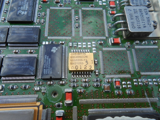

This big MS Kennedy module with the custom part number is also a mystery: it's probably a complicated hybrid module with lots of bare dies and laser-trimmed resistors inside, right?  Right?
Not quite.
It turns out to be just a footprint-adapter/interposer for a Motorola XPC106A "northbridge" chip.  The XPC106A interfaces the PowerPC's native data bus to both external memory, and a PCI bus for all the peripherals.
I strongly suspect that this (painfully expensive) custom adapter was made because of thermal expansion coefficients.  Different materials expand or shrink by different amounts as the temperature changes, and not always in a simple linear way.  This is a major consideration in the packaging of electronic components, where mismatch between the thermal expansion of a component, and the circuit board it's soldered to, creates stress in the hard (and therefore brittle) solder joint.  Repeated temperature cycling causes metal fatigue, and eventually this can crack the solder joint if something else hasn't failed first.  This is even more of an issue in military & aerospace electronics, where the components have to endure both a much wider temperature range, and larger/faster temperature changes.
The XPC106A was probably only available in this BGA package.  BGAs are more sensitive to thermal mismatches, since the mechanical & electrical connection is through many rigid balls of solder.  An array of solder balls like this has very little "give": a small strain will translate to a large stress.  So, by mounting the XPC106A BGA here to the purple ceramic substrate, the ceramic XPC106A package and its substrate have similar thermal expansion properties and will not put excessive stress on the BGA's solder balls as the temperature changes.
The connections from the ceramic substrate to the PCB are subject to much more thermal strain, as FR-4 fiberglass has very different thermal expansion characteristics than common ceramic materials.  However, this connection is through the long, thin pins that you can see soldered to the PCB.  If you know some basic Euler beam theory (or have an intuitive understanding of material behavior from experience), you'll know that these pins can bend over much larger distances than the BGA's solder balls, while creating comparatively little stress in the pins.  Therefore, this custom adapter removes excessive thermal-expansion stress that might be caused by soldering the BGA package directly to the PCB, while still putting some power-filter decoupling capacitors nice and close to it.

Now, looking at all the parts, we can see that this does look like a general-purpose single-board computer, which could've been used for any number of things:
One thing which stands out is the number of different I/O interfaces:
  • 2x dual DDC MIL-STD-1553 modules = 4x MIL-STD-1553 channels
  • 10x RS-422 transmit channels & 18x receive channels, when the daughterboard is included; some of these may be discrete signals (via the TL16C552's parallel port), while some may be serial channels (via the TL16C552's dual UART interfaces)
  • Wired Ethernet
  • Optional SCSI, through a chip which isn't populated on these boards (but was in other copies I saw for sale)
Let's go on a photo tour of the other features:

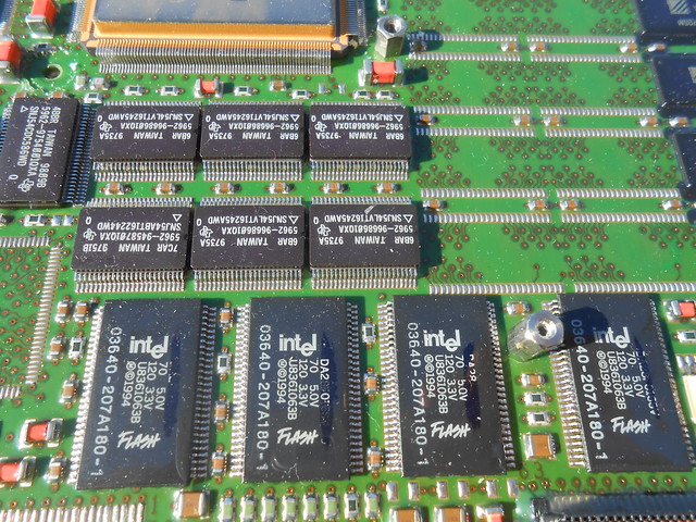

Memory
Permanent storage (4M x 16 = 2M x 32, or 8MB) comes in the form of these Intel flash chips:
Like the Ethernet controller, all of these also seem to have pen marks crossing out the 'standard' part number, and a custom IBM part number stamped on.  Again, these are probably commercial parts that have been up-screened in some way.

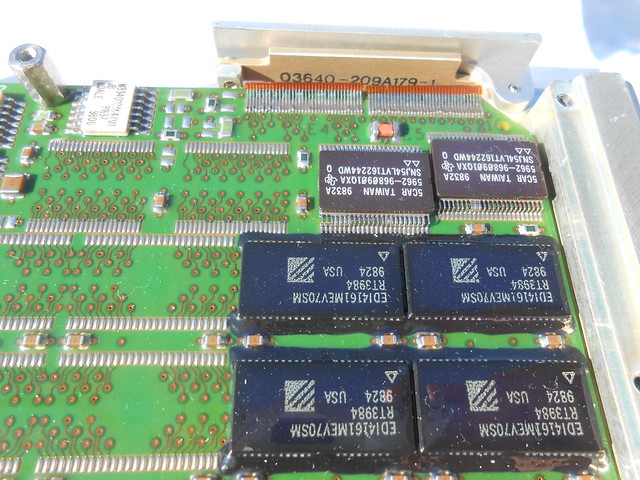

The RAM (DRAM, 10M x 16 = 5M x 32, or 20MB) lives nearby.  These parts are made by EDI (see datasheet link here), which advertises them specifically as a "ruggedized" plastic package - I don't know exactly what that involves.
Here's another view of all the wide buffer/bus-transceiver chips it takes to interface to the memory:
There's also lots of room for extra RAM:

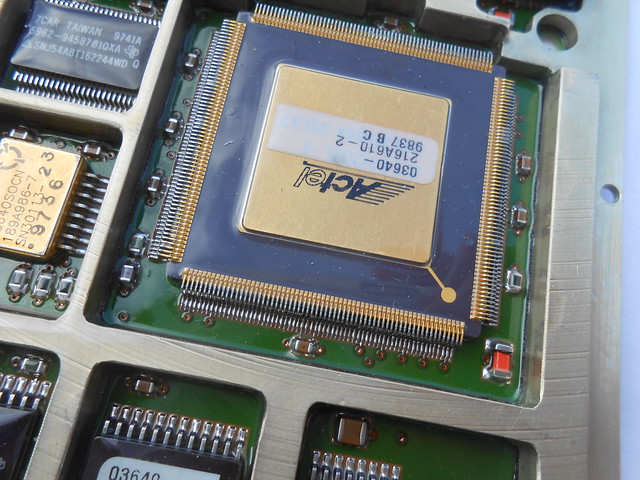

FPGAs
There are 3 Actel FPGAs: 2 near the peripherals, and 1 on the daughterboard with extra differential transceivers.
I can see 3 possibilities for how these FPGAs are used:
  • Specialized I/O peripherals for some kind of communication that uses differential transceiver channels (especially with the daughterboard)
  • Glue logic to interface the PCI bus (from the XPC106A northbridge) to the peripherals which expect more traditional address/data/read-and-write signals
  • Uncommitted, for use by the application software as hardware acceleration
Any combination of these seems plausible.  Let me know if you have ideas or additional thoughts.
