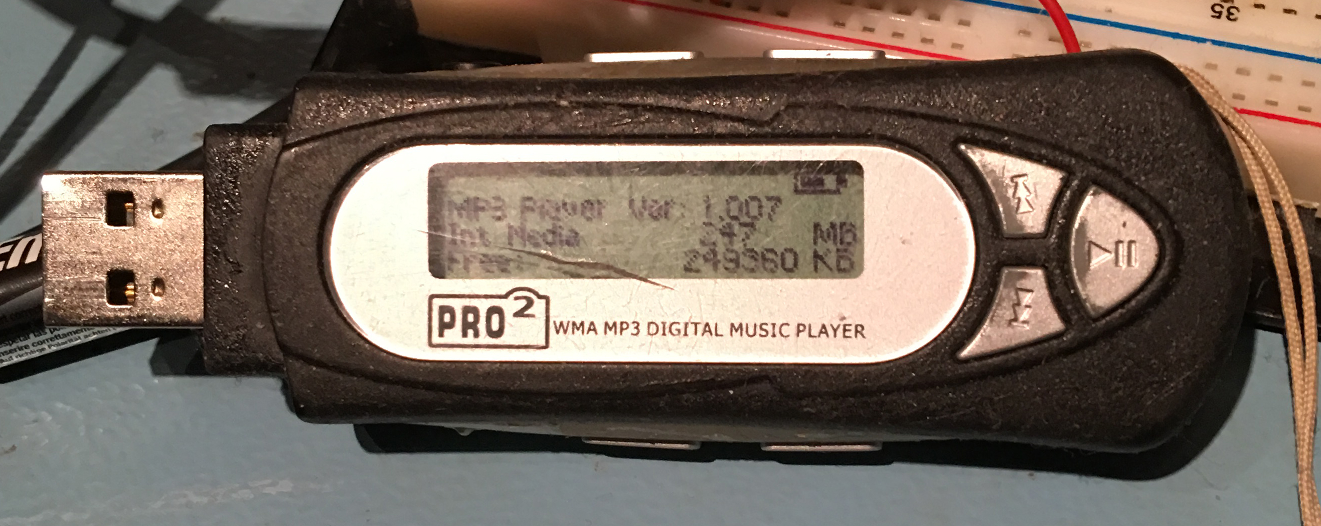

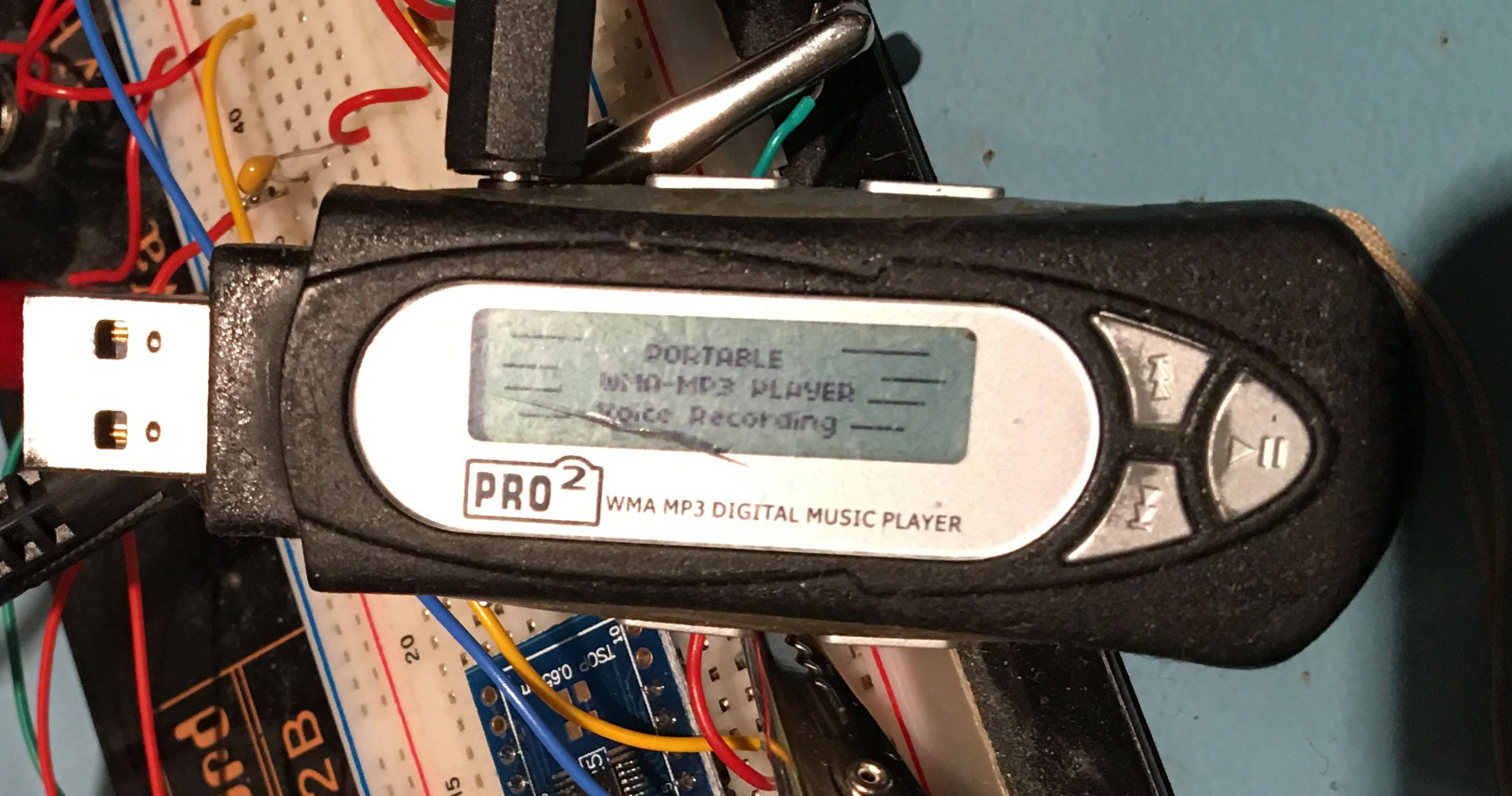

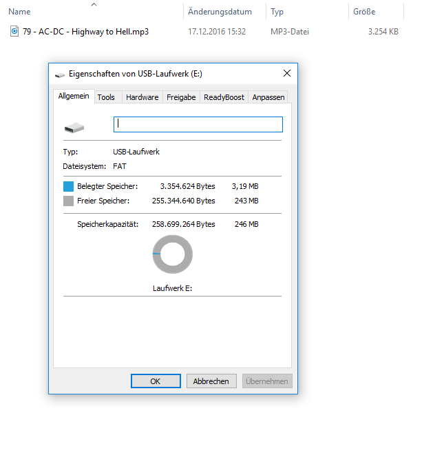

Meanwhile the first step is done, the MP3 player turned off.This is the full logging. As you can see, without Batteroo it ran 13:35 hours, pretty long. Loudness was the same all the time, as you can see in the peak value column. Cut off voltage was 1.117 V, after this the battery regenerated a bit.
High-res photos of the player with the message when I turn it on (using a different battery, I'll glued a post-it on the empty battery for the step with the Batteroo sleeve), the about dialog in the menu and screenshot how it looks like when connected to the PC with the test song:
So this is the start of the test:
Product descrption and model: PRO2 WMA MP3 digital music player, firmware version 1.007, 256 MB flash, bought around 2004
Contributor Name: Frank Buss
Battery Brand/Model Used:Energizer Alkaline Power Batterien AAA ( https://www.energizer.eu/de/product/energizer-alkaline-power/ )
Normal battery life from fresh (No Batteriser): 815 minutes
might be useful to add another column: Test procedure: Turn player on, change PlayMode to repeat track, exit menu, start playing "AC-DC - Highway to Hell", change volume to max, wait until player powers off
I'll use the exact same setup and test procedure when the Batteroo arrives. The remaining two tests shouldn't need that long  >:D

4 AAA's I tried to do some tests myself, I gave up due to Picoscope software that does not allow logging of data  |O.
I had a Picoscope many years ago, and it was possible with it. But looks like they removed the feature in later software? https://www.picotech.com/support/topic6815.html :o Maybe the Picolog software supports your Picoscope.
But they have a nice and documented API, it is easy to write some data logging program for it.
