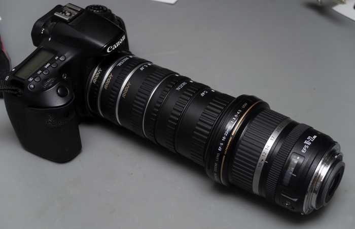

That´s a complex topic. You have to built a setup that does most of the things you have on your wish list with the amount of money you can spend.
My wish list is quite long and calls for different solutions:
  • big parts / dies
    I take my Canon 100m 2.8L Macro and take pictures with a magnifications of 1x or lower.
    For "parts" I use diffused light by putting a paper over the part and moving a CFL desktop lamp above it. Works quite well.
    For big dies I use light from behind the die to get the nice colors. I like those pictures to get an overview since pictures stacking consumes more time.
    Adjustments are done by holding the part with a third hand and bending the arm. That´s good enough for 1x and lower.
  • die - flat
    I take my reversed 10-22mm and add the tubes I need to get the right magnification: For example i take 10mm+0 for an overview and 10mm+2 for details or a big stacked picture.
    Light comes from behind and I´m quite fast with changing the magnification.
    I own a small micro manipulator for x, y and tilting over the two axes. That´s makes it easy to adjust the alignment.
    The sharpness is controlled with the focus ring.
  • die - tilted
    Side views and "3D structures" need "tilted pictures" and focus stacking. But tilted dies often give some more sharpness and details too. I don´t know why.
    I use the setup described above and vary the focus. That´s worse than moving the object because the magnification changes but I´m quite fast and moving the object needs a though construction.
    Lightning is a CFL desktop lamp. I can vary the light angle to get the best possible pictures.
  • something for inbetween  :)
    Sometimes I use my new Canon MP-E 65mm 1-5x. That´s the magnification at which my 100mm Macro isn´t good enough (with distance rings). The 10-22mm retro at it´s "lowest" configuration 22mm+0 has quite some magnification, sometimes too much. And the Canon MP-E 65mm 1-5x is really sharp (at 1-5x).  8)
    The Canon MP-E 65mm 1-5x has no focus so I have to use a macro rail. Since I have only a cheap one it´s not possible to mount the camera on the rail: The rail moves sideways a little while moving forward and the mirror movement makes the picture blurred. Mounting the lens on the rail is bad and mounting the camera is bad also. Because of that I place the die on the rail (with my third hand). That looks strange but guarantees sufficient image quality.
My whole setup is placed on a esd pad. That seems to be a perfect support. The parts stick a little on the surface. The pad is hard enough that the parts don´t sink into the pad but does a little damping.
A change in my setup has to improve the already good quality. It has to fit into the rest and it must not slow down the process. That´s no easy task.  :-/O
I´m afraid changing something makes me change a lot and would consume a lot of money. And for some problems I still have no solution. For example the light through/from the lens with a vertical setup. Of course I can built something like magic but I´m afraid such a modification makes the new setup worse than the old one...
« Last Edit: July 25, 2021, 08:39:52 pm by Noopy »

Offline NoopyTopic starter
  • Posts: 2239
    • Richis-Lab
Re: Decapping and Chip-Documentation - Howto
« Reply #115 on: July 26, 2021, 03:33:49 am »
magic, mawyatt I highly appreciate your knowledge and experiences!  :-+
It´s a complex topic and the solution can be different for different requirements.
I like my setup but getting better is always a good thing.  8)
Shadows of all the vertical steps on the surface, perhaps?
Colors also change so sometimes it could be down to that.
I´m not sure... ...it´s different, sometimes better.
The 3D effect helps but it seems like it´s a little sharper too.
Your images and techniques are fine, producing nice images without much addition effort :-+
Don't want to imply anything else, the equipment and technique I mentioned were just as information that you might find useful.
Your use of the stacked lenses (100mm and 10-22mm) is an excellent way to get around some of the diffraction limits imposed, see details over at PM, lots of  discussions on this stacked lens topic.
I appreciate your hints!  :-+
But I don´t  use stacked lenses. I just use reversed lenses, mostly the 10-22mm.
Works fine!  :-+
One of the more difficult chip related things to image we discovered a number of years ago is new chip solder balls.
Yeah, solder balls are wierd.  :-/O
  • Posts: 2239
    • Richis-Lab
« Reply #124 on: July 26, 2021, 07:14:33 pm »
It does look sharper indeed. It could be due to hard shadows, or I'm not sure what else. I presume it's the same optics, subject distance and magnification in each case?
At any rate, I applied some fake sharpness and contrast to it. I don't know if it's better, but it's different ;D
Yes, it was the same optics, the same subject distance and magnification. I just tilted the die a bit and adjusted the light.
It´s annoying not to know what is happening but I´m happy to have a second possibility to get nice pictures. ...better than some fake sharpness and contrast.  ;)
I have already bought an adapter to test stacked lenses. I wanted to try that earlier but somehow forgot about it.
I have quite some lenses here. First I will try 100mm + 10-22mm. Better or worse I will drink a beer afterwards.  ;D
It´s a pity I´m no optics expert...  :-// ::) But I highly regards your advices!  :-+
