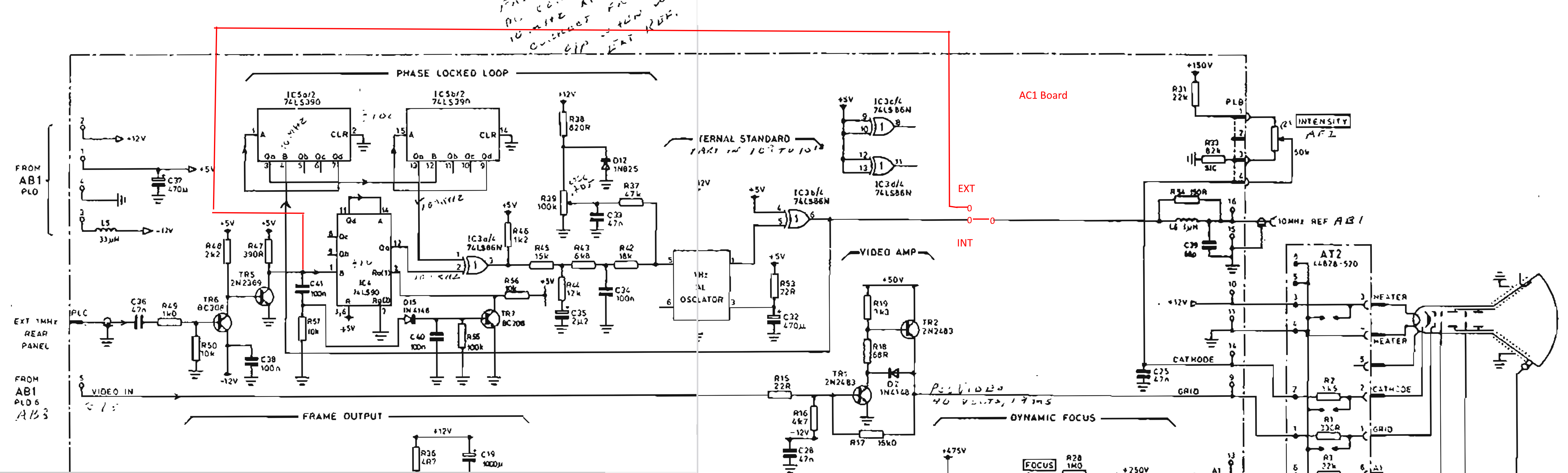

Hi folks , I have a marconi 2995a coms test set , It has a bnc port for a 1 Mhz freq ref input , I also have a 10Mhz gpsdo , i need to divide the gpsdo 10 Mhz outut  down to 1 Mhz to feed the 1Mhz ref freq input on the marconi , Can anyone recomend a schematic of something i can homebrew for this?.
tl;dr
my solution is a piece of wire + switch
since that analyzer is anyway running at internal 10MHz
Yes, I think there is a much simpler solution. With a negative parts count (minus one) :)
The schematic is not very clear. But I think the external 1MHz is fed into a PLL, which synchronises the internal 10MHz oscillator.
The 1MHz input is divided by 10, the internal 10MHz is divided by 100 into the PLL.
So skip one divide by 10 stage (74LS390), so both ext input and oscillator will be divided by 10, and the Ext 1Mhz input has become an Ext 10Mhz input. :).
OK, only half a part is saved, we still need the other half 74LS390.....
Alternatively, one could add a half 74LS390 (divide by 10) in the 1MHz path, so both are divided by 100. Less elegant, but might be easier on the PLL. Result is the same: the 1MHz input becomes a 10MHz Ext Ref input. :)

If I understand that correctly I think the loop filter components would have to also be changed to suit the factor of 10 change in division ration in the OCXO part of the loop.
When the thread started I assumed the solution would be something like a simple squarer circuit (in case the GPSDO output is a sine wave at 50R) followed by a '390 based divide by 5 plus divide by 2 to get the divide by 10 overall. The Marconi 2955 isn't exactly high end test gear, from a technical point of view it's barely mid range so I don't think this external divide by 10 needs to have state of the art performance levels. The divider noise floor of its internal LS390 chips will probably dictate the close in phase noise of the internal OCXO when it is disciplined externally via its internal PLL circuit.
I don't think the loop filter would need adaption.
Avoiding that discussion, when choosing the solution to add an extra divide by 10 divider to the 1MHz input, nothing changes for the PLL.
regards, Gertjan.

From the Marconi 2955 schematic above, the EXT 1MHz input is AC-coupled to a two transistor pre-amp, then to a 'LS90 I think configured as a "Symmetrical Bi-quinary Divide-By-Ten Counter". So I believe it corrects the duty cycle.
The 10MHz reference osc is div/100 for the PLL using two stages of 'LS390 forming the VCO control voltage. The PLL is 100 kHz.

As posted before, you can either bypass the complete internal PLL and feed the communication test set direct with 10MHz, since it runs internally already with 10MHz.
Or you insert an additional 1:10 divider behind the 1st 74390. 7490 works also sufficient with 10MHz - Yaesu did that with their Ham-frequency counter YC500 40yrs ago. (p 11 in SM shows the optional 10MHz TCXO, which is divided by 10 to meet Counters internal reference of 1Mhz. Birds view for simple wiring included  :))

Well there have been lots of methods suggested...
IMO the method in post #31 using just a switch has some downsides:
If the external GPSDO gets turned off or disconnected then the 2955 will have no reference when set to external mode.
If the external GPSDO has worse phase noise (including spurious terms) than the internal OCXO then this may impact the noise performance of the 2955. This might or might not matter to the OP.
Doing it with an external /10 as originally requested is a low risk way to do it but it does mean making something to go in a suitable box and it will also need a DC supply voltage from somewhere. So this is far from a perfect solution.
The second method suggested by Gertjan where an additional \10 is added internally might be the most suitable as long as you don't ever expect to have any other test gear that also requires an external 1 MHz (or 2 MHz or 5 MHz) reference. In this case an external box with the ability to configure for multiple 1 MHz or 2 MHz or 5 MHz outputs might be worth making.
If it helps, I think the internal 10 MHz OCXO may be similar to the one used in a Marconi 2018/19 signal generator. These OCXOs are usually housed in a grey plastic box about the size of a matchbox. I've got some of these here and the close in phase noise of the 10 MHz OCXO is fairly good and is typically something like:
-112 dBc/Hz at 10 Hz offset
-130 dBc/Hz at 100 Hz offset
-145 dBc/Hz at 1 kHz offset
-150 dBc/Hz at 5 kHz offset
Some GPSDO 10 MHz outputs will be cleaner than this and some won't. However, if you stick with the original external divide by 10 or with Gertjan's second method with the \10 fitted internally, it won't matter much if the external GPSDO phase noise is a bit worse than the internal OCXO. This is because it is used to discipline the internal OCXO.
The other option is the 'do nothing' option and simply use the GPSDO to calibrate/adjust the internal OCXO once or twice a year and always run the 2955 from its internal OCXO.
