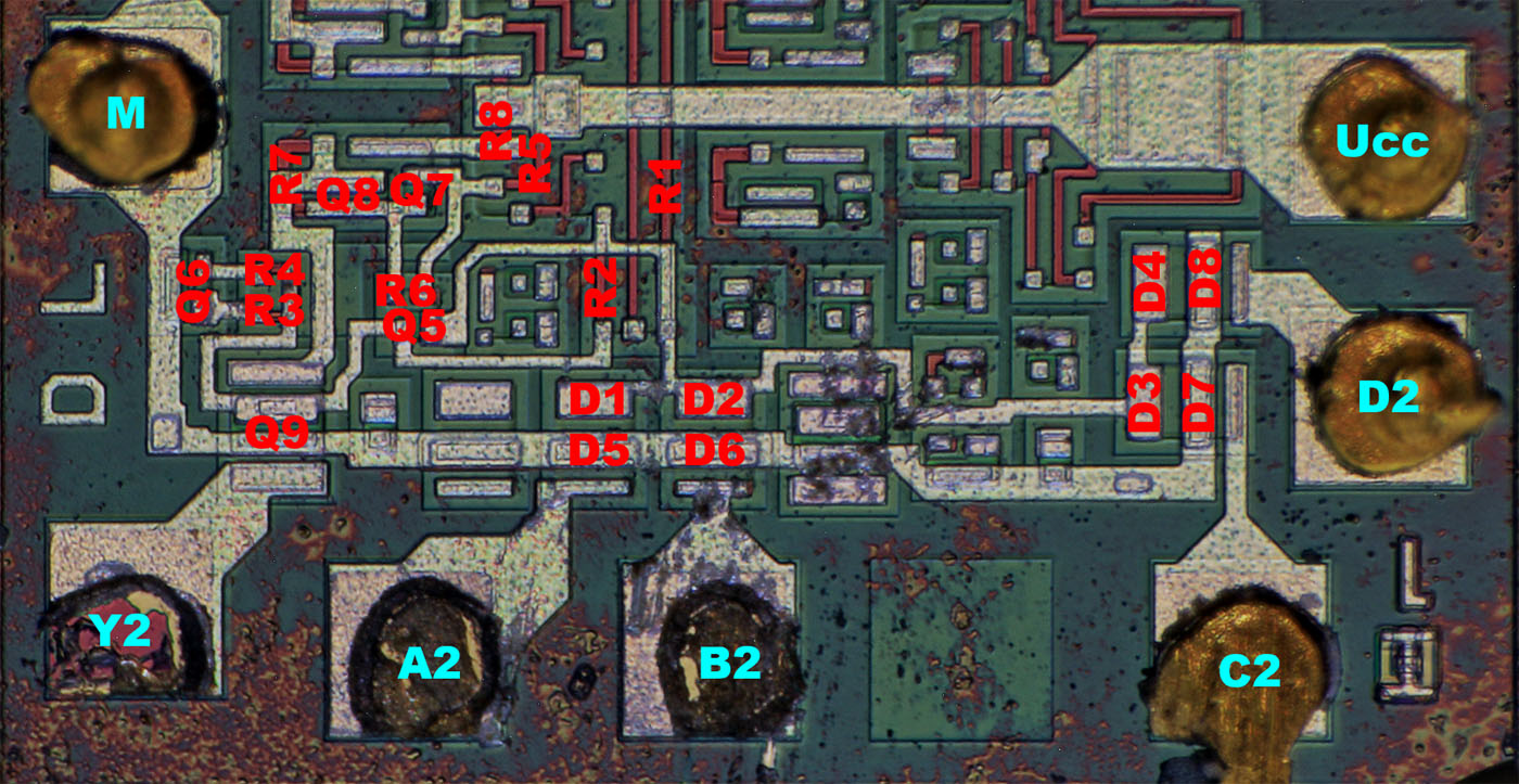

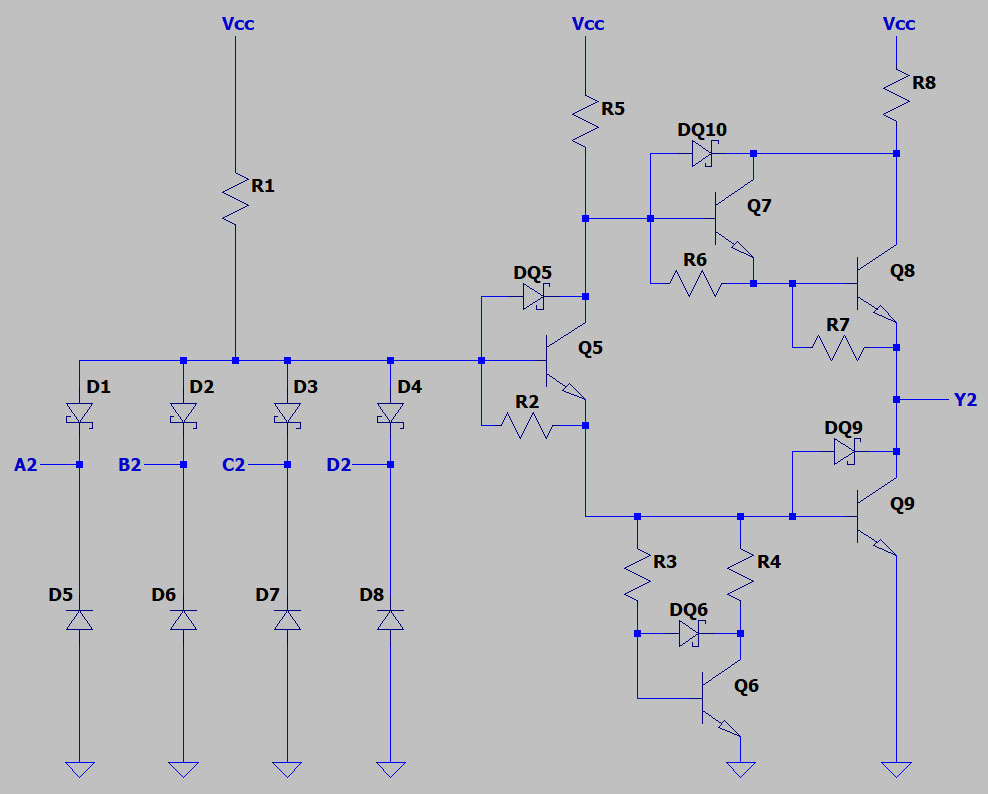

Here we see the DL020 we already had. It contains two 4-Input NAND gates.
And here we have the additional Base-Emitter-resistor that isn´t shown in the schematic in the Radio Fernsehen Elektronik. It seems like they tried to speed up Q5 (VT1) a little.
