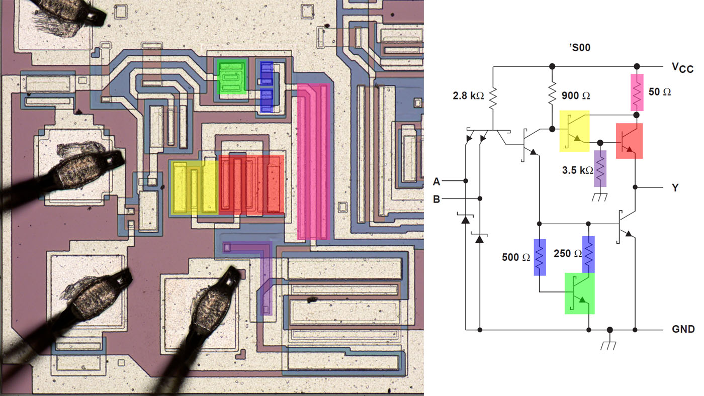

SNJ54S38, the Schottky-Variante des 5438 and of course the MIL variant.  8)
The dimensions of the die are 1,2mm x 1,1mm. Texas Instruments usually integrates a Ti logo. Here there is no such logo. The character sequence S38 refers to the 54S38 variant. As will be shown shortly, another variant can also be build on this die. The letter A could stand for a first revision.
The structures are still quite clear.
The base contacts of the transistors contact both the base and collector areas. A Schottky contact is created between the metal layer and the weaker n-doping of the collector, which makes the transistor a Schottky transistor. Such a transistor does not saturate and can therefore be switched off more quickly.
The individual elements of the circuit can be easily identified.
Three transistors and three resistors are not included in the circuit. These additional components can be used as an alternative to the 54S00. The 54S00 also contains four NAND gates, each with two inputs, but has a push-pull output.
It is noticeable that the resistance values in the datasheets of the 54S38 and the 54S00 are significantly different. This may be due to the fact that the datasheets describe different generations. If the specifications of the transistors change when switching to a different process, the resistors must also be adjusted. In addition, the exact resistance values are hardly relevant for the user and are subject to large tolerances. Accordingly, the datasheets indicate that these are only nominal values.
https://www.richis-lab.de/logic44.htm

A minor correction:
The 54S38 contains four NAND gates with two inputs each and powerfull open collector outputs (they are buffers).
Because of that the related 54 variant is not the 54S00 (weak output) but the 54S37 (buffer output)!
Now the resistor values are more similar too.  ;D
