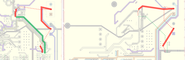

The return path of the ADC is as shown below. The ground of the input opamp runs to the second layer via vias and then underneath the ADC IC.
This is what I see for the ADC SPI shortest path. It's very hard to tell where is that loop going to couple, especially if you have similar ones that might not even be obvious.
I forgot to say it in my previous post, that really cool application tho.
Haha funny picture. So how would a continues ground plane make that loop any different? If the ground plain was continues, i.e. I didn't have those ground splits in there, that loop would still exist. I am also confused as to why the digital ground would take that route because the digital ground is not connected to that ground pour?  This raises another question. What difference does splitting ground planes make if analog and digital ground pins of the IC are connected internally?
I have attached a closer picture of the ADC, The red line shows the digital ground pin is not connected to the analog ground pins at all. However I do realize that this doesn't matter if they are internally connected |O if they are connected internally how is it possible to prevent the SPI return current from coupling with the ADC analog current then?
The answer is that you separate out the return current paths.  A split/single-point-connected ground plane is kind of a shortcut way of enforcing this, but only really works on eval boards with one mixed signal IC, limited supporting circuitry, and limited external connections.  In the context of a more complex design, it falls onto the designer to ensure that return currents are properly directed, regardless of how the ground plane is laid out.  A big part of this is placement (in fact, good layout in general is 90% about good placement), so making sure you have a good idea of what kinds of currents will flow in/out/between each block of circuitry and place them accordingly is a good start.  From there, consider the loop paths between blocks, and make sure you route accordingly, including maintaining a solid ground plane as much as possible.
There are multiple loops to be concerned with here.  This starts with the power supply input, which is a loop unto itself between your input capacitors (I don't see any on your board, btw) and the external power source.  From there you have a loop between the bulk capacitors on the board to the local decoupling caps.  Then you have the loops formed by decoupling caps with the ICs they serve, these want to be as tight as possible to provide maximum stability of the local power supply, and they are the foundation of the next set of loops, which include the signal tracks between ICs.  Consider that when your MCU is clocking the SPI line to the ADC, on every clock transition the MCU delivers a pulse of current into the clock line.  The energy for that pulse comes from a local decoupling cap at the MCU, delivered through the MCU's output stage into the clock line, into the ADC, and is returned through the ADC's ground pins, through the ground plane, back to the MCU decoupling capacitor.  High frequency return currents will be concentrated in the path of lowest inductance.  When a signal track is routed over a continuous, unbroken ground plane, the lowest inductance return path is through the ground plane directly underneath of the track.  This is why a continuous ground plane is generally ideal, because return path inductance is minimized (as is the DC path resistance by virtue of there being as much copper as possible).  In terms of 'high frequency', remember that with digital signals it's not the transition frequency but the transition rate (slew rate, dV/dt) that determines the highest frequency of concern.  This is why you don't want to route tracks across a break in the ground plane, because it forces those return currents to detour through a higher inductance path around the break to get where they need to go.  This is also what makes the old advice to only have one point of connection between analog and digital grounds tricky--in order for that to work properly, any signal that crosses the digital/analog boundary has to do so at that single point.  Having a single contiguous plane is often a more realistic path to acceptable results.
Even if your design would benefit from a split ground plane strategy, that would likely only come into play after you've dealt with other things that will have a much more significant effect on your precision: power supplies, input filtering (power and signal), DAC/ADC reference quality, error terms in your analog components, etc.  No amount of fancy ground plane shenanigans will make up for deficiencies in those areas, but they will all benefit from a good ground plane.
In any case, aside from the fundamental question of whether or not you should split your ground planes, your ground planes are far too fractured by signal tracks to really be of any benefit here.  You have a number of islands, and near-islands in the ground pours as things stand now.  You could probably get a reasonably contiguous plane with two layers on this design, but it will take much more careful routing and you'll still likely need to stitch top and bottom pours together with vias.  In general, I suggest moving a lot of your longer tracks to the top layer, and rather than moving whole tracks to the bottom layer, use short bottom-side tracks to allow signals on the top layer to cross.  The small hole created in the ground plane by a short jumper track is far less harmful than a big slot created by a longer track.  Where you must have longer tracks on the bottom, avoid having top side tracks cross over them.  If that can't be avoided, use a top side pour and stitch it to the bottom pour, such that the top and bottom pours add up to a more-or-less uninterrupted plane.
MY bad, I missed the separate ground pin of the ADC. I didn't mean to confuse you, but it still doesn't help the loop.

As previously mentioned in the thread you admitted you didn't read, and covered extensively in the very good video Doctorandus_P shared.... High frequency return currents (above audio frequencies) are concentrated in the path of least inductance.  With a track over a solid ground plane, the return currents take the same path as the track except through the ground plane, because that's the path that encloses the smallest loop area.  At best, splitting the ground plane is not effective for controlling high frequency return currents, because with a solid plane they already take the optimal (least impedance) path available.  At worst, splitting the ground plane can cause serious problem with EMI, SI, and basic function by forcing HF return currents to flow around--or even couple across--the gap in the plane, increasing inductance, and spreading fields out further across the board and beyond where they can impact more signals.  As you note, signals should be routed across the junction point to avoid this, but that also forces the signal and its return current closer to the sensitive ADC/DAC--or you have to make that junction area larger, stretching the definition of "single point", to preserve signal separation without tracks spanning the split.  So, bottom line, split planes can work, but they're not going to be better than a single solid plane for high frequencies, and will cause more harm than good if not done exactly correctly.
Splits/Slots can be effective at controlling lower frequency return currents (in the audio range down to DC), but that's only relevant if you have enough current in those lower frequency ranges to cause meaningful voltages across the DCR of the return path.  "Meaningful" of course depends on the sensitivity of the circuitry involved as well as the magnitude of the currents concerned.
