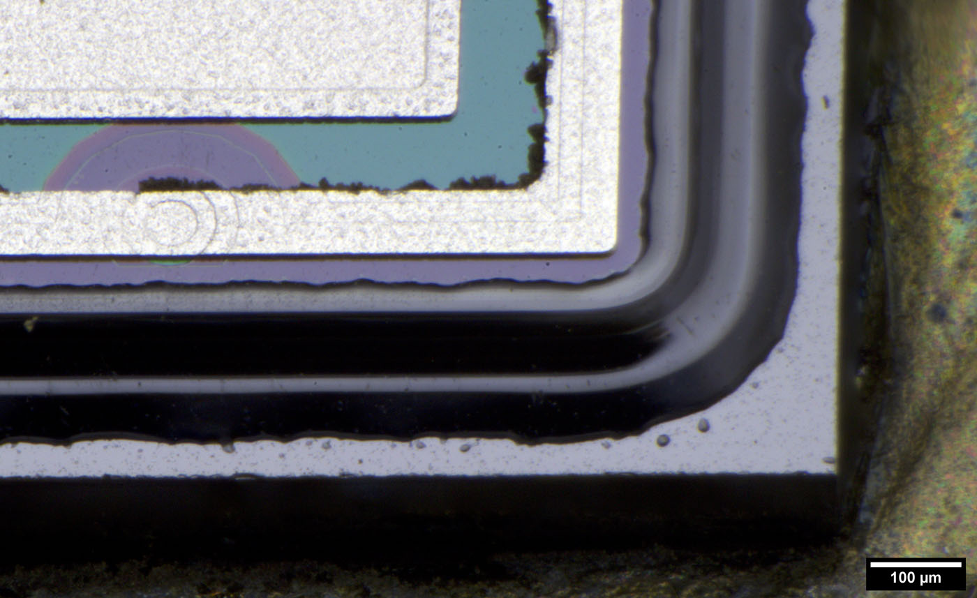

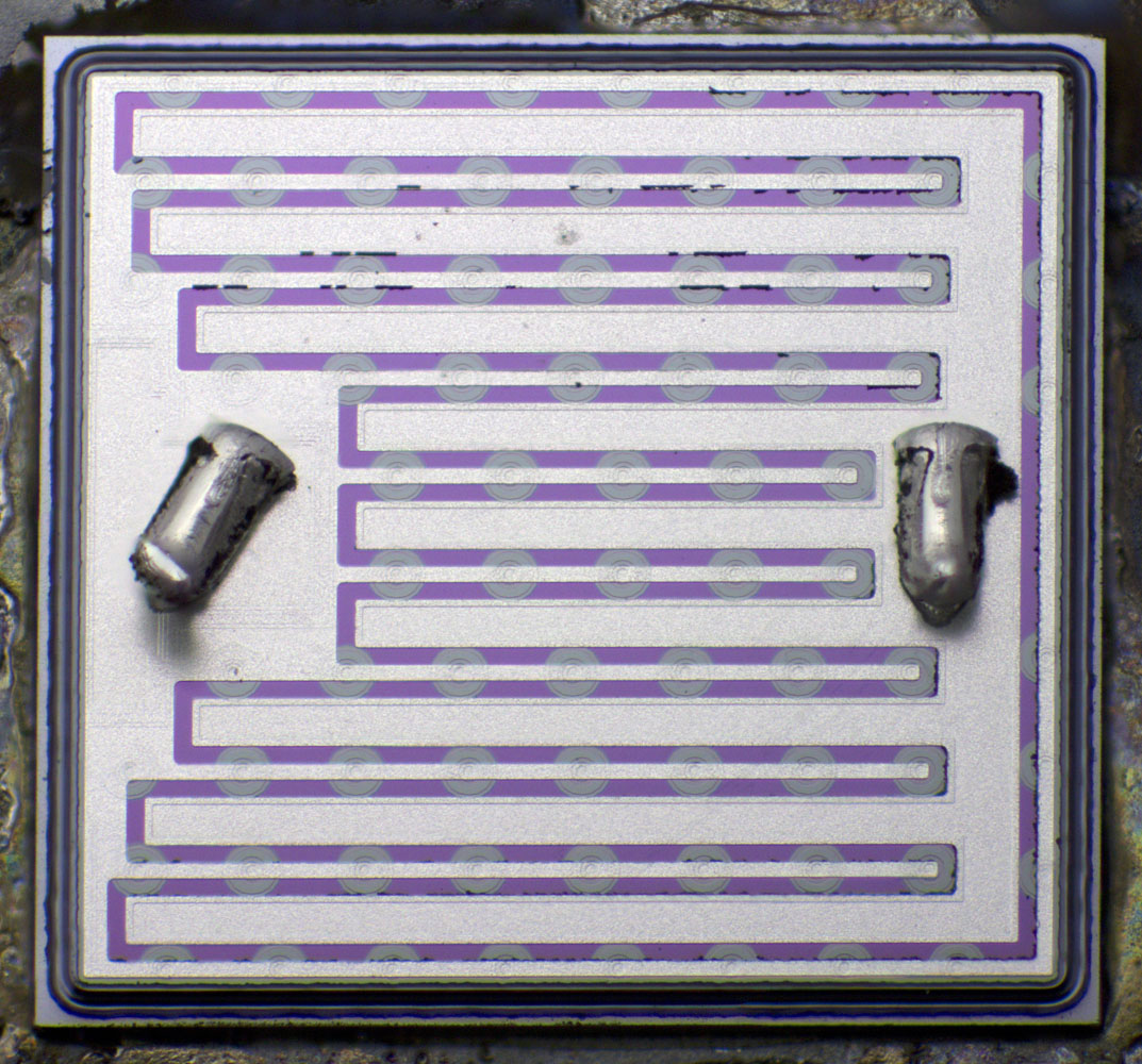

Today I have a MJL21193 for you (250V/16A/30A):
The package has notches to increase the creepage distance.
The die is quite big: 3,64mm x 3,54mm
It´s a perforated Emitter MESA-Transistor just like the new BUX22 (https://www.richis-lab.de/Bipolar08.htm)

I wonder what is the biggest bjt (in terms of die area) ever produced?
Offline NoopyTopic starter
  • Posts: 2401
    • Richis-Lab
« Reply #130 on: July 23, 2020, 11:47:39 am »
I have a halfbridge brick sitting here (KD324510). The dies in there are much bigger. Could be something around factor three. I will take some pictures!  ;D
Offline capt bullshot
  • Posts: 3033
« Reply #131 on: July 23, 2020, 01:09:35 pm »
It's not a BJT anyway, I've seen IGBT dice of 11mm * 16mm and larger. You'd find them in modules like this one:
Also have a few BJT modules, but their potting is pitch black, so one can't see the dice.
