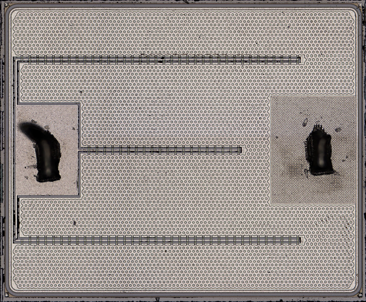

« Reply #950 on: December 28, 2025, 04:17:55 am »
The BUZ100 is an n-channel power MOSFET. There is no datasheet available for the BUZ100T in the D2PAK package. The old TO220 variant blocks up to 50V and conducts up to 60A with a resistance of 18mΩ. This transistor family was developed by Siemens, hence the name SIPMOS (Siemens Power MOS). The above model was already produced by Infineon.
The edge length of the transistor is 4,5mm. The large source metal area was connected with two bondwires. A bondwire with a thinner cross-section was used for the gate potential. The bright rectangle in the upper left corner is obviously a contact area that could be used to connect an auxiliary source contact.
The metal layer contains round contacts with a diameter of approximately 10µm.
In the “SIPMOS Components Data Book 1987/88,” Siemens shows the structure of SIPMOS transistors. I have colored the drawing for a better understanding. The openings to the substrate and thus also the recesses in the metal layer are squares. This has either changed over time or was deliberately not depicted entirely correctly.

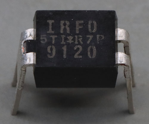

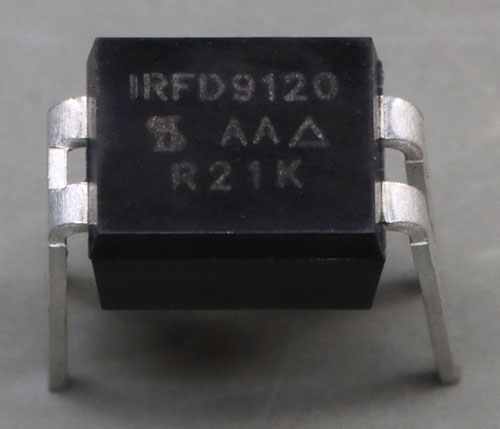

The Siliconix IRFD9120 is a p-channel power MOSFET in a DIP-4 package. The IRFD9120 blocks up to 100V. The current carrying capacity is 1A continuously and 8A peak. The typical resistance is in the range of 0,6Ω. At room temperature 1W can be dissipated. The datasheet also specifies an IRFD9123 with slightly poorer characteristics (60V, 0,8A, 6,4A, 0,8Ω). These are probably two different grades.
As will become apparent shortly, this is most likely a counterfeit component. It is not immediately apparent from its appearance.

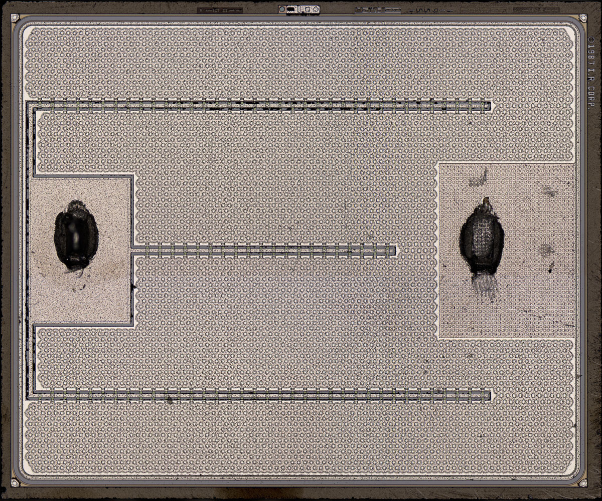

The package contains a die measuring 2,8mm x 2,3mm. The gate potential is distributed across the surface via three low-resistance stub lines.

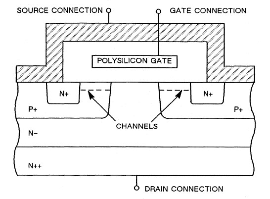

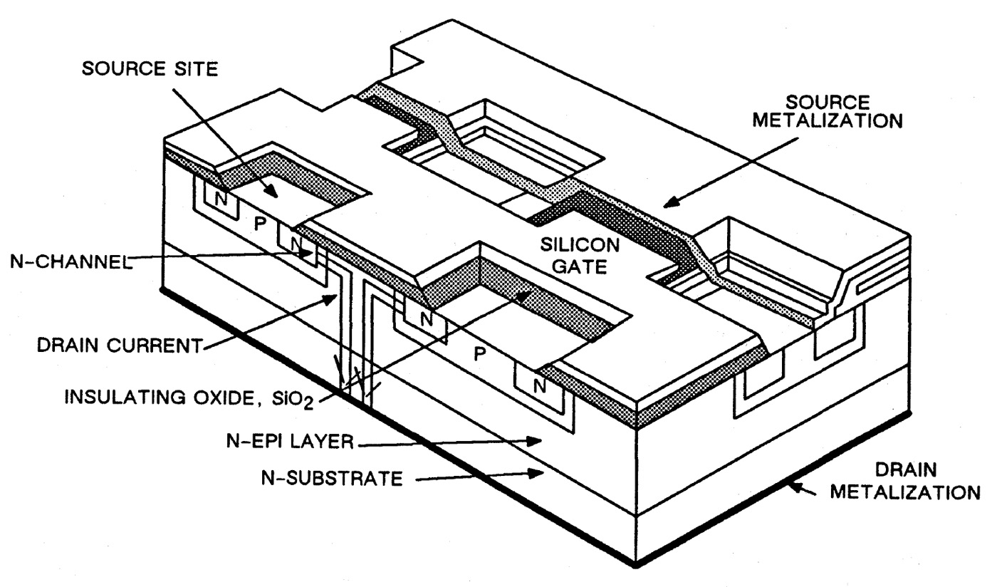

The Siliconix IRFD9120 is a so-called MOSPOWER transistor. In the MOSPOWER Databook, Siliconix shows the typical structure of such a MOSFET, whereby the illustration shows an n-channel MOSFET.
The MOSPOWER Databook also contains the above illustration. The rectangular contacts are clearly visible. The rectangles are formed in the metal layer of these transistors: IRF640 (https://www.richis-lab.de/FET08.htm), IRFD120 (https://www.richis-lab.de/HDD_Seagate_ST-177I.htm#IRFD120), IRFD9020 (https://www.richis-lab.de/HDD_Seagate_ST-177I.htm#IRFD9020).

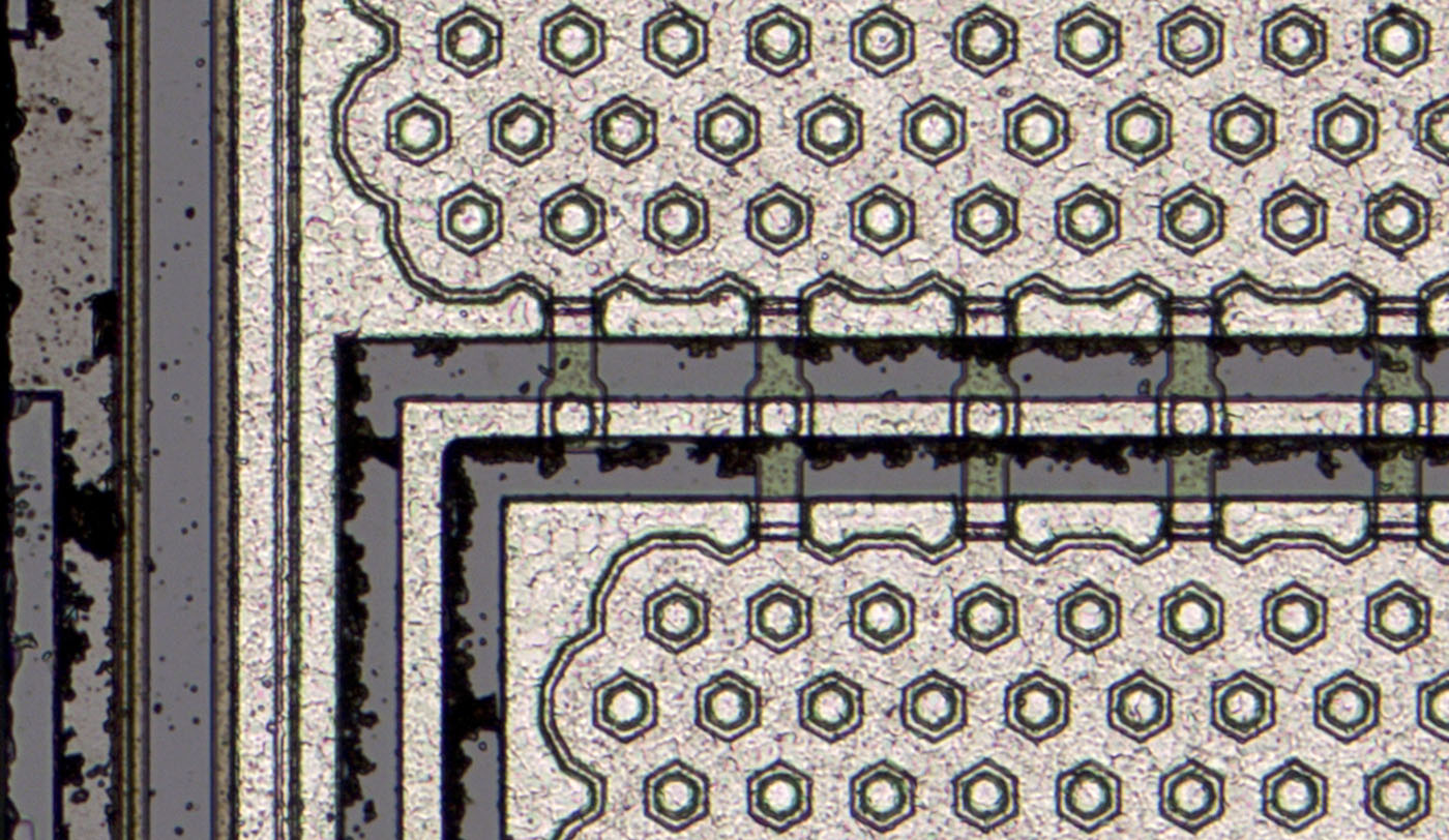

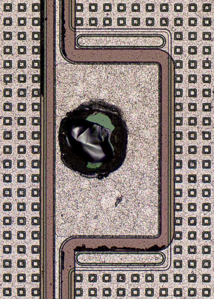

The contacts in the metal layer of the IRFD9120, on the other hand, are round, each surrounded by a hexagonal structure. This must be a third-generation International Rectifier HEXFET. Its design is documented in more detail in the IRC540 (IRCZ34) (https://www.richis-lab.de/FET39.htm). It appears that a MOSFET from International Rectifier has been converted into a Siliconix MOSFET.

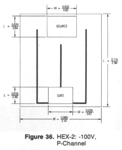

The “HEXFET Power MOSFET Designer's Manual” from International Rectifier reveals that it is probably the size HEX-2.

Now International Rectifier IRFD9120.
Yes, that´s a third generation HEXFET.  :-+

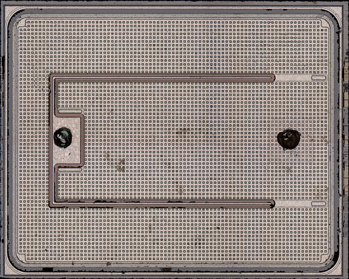

And another IRFD9120! This one is from Motorola.

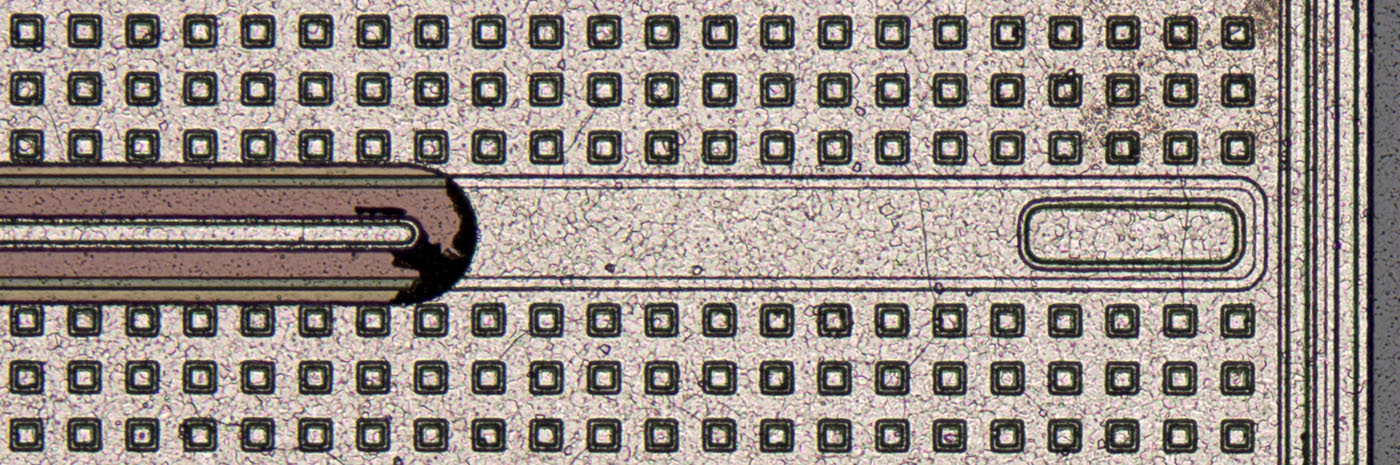

The dimensions of the die are 3,0mm x 2,4mm. Motorola used a technology called TMOS. The structures shown in the datasheet are the same as those documented by Siliconix for its MOSPOWER transistors.
There are unusual structures directly in the bond area of the gate potential and at the end of the gate stub lines. These appear to be contacts from the source metal layer to the gate potential. Direct contacts won´t make sense. In addition, the structures have one more edge than the stub lines of the gate potential. The most likely explanation is that these are protection zener diodes. However, the datasheet does not mention any protective diodes.
