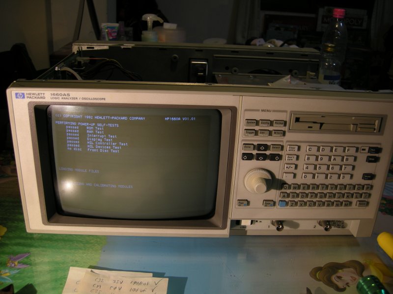

Never mind about the T3 transformer, I managed to test it on top of another transformer, and it was OK.
Today I followed up on an idea to check the -5.2V rail which is -0.01V (voltages are listed in first post) based on the assumption there is a short somewhere, and that causes the rest of the voltages to drop to half as well.
So without mains connected, I just measured resistance at the 20 pin output power connector on the PSU, and started to see a pattern where voltage output pins had a few k ohm resistance when measured against ground except -5.2V which was a dead short. With this in mind I started to desolder everything in the trace path from that -V5.2 pin (ignoring the schematics), regulation control board, transistors, electrolytic capacitors, regulators, T3 transformer (was out already), and so on, after removing each I checked for the short between -5.2V and ground pin, and the short was there even when the whole path was pretty much empty except for a few passives. Then I noticed that one of the pads for C19 (previously replaced capacitor) on the top side of the board was a bit dark from cap leakage, so I cleaned it up with rubbing alcohol and it became visible that the pad was isolated (circle shaped border) within another broad trace, measured again and now it was ~200k ohm between -5.2V pin and ground!
After that I soldered everything back, checking resistance between -5.2V and ground just to be sure the problem wasn't back. I powered on the PSU with an incandescent flash bulb in series with mains just in case (as recommended by George), measured +5V at the external control point and the rest of the voltages were OK.
:phew:
Two weeks of repair finally over, learned a lot about power supplies in the process. Thanks for the help Toasty.

An update; had another problem with the same power supply (SMPS). The HP 1660AS scope/LA kept powering off sporadically, sometimes refusing to power on as well.
This time it was CR16, CR18, CR19, CR20 and CR21 zener diodes leaking too much current into the gate of A2 (C122F1) which is a reverse blocking thyristor in a "crowbar" configuration this resulted in reduced voltage on most rails except a few while A2 happily shorted 15.5V (VREF) rail to ground, also rendering A6 (LM339) useless with Vcc at 0.7V (it requires >3V).
What I did to fix this was lowering the resistance between A2 gate pin and ground from original 22 Ohm (R43) to 7 Ohm by adding another resistor between the cathode (ground) pin and gate pin of A2. Check the reversed schematics page 7 linked previously in this thread to understand what is going on.
